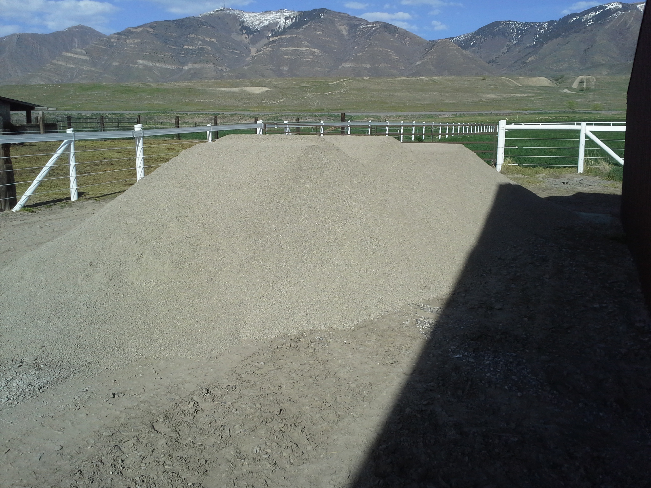

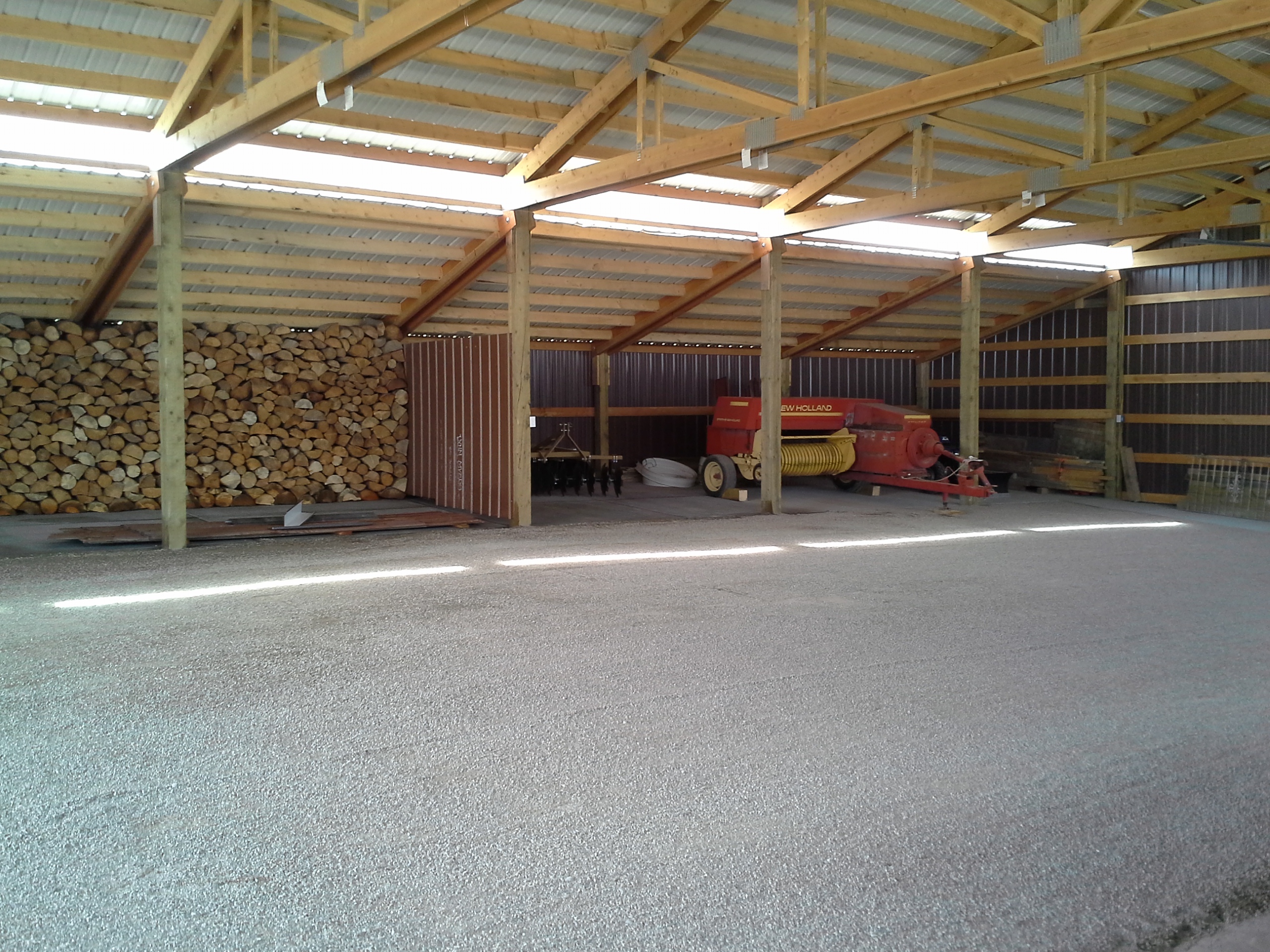

When I was spreading my floor in the barn; (crusher fines) I put my LP disk on the 3 point. What a difference it made. I'll try a different TSC, I know they have the adapter because so many on this forum have said so. I do want to load my tires; still fighting the cheap side of myself though.:laughing:
Having loaded tires over having the disk on would have made spreading so much better/easier.
