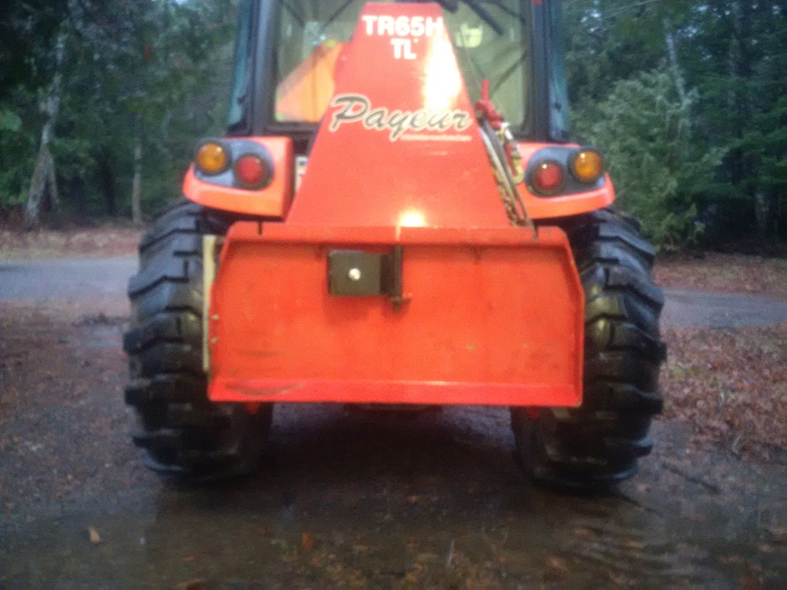

Had tires loaded this week, he said it was beat juice but mixed with something so it doesn't get to thick in the colder weather. He called it agralime or something? I'm pretty sure they are using vodka to thin it down.
This added somewhere between 800 to 900 lbs:)

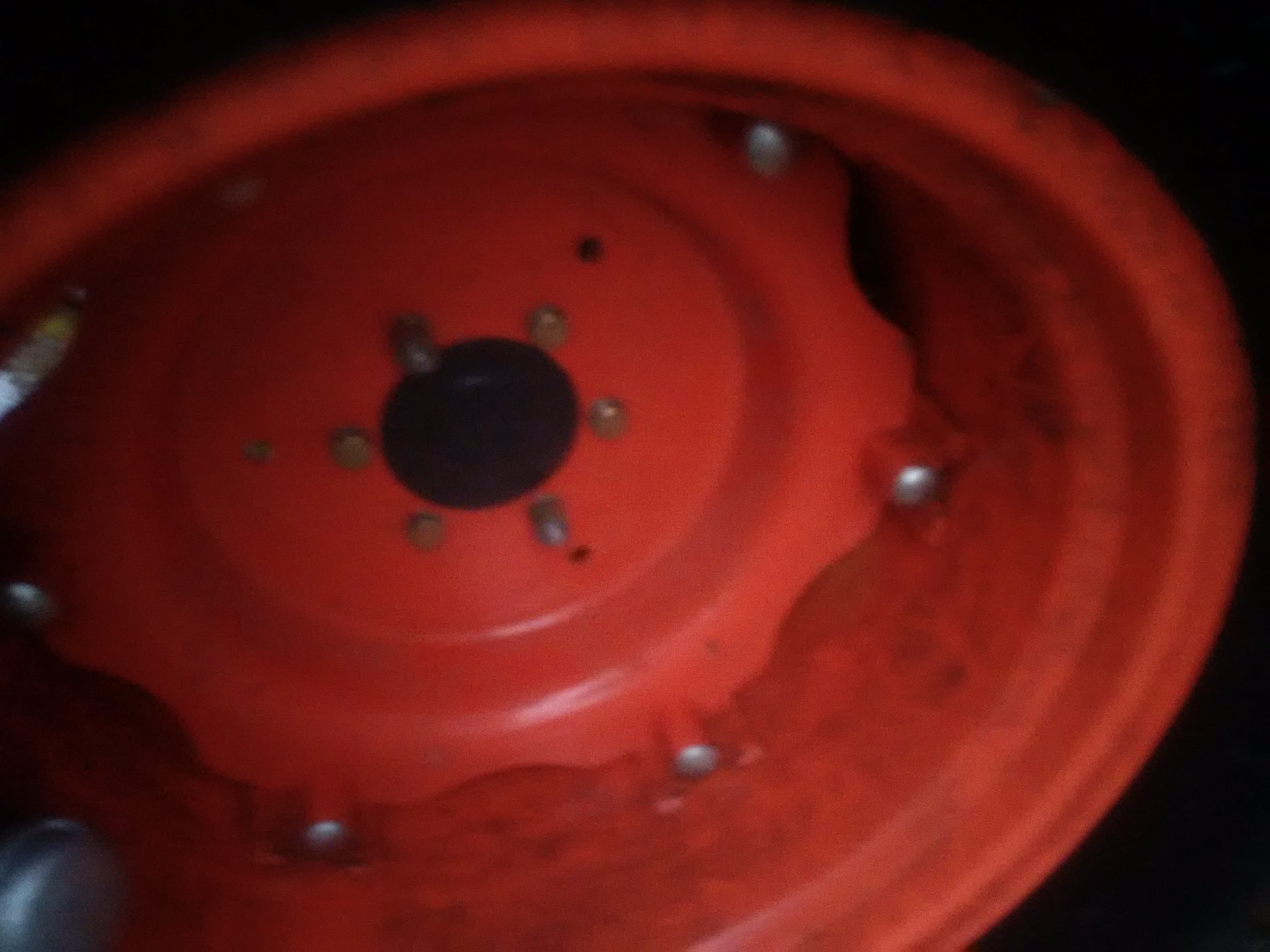

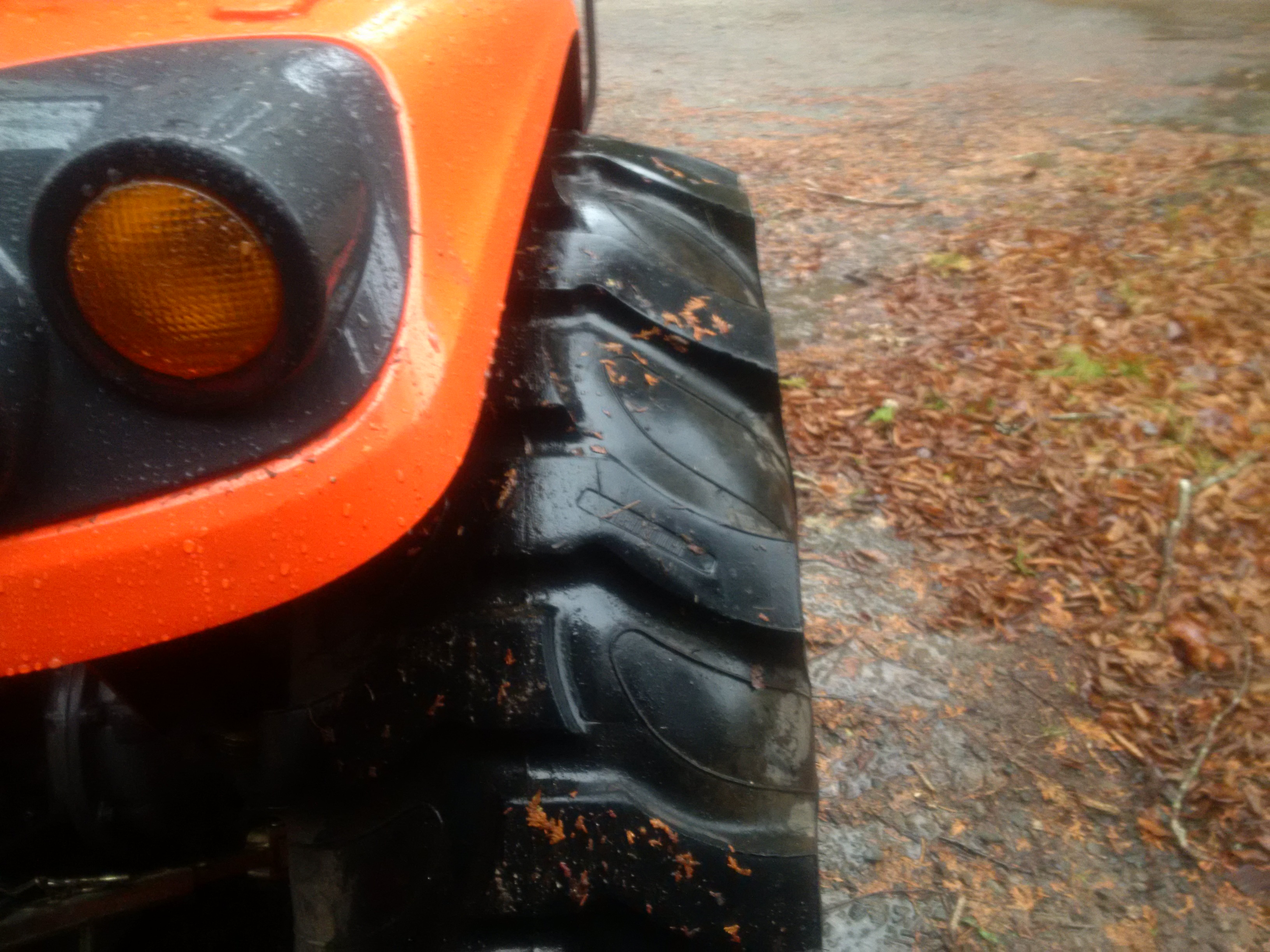

While doing this I flipped the rims and gained probably 8 to 10" in width. I didn't measure before but I really like the extra width.

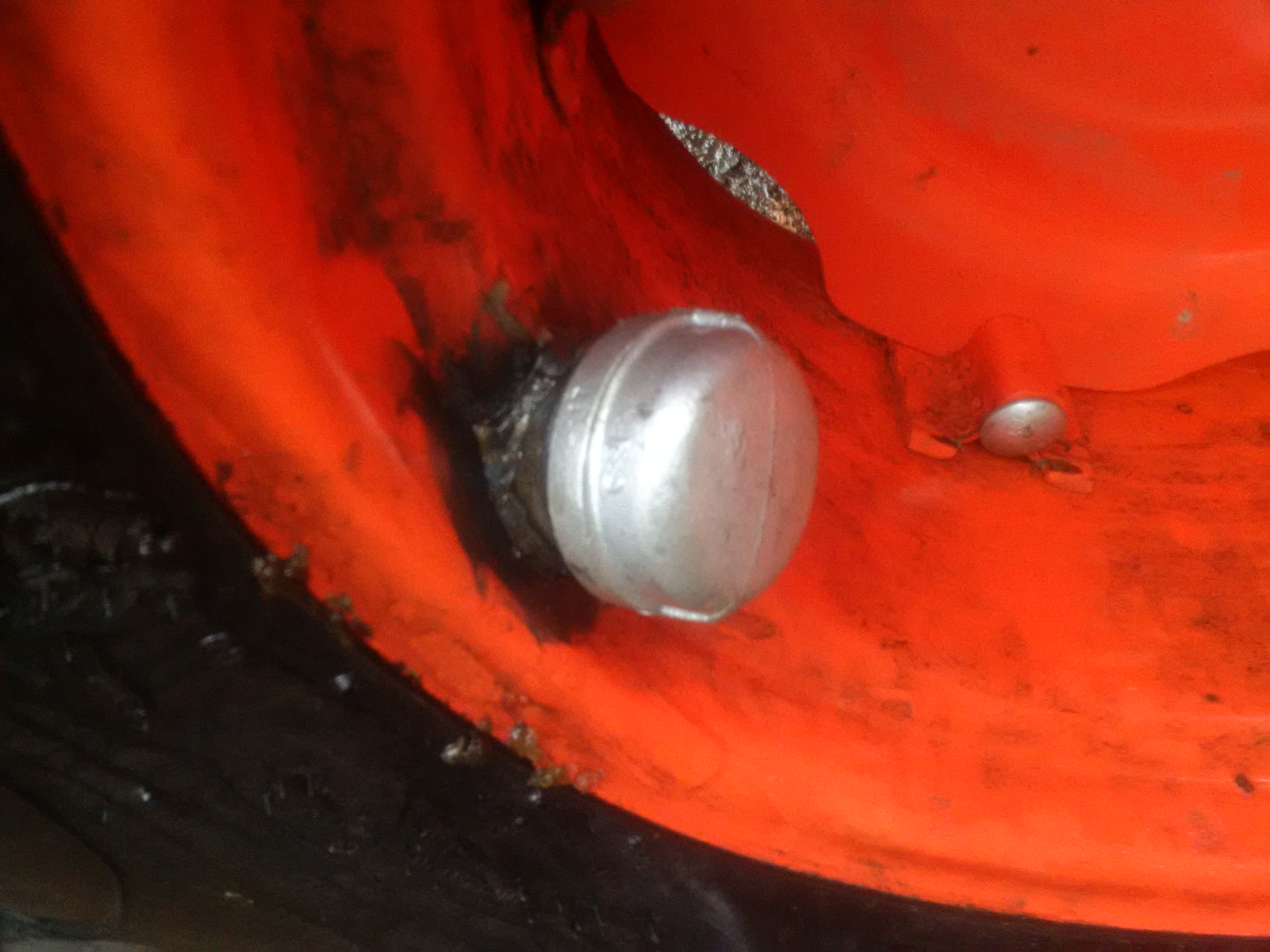

Welded on some pipe nipples for valve stem protection, I'll paint it when things warm and dry up some, next June probably.

Well, unless it gets to below -35* F, you wouldn't have to worry about freezing. My guess would be that it is easier and cheaper for them to fill with a diluted mixture.
