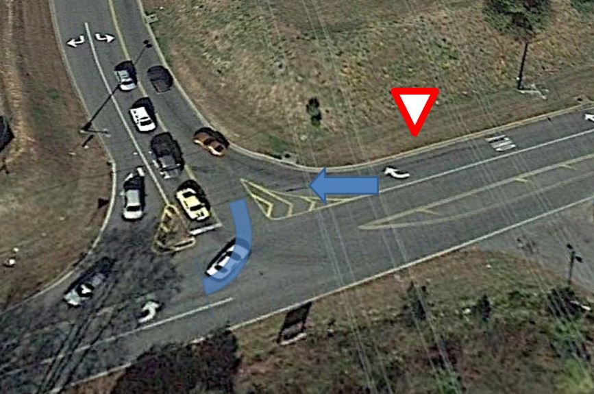

As someone said, the left turn is immaterial. That has already happened and has no bearing on who has the right-of-way where those roads merge together. The driver turning left has an obligation to yield to on-coming traffic--which has nothing to do with someone turning right. You have the YIELD sign in your lane. End of story.
Beyond red-green lights traffic controls (signs) rarely are used to tell a driver they have the right-of-way. They are used to tell drivers when they DO NOT have the right-of-way. I wouldn't expect the left turning driver to see a sign saying they have the right-of-way and the fact that there is none makes no difference.

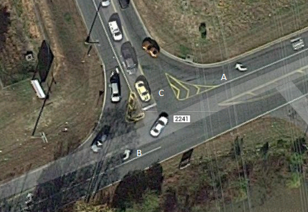

From your description, I see the yield sign on the right is only for drivers turning into the mall, because the left turn from the main highway must immediately clear the intersection as they are the greater hazard. The left turn from the highway has the right of way over the right turn with the yield sign.
Now in your case, you were going straight through from the right. The yield sign doesn't apply to you since it only applies to the right hand turning lane. For both you and her, you have an unsigned, uncontrolled intersection. With intersections, the person in the intersection always has the right of way over traffic that hasn't entered the intersection yet, provided they entered the intersection legally (e.g. they entered while a light was green and weren't able to exit until after it turned red.) She was in it first, she has right of way (barely.) It would be different if she was making a left hand turn off the road, to say a driveway, in which case she's required to yield to the oncoming cars and only turn when safe.
From a traffic engineering standpoint, that left hand turn lane needs to terminate with a yield. There's enough space from the photo to back up several cars waiting to turn without interfering with normal traffic flow on the highway.

I think this is the most appropriate forum because if we weren't rural there would be a traffic signaling light here instead of the mess I found today. Actually curious on two counts, first is if anyone else seen this scenario of traffic flow and signage and second, what is the lawful way to navigate the situation I faced today.
Referencing the attached image:
No traffic signals, only signs. The primary road is running left to right here and the top to bottom is actually the entrance to a local strip mall. Traffic leaving the mall approaches the main road with a stop sign. On the road everything appears normal to the birds eye. When a driver approaches the intersection from the right side of the image S/he can turn right into the mall drive or proceed straight through without stopping. From the left approach a driver must indicate and complete left turn to enter the mall entrance. Other traffic approaching from the left may proceed straight through the intersection without stopping (No signal lights.)
Sounds simple doesn't it. Ok, now the exception. Driver approaching from the right wants to make a right turn into the mall. S/He has a YIELD sign and an approaching driver with a left turn signal blinking. Which driver is expected to yield the right of way? What were you taught? Have you ever seen this silliness before?
So what happened today is the second vehicle turned left into my path which I thought was my right of way. When I confronted her she said the Yield sign on my side of the intersection gives HER the right of way. But I thought left hand turns always yielded to oncoming traffic except in the case of left turn green arrow. What gives?
