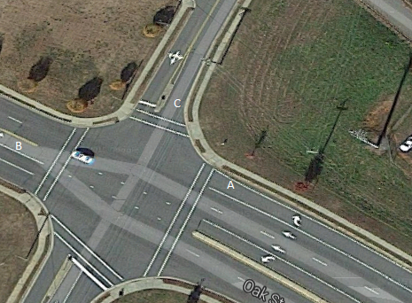

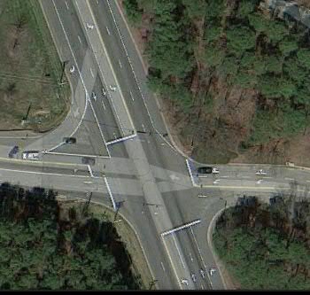

Look at this one. Assume North is up. Do you think that traffic that's coming southbound and turning right to go west on the other road, should yield to traffic that's turned left onto the same road from the northbound direction of the main road?
I believe that is exactly what everyone thinks my intersection is. It's clear the southbound would yield because he is nearly westbound when the other driver meets him at the merge point. Because this is light controlled there is also little risk of another southbound car proceeding straight through. You see where your distance between the turn and the merge is like five car lengths and the merger from the north is already nearing a parallel line with the westbound lane? In my case there is barely one car length of distance from intersection and merge. That doesn't leave enough reaction time and both vehicles are in full turn.
Further, once your south bound driver is in the curve he is committed to the merge, he can't get out of it. Therefore there is no risk to the one making a left turn that the southbound driver might change his mind and proceed straight.
There is one of your examples a few blocks from my intersection and it works fine because drivers expect it to work that way. Merge occurs when cars are nearly in same axis of travel. In my case our vehicles were not and at the least were 90° to each other. That's not a merge, at least not a natural one.

Have you looked at your photo from the first post, how is the yellow TRIANGLE in there and you get 90° You see the white line in front of the cars trying to turn, THAT's the start of her road. Sorry, that's how I see it.

Well, think about a standard intersection -- if drivers coming from the opposite direction are turning to the same side street, the one making the right turn has the right of way and the person making the left turn (across the other lane) is supposed to yield to the right turner. Nobody has signs in that case -- it's just common rules of the road that say the person turning right has the right of way over the person turning left. I think that aspect of it was was the OP found perplexing, and I agree to some extent.
Your example is correcst for a plain cross or T intersection, not where there is a 'merge ramp' as in his diagram.

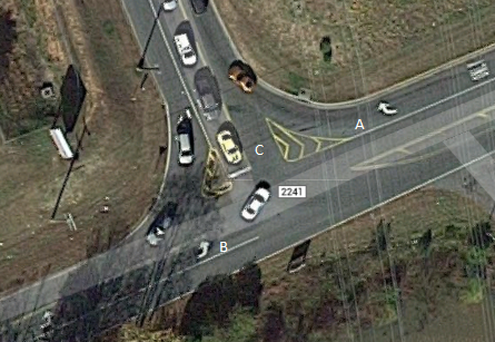

As is the case with the right turn into the mall that you posted the picture of. The writing on the road says right turn only and you cannot (legally) leave that lane once you get past the start of the yellow lines.
As for yielding, IF there wasn't the yellow triangle at the right turn lane (ie: if it ended like the left turn lane does) cars turning left would have to yield to cars turning right, but being as there is the yellow triangle there, you must yield to those making left turns.

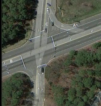

Here is an example of an intersection without the yellow triangle painted on the road, a driver in lane B who is making a left turn into lane C must yield to a driver in lane A UNLESS the driver in lane B has a green arrow:
Here is another version of your intersection, because of the yellow triangle (I think its called the gore), the driver in lane A who is making a right turn into lane C must yield to any traffic coming from lane B:
The reason is that due to the triangle the intersection is seen (by law) as being the same as the one posted by Country Geek in that, the driver in lane A who is making a right turn into lane C must yield to any traffic coming from lane B:
Aaron Z
