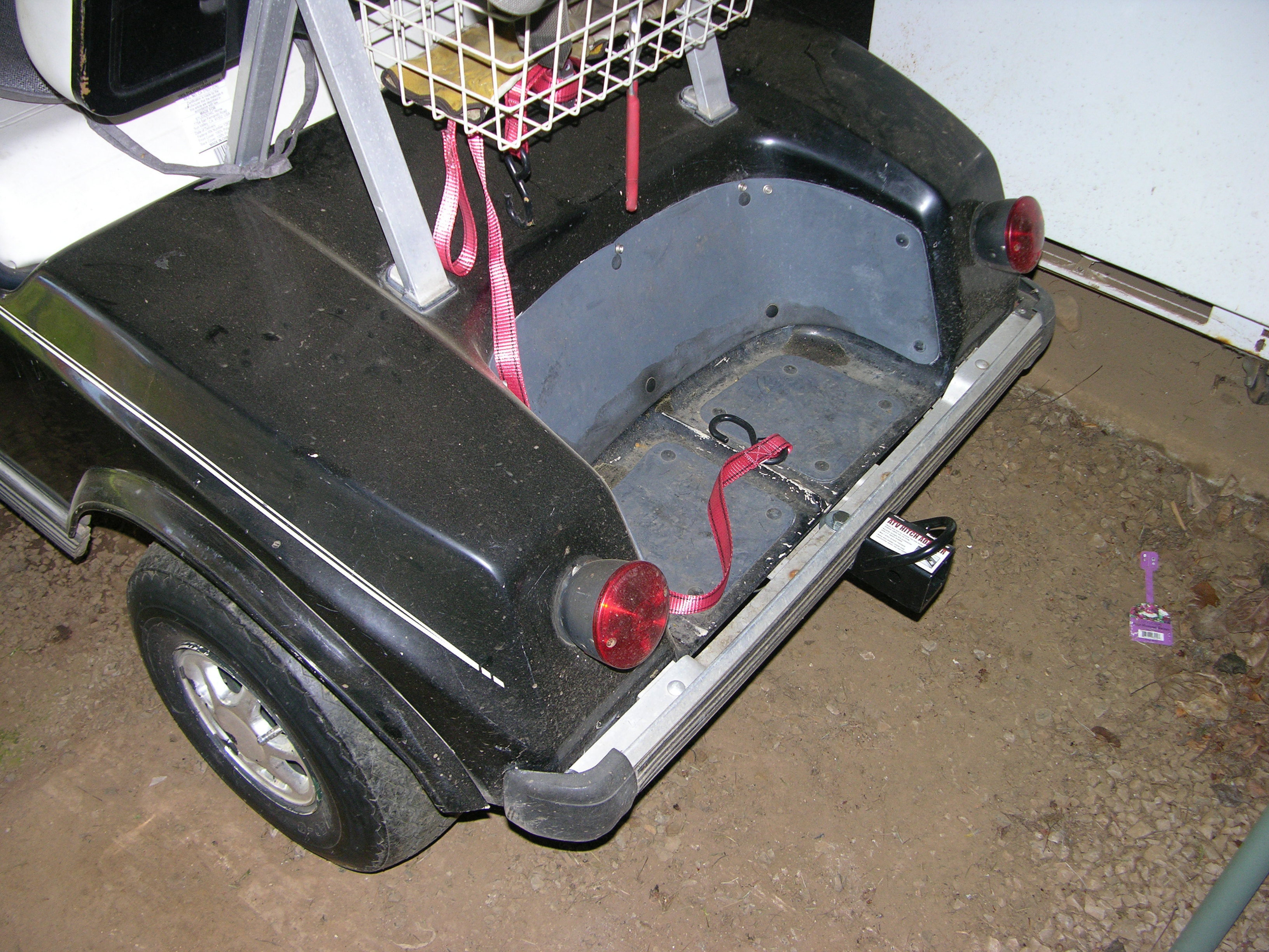

Got tired of having to get out a 15/16 wrench and the rattle gun whenever I wanted to drag my pin-hitch grass sweeper behind the ZTR, so I picked up 3 of the HF "ATV hitch adapters" - the ZTR just had a piece of FB with a hole for the hitch ball, welded onto the 3" angle across the back. I cut that FB off flush with the angle, and welded it (with the ball still on it) onto a piece of 1/4" wall 2" tube, and made another with just a hole in the FB for the pin hitch -
Then I put another one of the ATV hitches on my recent CL find; an older Club Car golf cart - had 6 months on new batteries, good tires, full enclosure and separate cover, all for $400 :cool2:
Notice all the washers in the last pic? There's even more ABOVE the hitch; the existing 1/2" hole was in the lower "stake pocket" lookin' piece AND the upper area (where the golf bags are NEVER gonna sit again :D) - the washers you can't see took a little fiddling around to get where they needed to be, I didn't want to bend either of those pieces so the washers gave me a snug fit BEFORE I tightened the 1/2" bolt.
I have one more of those ATV hitch adapters, thinking about a FRONT hitch on the cart for jockeying a couple of the smaller trailers around... Steve

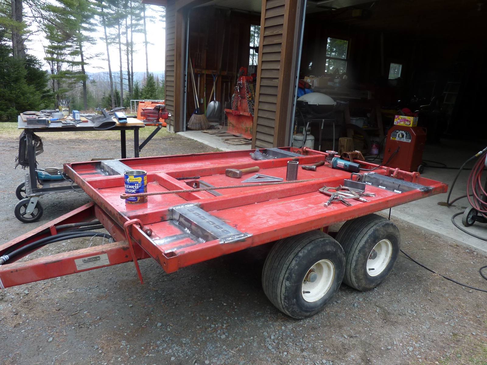

I have a little 3000 lb capacity dump trailer with 12" removable sides.
I want to put some stake pockets on it. Two on each side and two in the front so I can have a staked flat bed or add extension sides to give me a 3' tall box. The skin on the bed is only 12 gauge ( .104" ) and the side rails were made by folding the bed edge into a "U". So I need to beef up the side rails where the stake pockets will go. I took the bed off and flipped it upside down so I can work on the bottom. I am using some channel made from 2X2X1/8 angle. I cut two slots in the rail so I could drop the channel straight down and used a couple C-clamps to bend down the rail between the slots.
The bed was pushed down in some places from hard use so I made a hook and hung some weight on a bar to push the bed and channel up so I could tacked it flat.
This is as far as I got before it started raining again. I found welding this thin material a challenge.

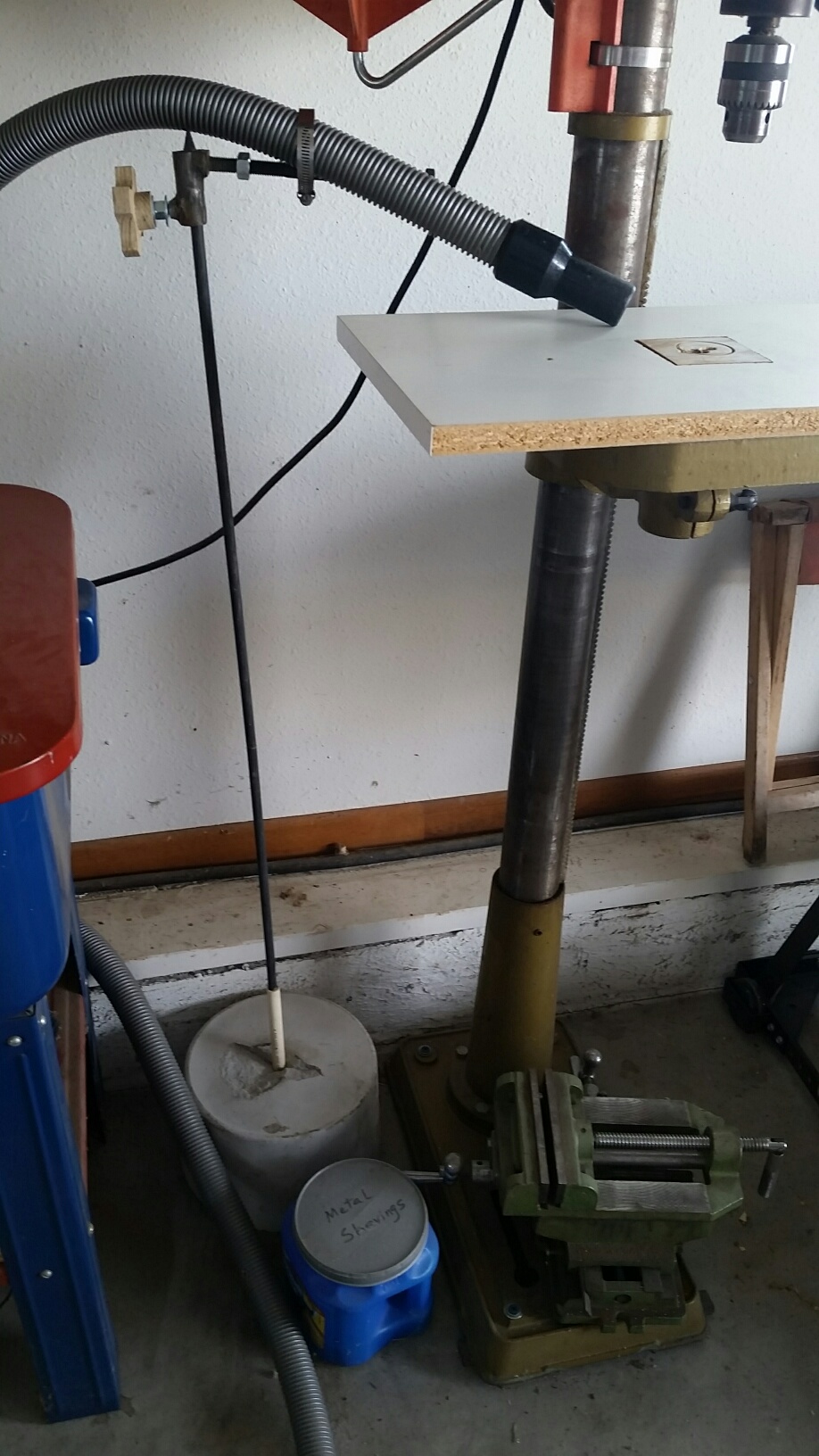

I cobbled together a stand for a shop vacuum hose to hang on at the drill press. The base is leftover concrete that I let setup in a bucket and later drilled a hole into. Some 1/2" PVC pipe and a leftover metal dowel from Mrs.tillers flower garden makes the upright. The 90 degree clamp thingy is from a project back in the 80's. No money involved it this one, just time hunting through the junk piles.
