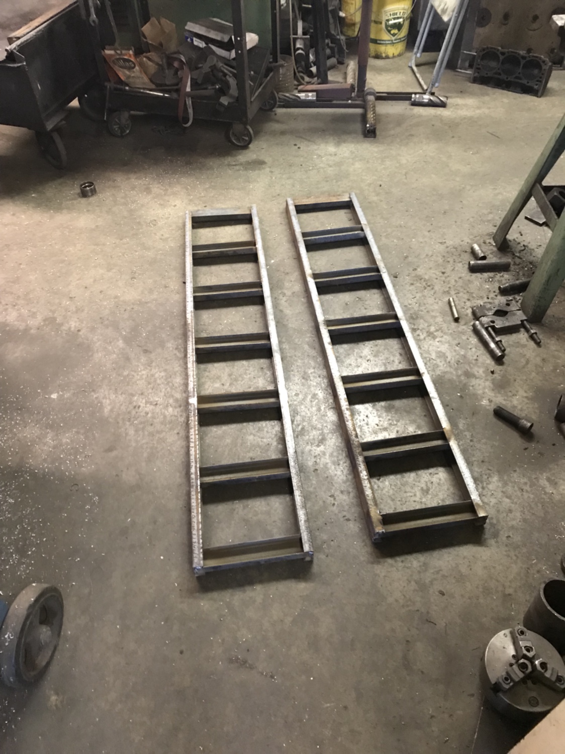

I built a set of trailer ramps. These are channel iron. I’ve built angle iron ramps before and the angle is much easier to work with. IMG_0303.JPG

Nice. How long are they, what is deck height and what machines are you loading?

They’re 60” long which is probably overkill. The deck height is probably 18” but I never measured. The machines that will be loaded is a Polaris ranger or a lawnmower.

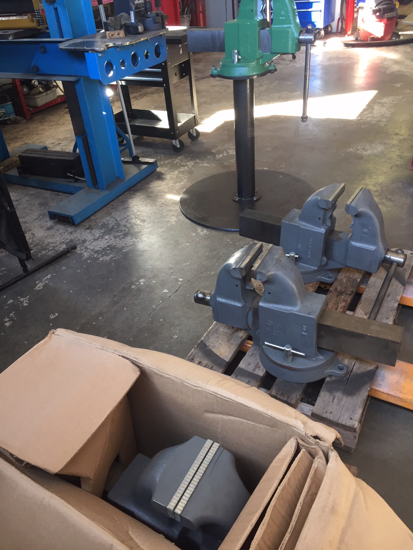

Wooof!!
What brand are those?
Would one of those lonely, still in the box vices maybe be for sale?
I would promise to give it a forever home inside my basement, eventually moving into my future shop, & away from any heathens that would abuse it.
PM sent
