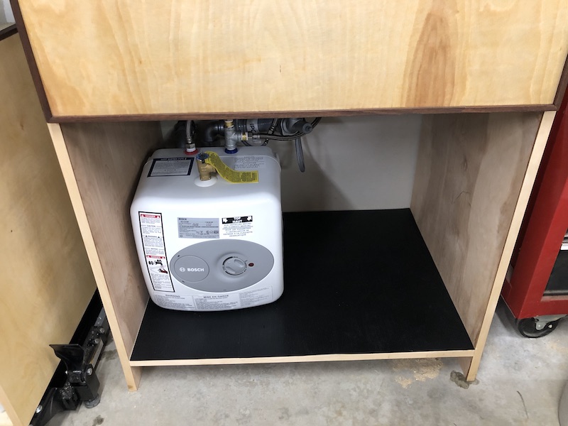

DE .. can you post info .. on your little water heater?

Sure... did a bunch of research and settled on this one. Bosch 4 gallon that runs on 110v. There is a 2.5gal version and a 7gal (220v) but I figured this will handle 5gal bucket of hot water and all the hand washing I can throw at it.

How long does it take to get hot water from when you turn it on?

Just went out to check.... One one thousand, two one thousand, three...
/ Todays shop time. #1,029
Wow! That's fast.

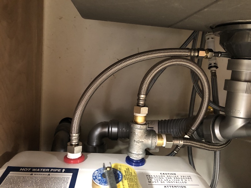

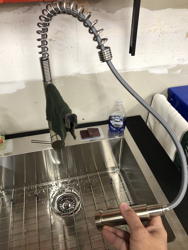

Since the water tank is hot and directly under the faucet it only has to travel a couple feet or so of flex braided supply line. Since my faucet is tall and the hose head is retractable it has a little longer to go than a typical sink hook up. You might cut a second off your time if you had a shorter run. :laughing:
Notice the T on the cold side. This is where the cold supply line gets split for hot and cold water. Don't do what I almost did and hook up the supply to the pressure relieve valve thinking the red and blue are your hot and cold outlets to your faucet.
View attachment 658045 View attachment 658046

Yes, keeps the water heated. Not exactly how long it took when I first turned it on but I'm guessing I checked in about an hour after plugging it in and I had hot water. I'm hoping since it is rated at 98% efficiency and only being 4gal, the energy use/cost is minimal. I plan to get a kill-a-watt device and do some measuring.

Still need to put it through its paces and do some measurements being the geek I am but looking at the specs...
1440watts (120v @12amp)
Recovery Rate @ 90ーF Rise = 6.8gph
Temp range = 65degF to 145degF
Okay decided to go out and do a crude test and learned I don't trust our dial temp (cooking) gauges in water. Switched to a cheap digital thermometer with probe and here are my crude findings...
Temp set (measured... no indicator on unit) = 135degF
Note: unit set in between 'ideal' and 'max' settings.
Cold water supply measured at 52degF
Filling a 5gal bucket... and after about running a little more than 2gal the temp started dropping. At roughly 3gal, temp of running water dropped to 125degF. Stopped there. Now very glad I got the 4gal vs. 2.5gal tank size for about $20 more. I don't figure I will need much more than a 2/3 bucket of hot water at a time but now curious as to actual recovery so timing that now.
Okay I missed the heating light turning off but it was less than 15min for it to recover. Maybe 10 or so?
