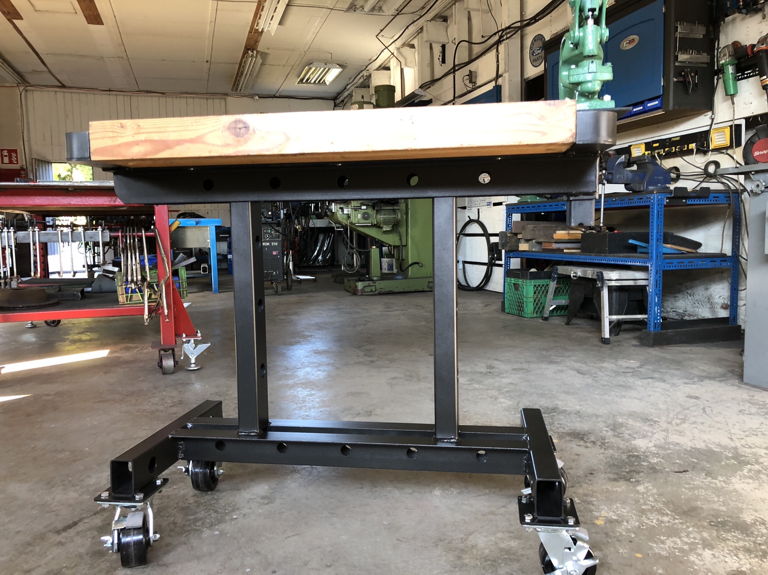

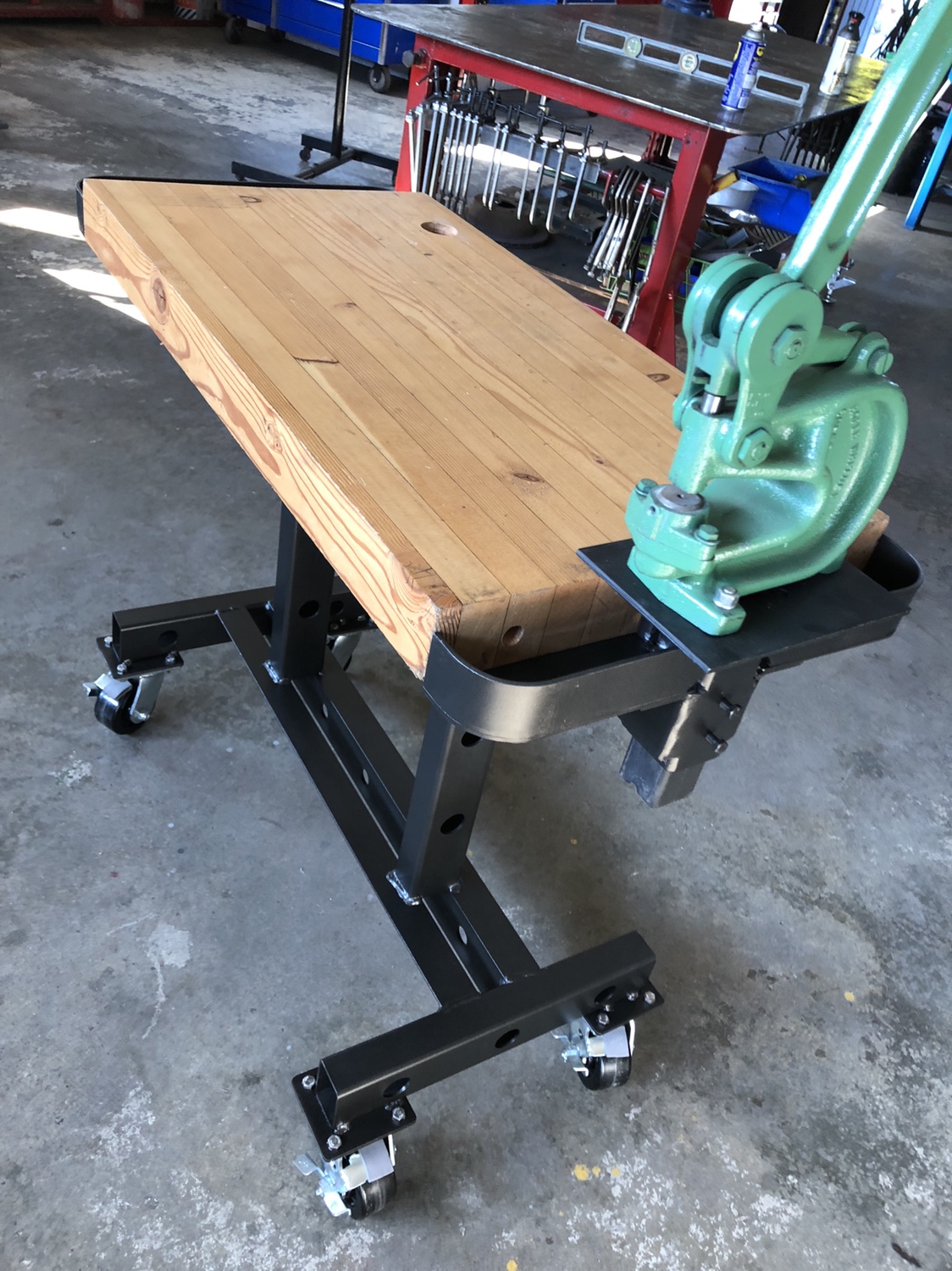

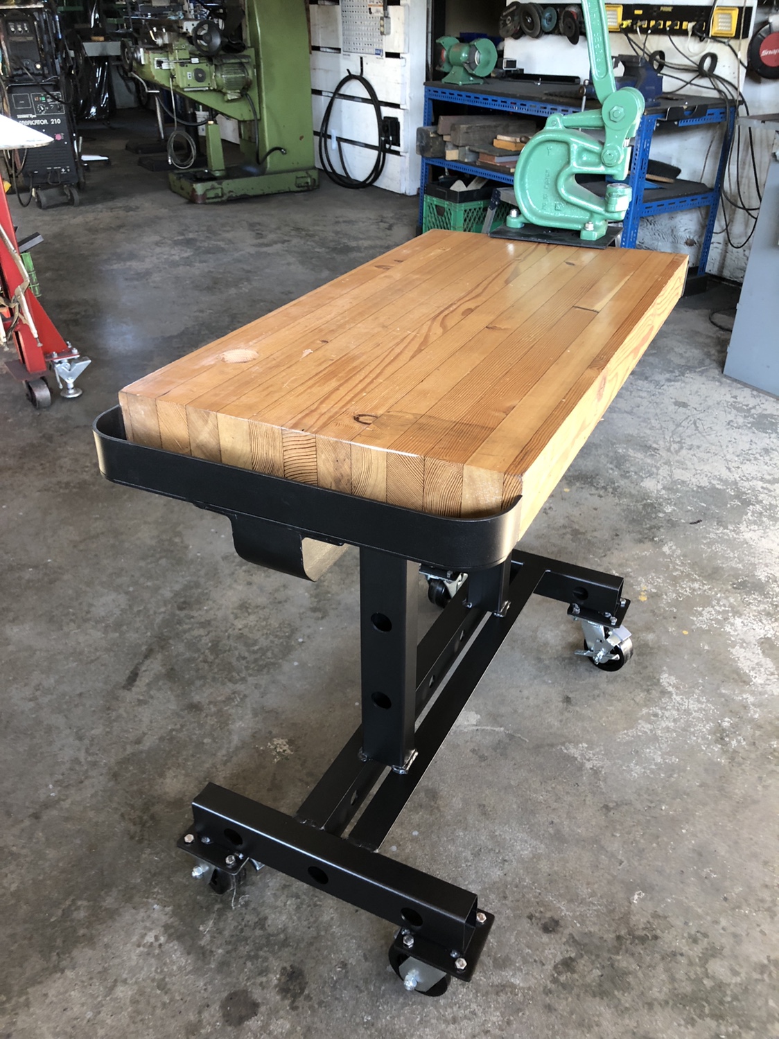

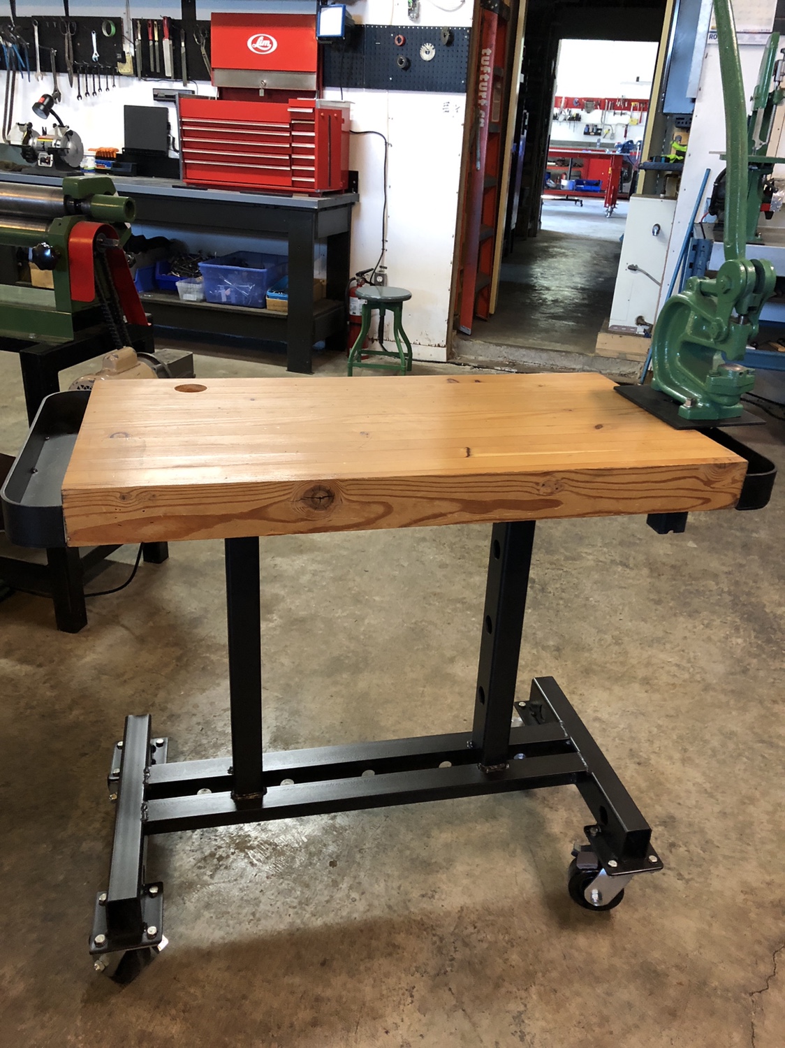

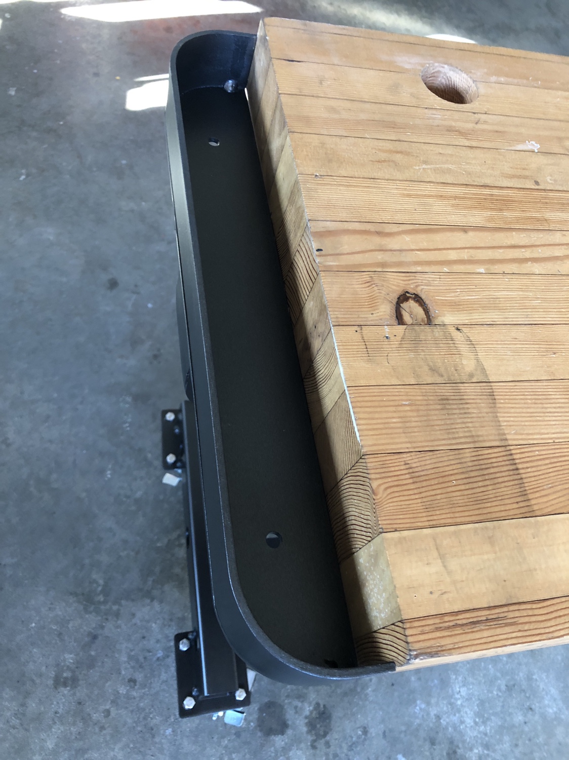

I made this mobile table for the shop.
36”x 19” x 3” laminated wood top
2”x3” square tube
2”x3”x3/16 angle
4” greaseable swivel casters
2.5” receiver tube mounted vertically
36” working height to match work benches, welding and burning tables.
Total weight 145 pounds

Terry, I had to wait to get home to see your pics on something bigger than my phone. I like it a lot!
Did you laminate the wood top yourself?
What are the holes in the structural members for?

Thanks Threepoint.
No special source for steel stock. The supplier I frequent treats me well though.
I can’t take credit for the laminated wood top. There was an ad on Facebook for various lengths. The lady was keeping the only six footer for herself so I took the next longest piece for forty dollars.
Dragoneggs: the holes are purely cosmetic. Most my projects reflect a holier than thou attitude.

I figured as much! :drink: Boy do I need a Magdrill!
Actually the holes in the rectangular tube were done with sheet metal cutters on the drill press. (I don’t have a fancy setup for my mag drills like BuckitCase). It was easier for me to keep the holes parallel using the dp vise.
I used the iron worker for the holes in the angle iron. Easy peasy
