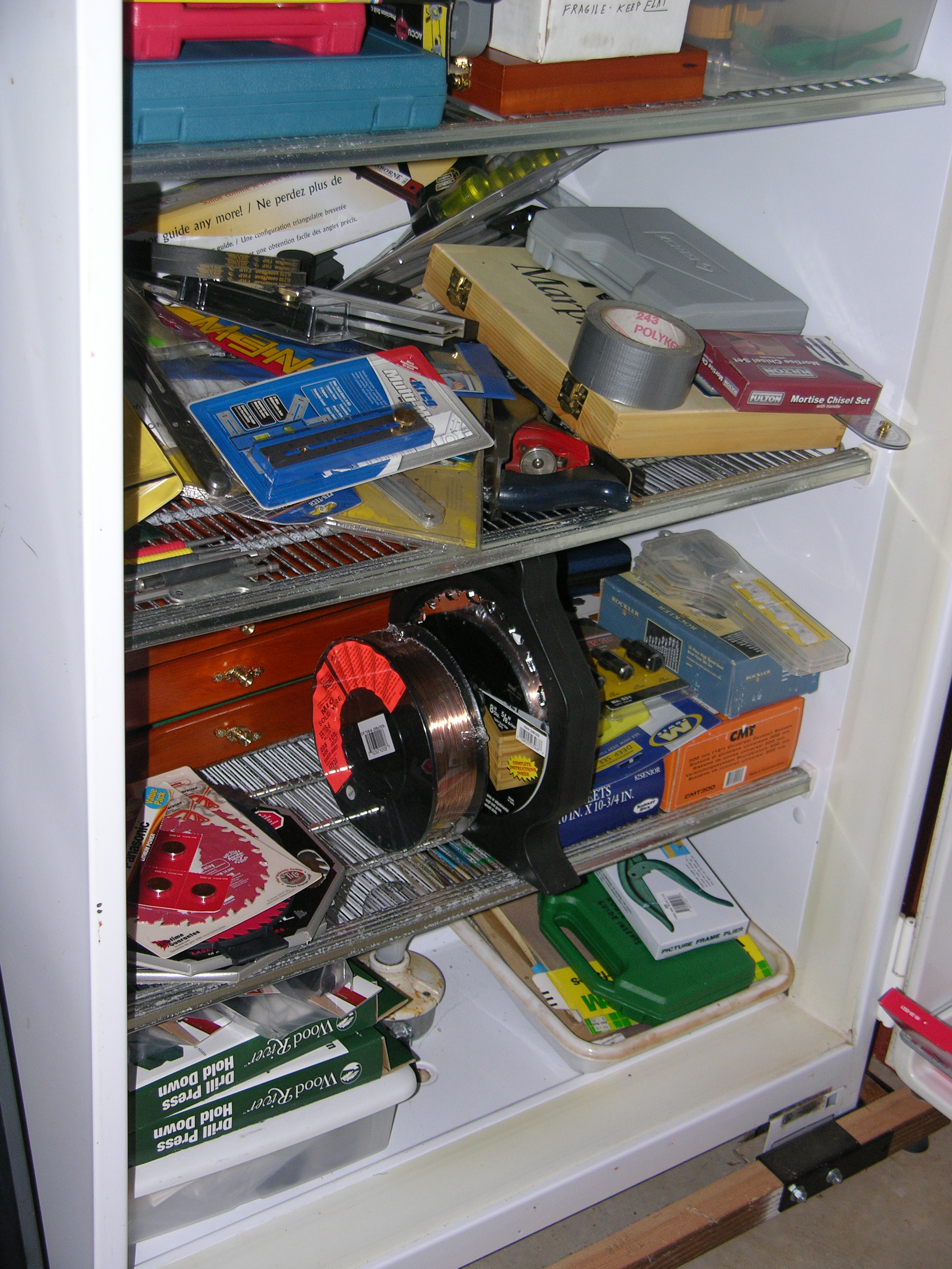

Possibly, but my experience has been that today's bulbs don't last long at all - I have another bulb in a dead freezer, I keep nicer woodwork stuff in it (and alignment tools/aftermarket accessories) mostly - I took one of those "outhouse" porcelain fixtures, mounted it in a box, removed the little "mushroom" drain cover and ran a cord out thru the hole - then I drilled a hole in the top of the freezer and put the "mushroom" up there, for just a tiny bit of circulation/venting -
Still to do: cut out all the original shelves and put something EFFICIENT in there...
When I had a 50 watt "normal duty" bulb in it, the bulb only lasted maybe a month or two. After the second time I opened it and found a dead bulb, I bought some 100 watt "rough service" bulbs for my "anti-condensate" usage and put one of the HF "drill speed control" boxes on the freezer, and another on the power strips for all the stationary (but mobile :rolleyes:) tools; that was about 4 YEARS ago, and in that time I replaced ONE bulb because I knocked the clamp fixture loose.
YMMV, my response is "yeah, it'll work - but CHECK it often if it's in an out of sight place"... Steve
Oh, BTW - with "half power" (actually half VOLTAGE) that 100 watt bulb actually uses QUARTER power, and in January when it's 30 degrees outside and the (normally un-heated) shop might be 40, that freezer is usually around 75 degrees when I open the door, and BONE DRY...

Around here, everyone who is serious about welding, has an old fridge with a light bulb in it, to keep welding rod fresh and tools rust free...
SR
