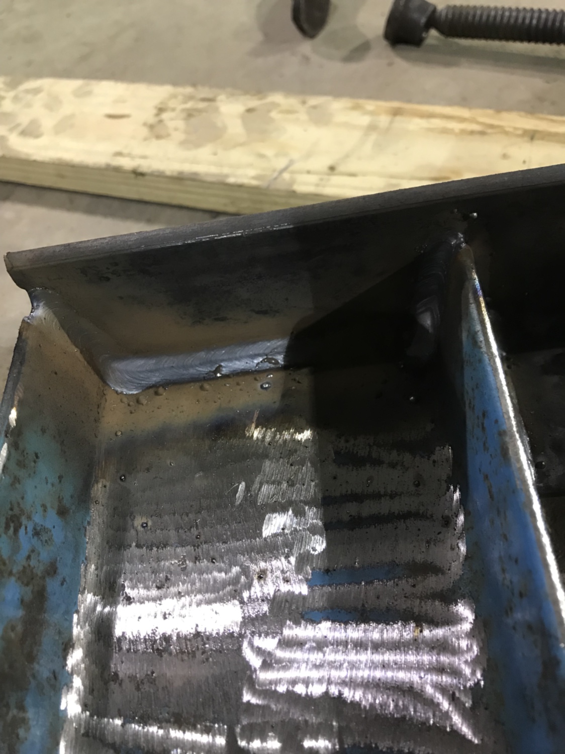

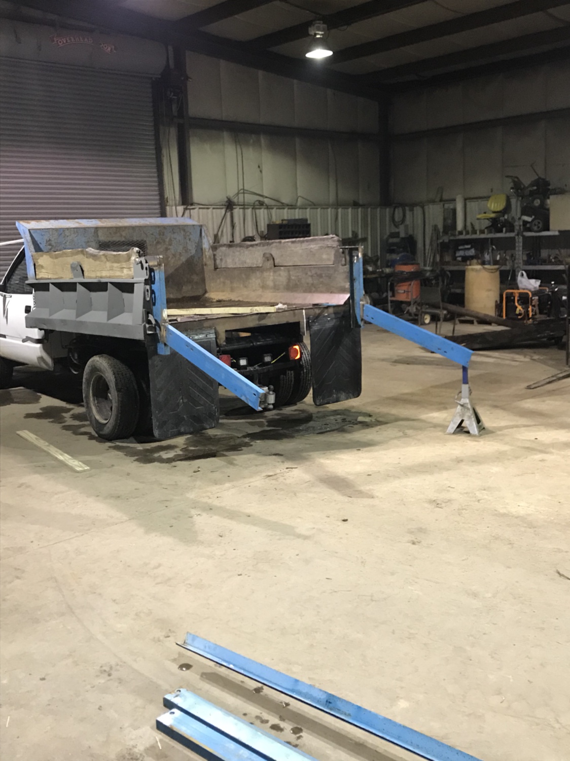

I worked on building a dovetail ramp for my dump truck to drive a mower up. I plan on welding another piece across the back to mount fold down ramps on and I have the aluminum floor from a box truck I plan on decking the dovetails with.IMG_1523.JPGIMG_1522.JPG
   / Todays shop time. #818
So. The dovetail will be removable and utilizes the tailgate hinge and latches?
Will you be able to lay it down by opening gate latches and raising the box allowing it to pivot on top hinge pins? Or?
Dual shield for the welds?
   / Todays shop time.
#819
Yes it utilizes the tailgate hinge pins. I haven’t decided how to remove it. The tailgate is too heavy to put back on by hand so I might just lift the dovetail with equipment. I could probably design it to come off on stands but I might just set two post in the ground and put a cross beam on it and lift it with ratchet straps. I think the welder is just gas shield but it wasn’t my machine so I don’t know for sure.
   / Todays shop time. #820
Crossbeam like you said would prob be the best. Finding the balance point and having it suspended would be easier and safer to insert or remove the pins as opposed to lifting with a machine.
