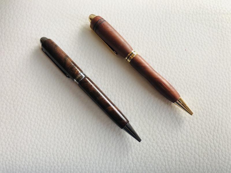

The base wood is some kind of California black walnut/eucalyptus if IIRC from what the guy at Woodcraft told me. The top handle is from rotten vine maple from my back yard that I stabilized with some cactus juice (infused resin). The decorative ring is gold glitter applied with CA glue prior to turning.

Thanks... here are my first two pens I turned this weekend. Getting back into woodworking this winter after I finally dug out some of my buried tools and machines in the shop along with playing with my new lathe.

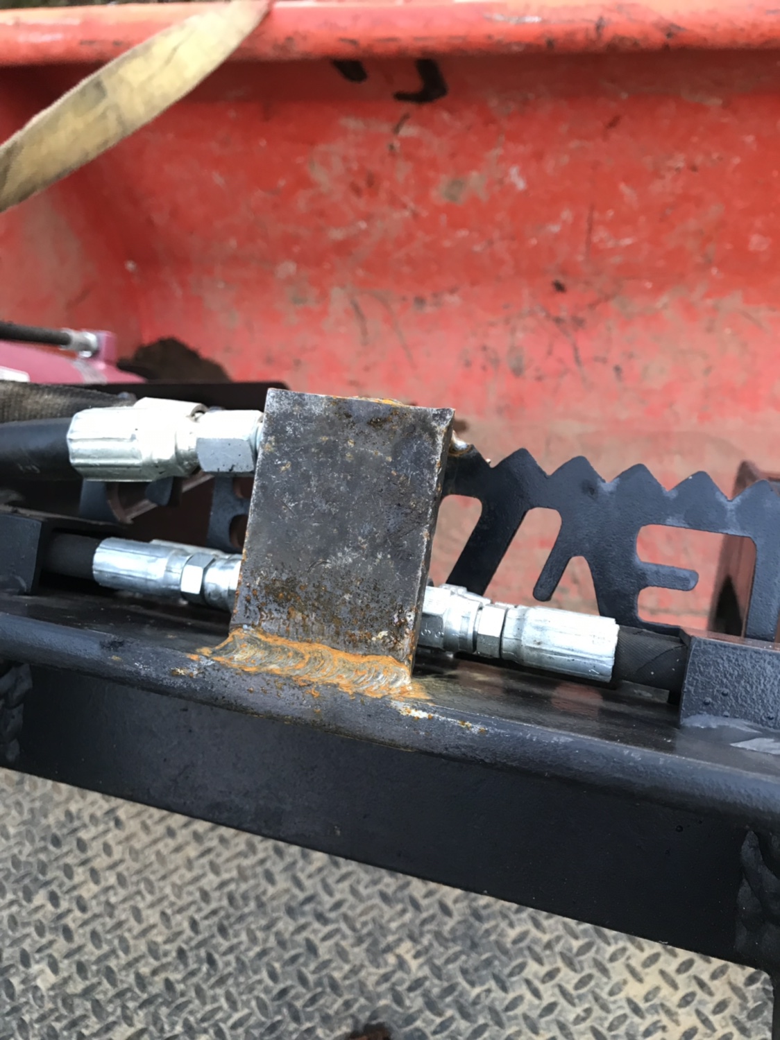

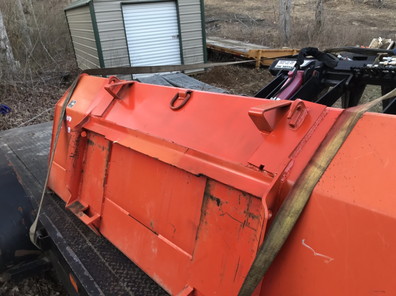

I added 2 grab hooks and a d ring on my bucket and a fitting guard on the back side of my grapple. The grapple had a guard on the front side but I put the grapple in the bucket for transport and the bucket back was hitting the fitting. IMG_8368.JPGIMG_8369.JPG
