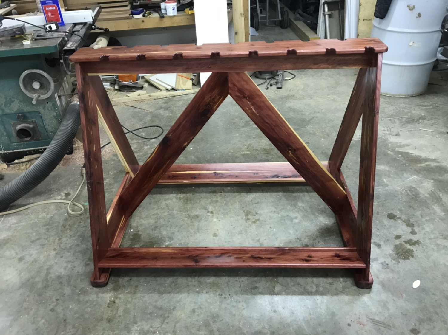

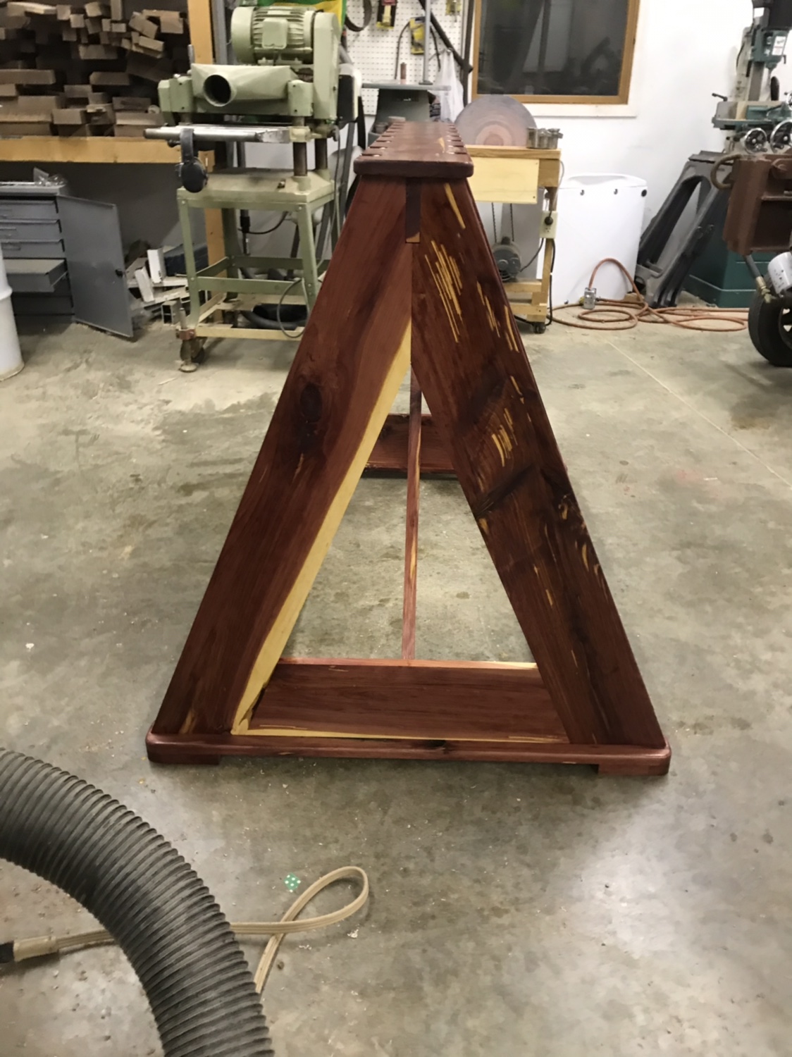

I finished a gun rack I’ve been working on. A member of the shooting team was killed in an accident and one of my buddies and I built the gun rack for a memorial. IMG_8444.JPGIMG_8445.JPG

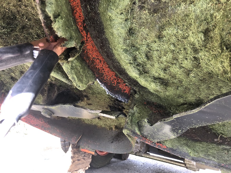

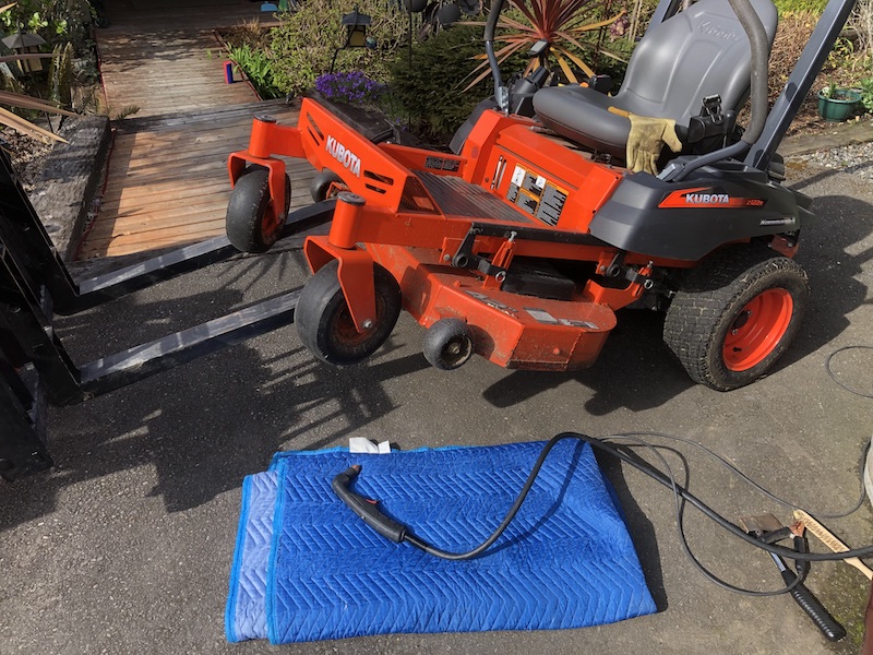

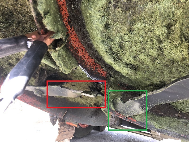

Since I didn't see an 'Under the Seat Time' thread, I thought I would post this here. Replaced my mulching blades this winter and the new ones must be a little bigger than the ones that came with the OEM mulch kit. :confused3: Even though they are also from the Kubota dealer, one blade was hitting the mulch shroud between the two blades.
Got the Z-turn close to the shop door, lifted it with my tractor forks and did some crude carving with my plasma cutter. That was fun but I nearly had a fire from the grass stuck to the underside of the mower deck. :eek:
View attachment 648219 View attachment 648220
Hopefully you tried turning the far blade right side up first (red box is upside down, green box is right side up)?
648226d1585528803-todays-shop-time-img_4027-jpeg
Aaron Z
Crap!!!!!!! No wonder! What an idiot! :mur: :duh: Thanks Aaron! :ashamed:
