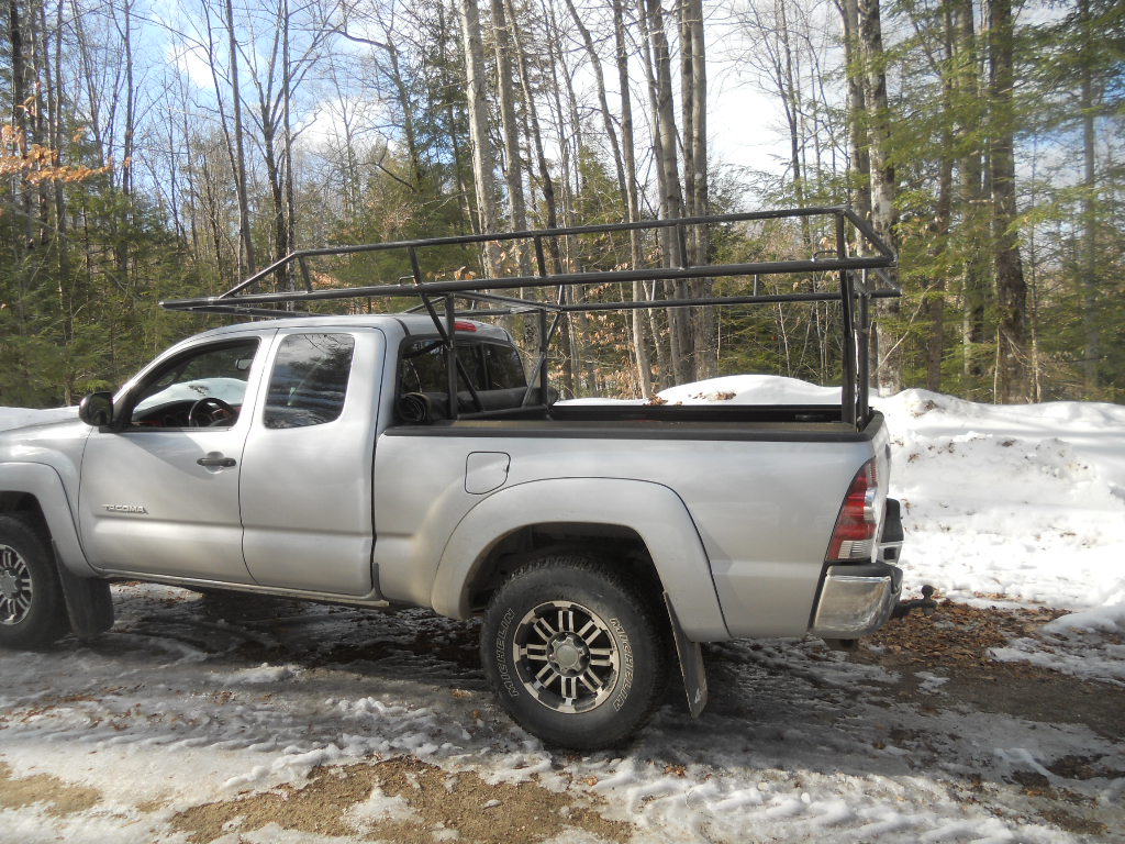

Finished up a set of racks for the little truck. With the plastic bed and tonneau cover, I made it sit down on the bed floor against the frame.
They won't stay in there all the time and will be held in with turnbuckles. Prime & paint next.

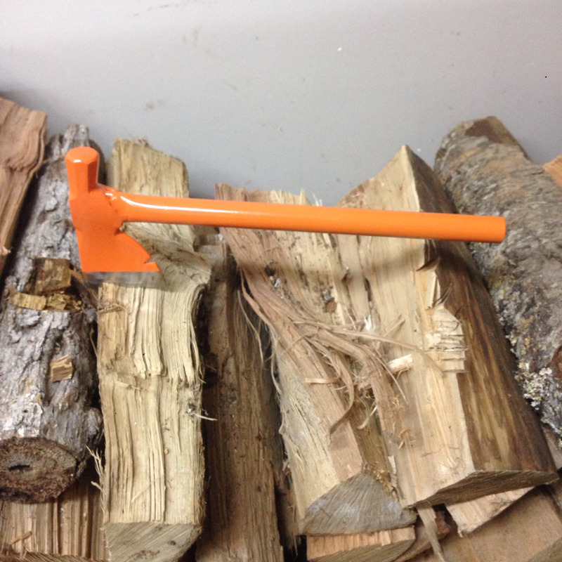

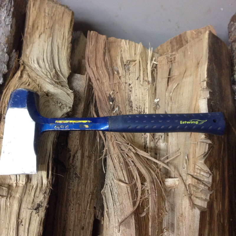

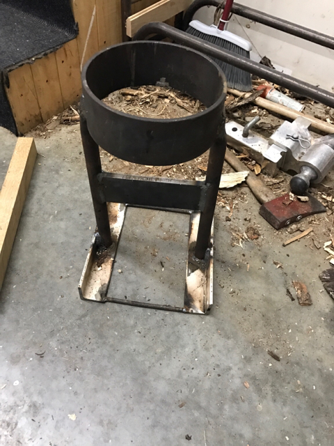

Yesterday I built a kindling splitter. It doesn't work as well as I'd hoped. The blade is too blunt. I'm going to take a grinder and grind it back some. A 3/8 thick blade instead of the 1/2 I used would have been better. After I built it I realized I had some retired wood chipper blade laying around. That would have been the best choice.IMG_9161.JPGIMG_9162.JPG

Now that is something I need to make :thumbsup:

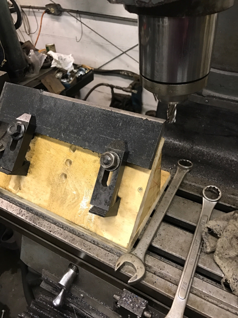

I made a mold to hopefully cast aluminum parts.IMG_9196.JPGIMG_9199.JPGIMG_9191.JPG

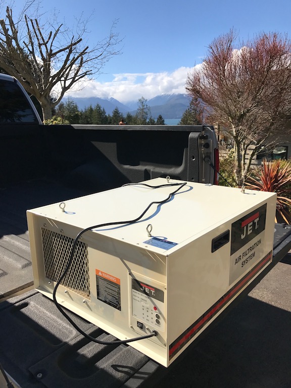

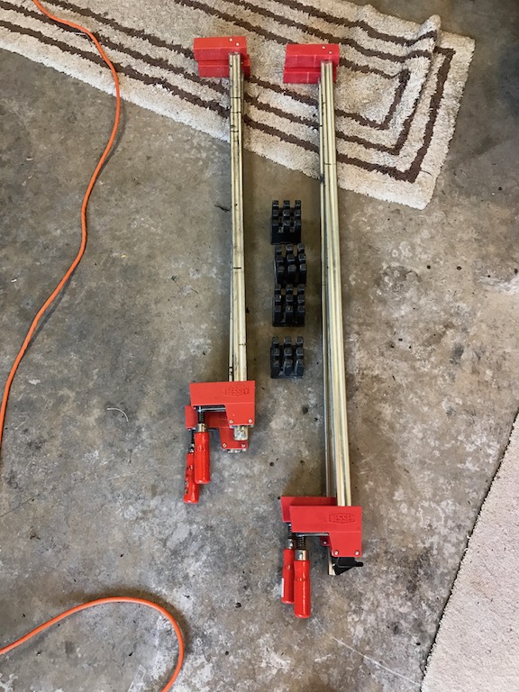

Today was a great day (the sun came out here finally) and for my shop! Didn't get anything done but did make a great score on a JET Air Filtration system w/remote and 4 Bessey large K-clamps, plus 4 clamp blocks. $150 for all. Figured $600 new and all in very good condition. Rare for me to find quality stuff I really need in great shape for a great price. :cool2:

Very very nice score. :thumbsup:
/ Todays shop time. #178
Dragoneggs, nice air system. I found it worked great in my last shop, though I put a fairly loose weave filter in front of the opening
if I was painting or doing a lot of sanding, to preserve the internal filters.
It blows enough air to cool your shop a bit too.
/ Todays shop time. #179
Thanks daugen, in fact I was wondering about spray paint effect. I saw a youtube vid where the guy increased the efficiency by replacing the pre-filter with a two larger cheap furnace filters making a prism shape to more than double the intake area. I thought that was a great idea. Plugged it in and it works great... now just have to figure out a good location on the ceiling that doesn't get in the way and I have convenient 'line of sight' for the remote control. I like the fact it has a timer (2,4, and 8hr) for auto off! Quiet too!
/ Todays shop time.
#180
I have one in my shop and it works pretty good. One improvement I'm glad I made was make a lowered mount for it. My shop has 10 or slightly higher foot ceilings and I couldn't reach it if it was mounted directly to the ceiling. I made a mount that lowers the buttons on it to just inside of my maximum reach. The point of this is I have a hard time keeping up with the remote.
