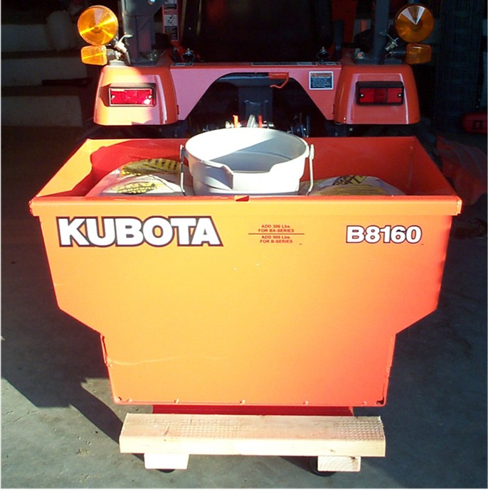

Having mastered (not) the art of using my rotary cutter after 5 hours in the seat I decided it wa stime to tackle my FEL.
I successfully removed the cutter from the 3PH and went to connect up the ballast box.
Since the lower arms didn't reach down to the ground I actually had to lift the box while I connecetd it up; no problem since it is currently empty but it will be a different story once I get it loaded.
So my question is; how do I then unattach and subsequently reattach a fully loaded ballast box? The only thing I can think of is that I will need to have something 9-12 inches high to stand it on when it is not on the tractor. Am I missing something (quite possibly)?

I made a dolly for mine (attached picture). If you have a cement floor it works great and it is easy to make.
John

And in the future when you get a welder to do more projects you can change the height of the ballast box attach points so you won't need a stand to set it on.
