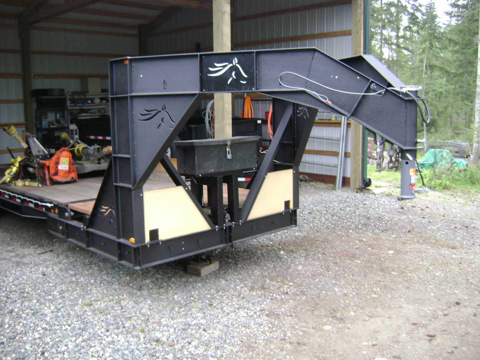

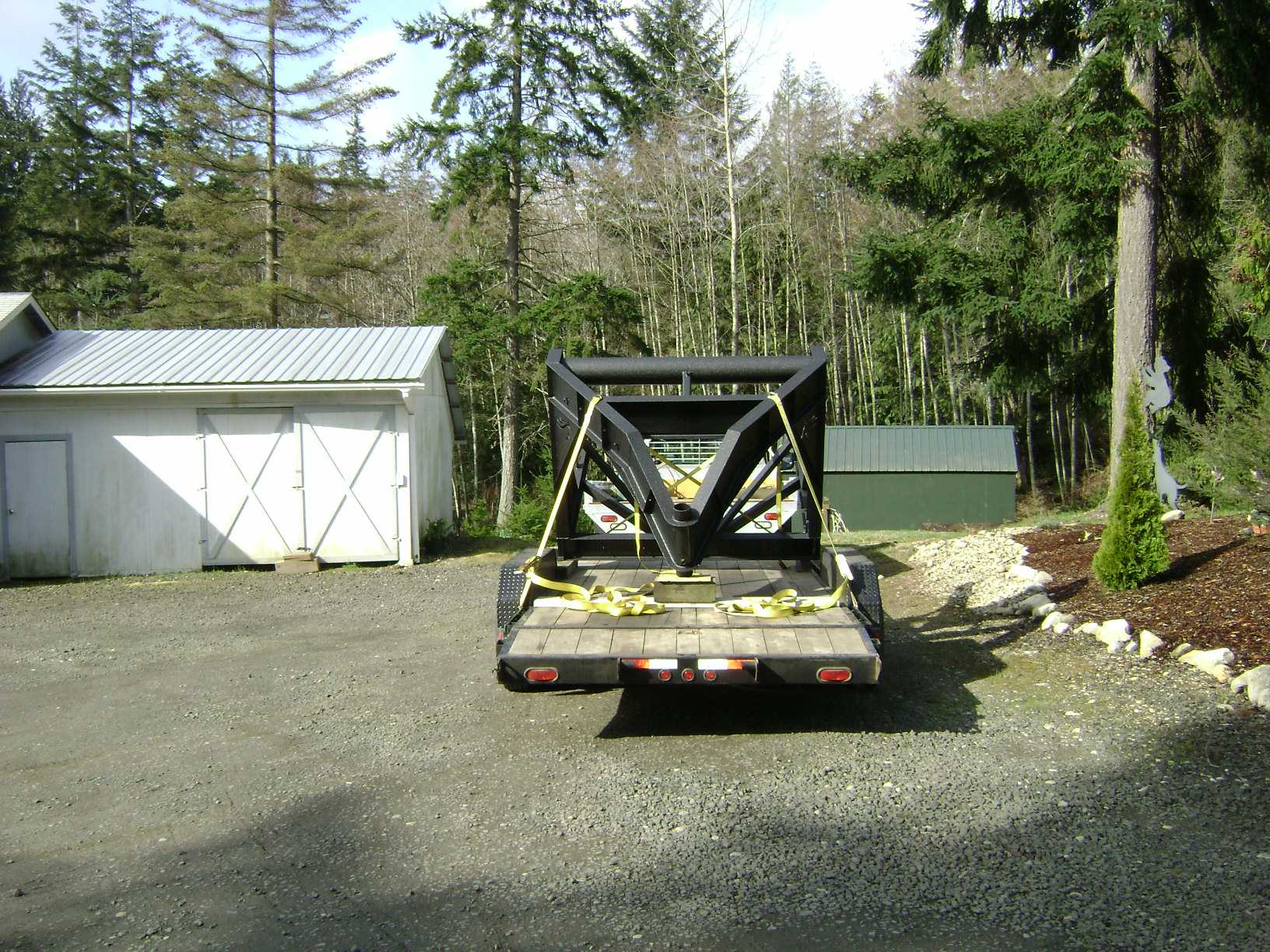

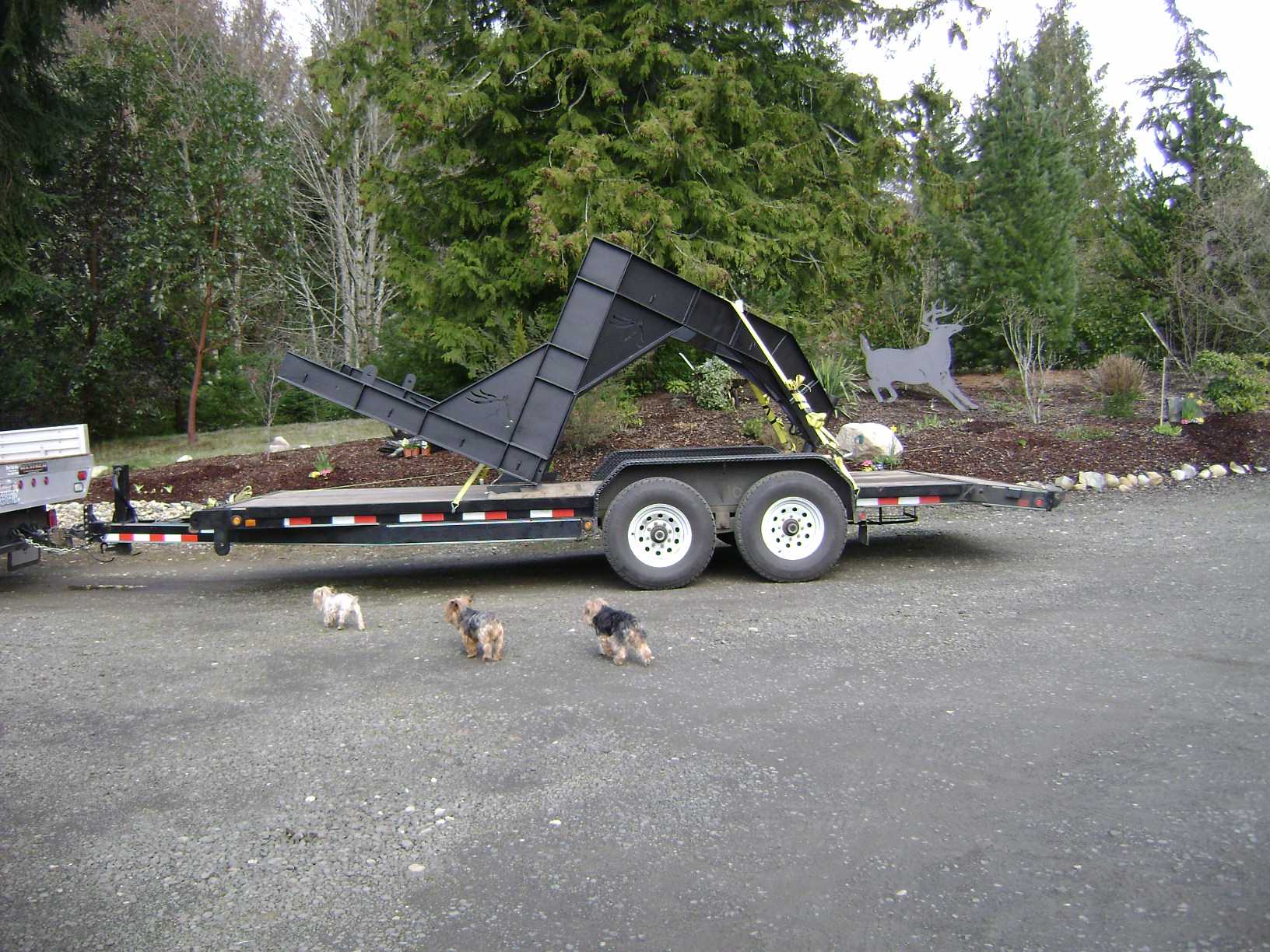

Here are a few projects I've built at home.

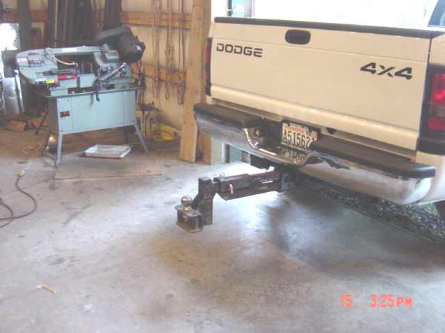

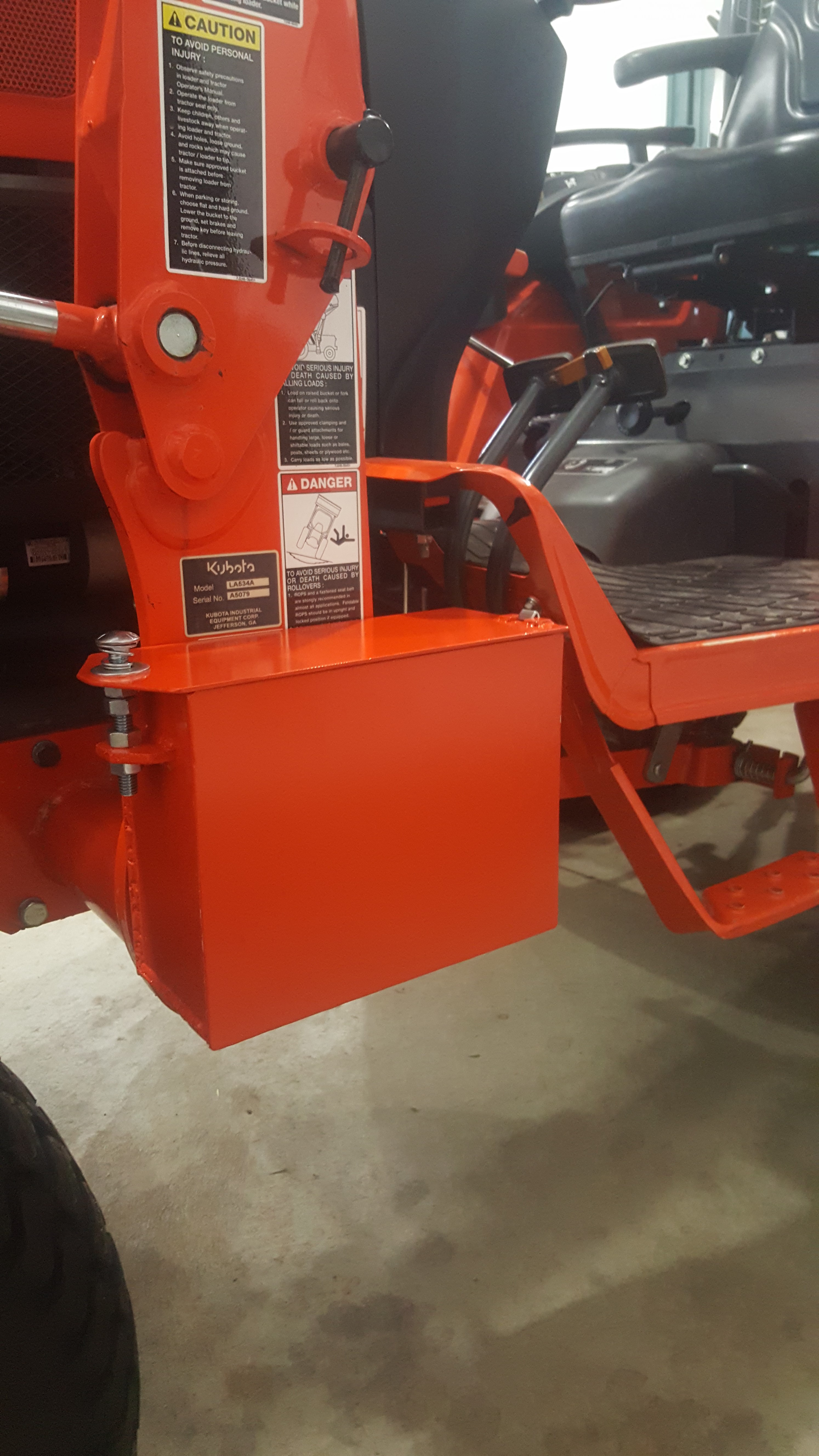

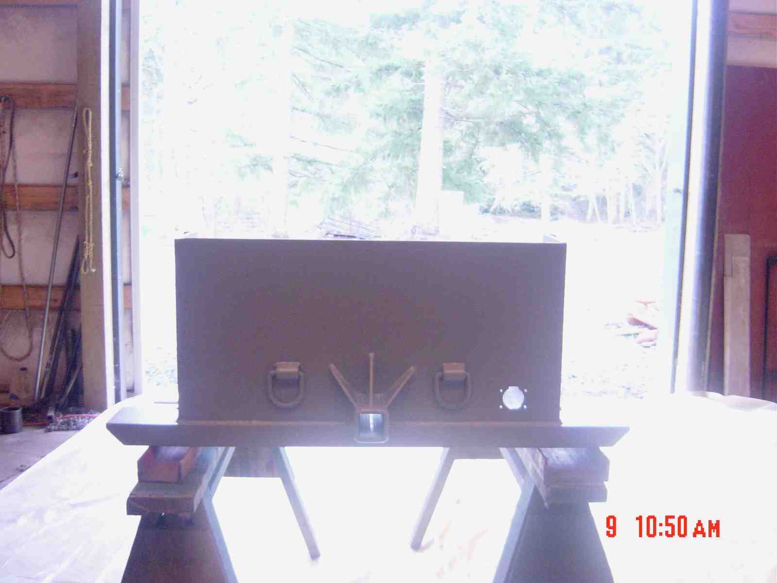

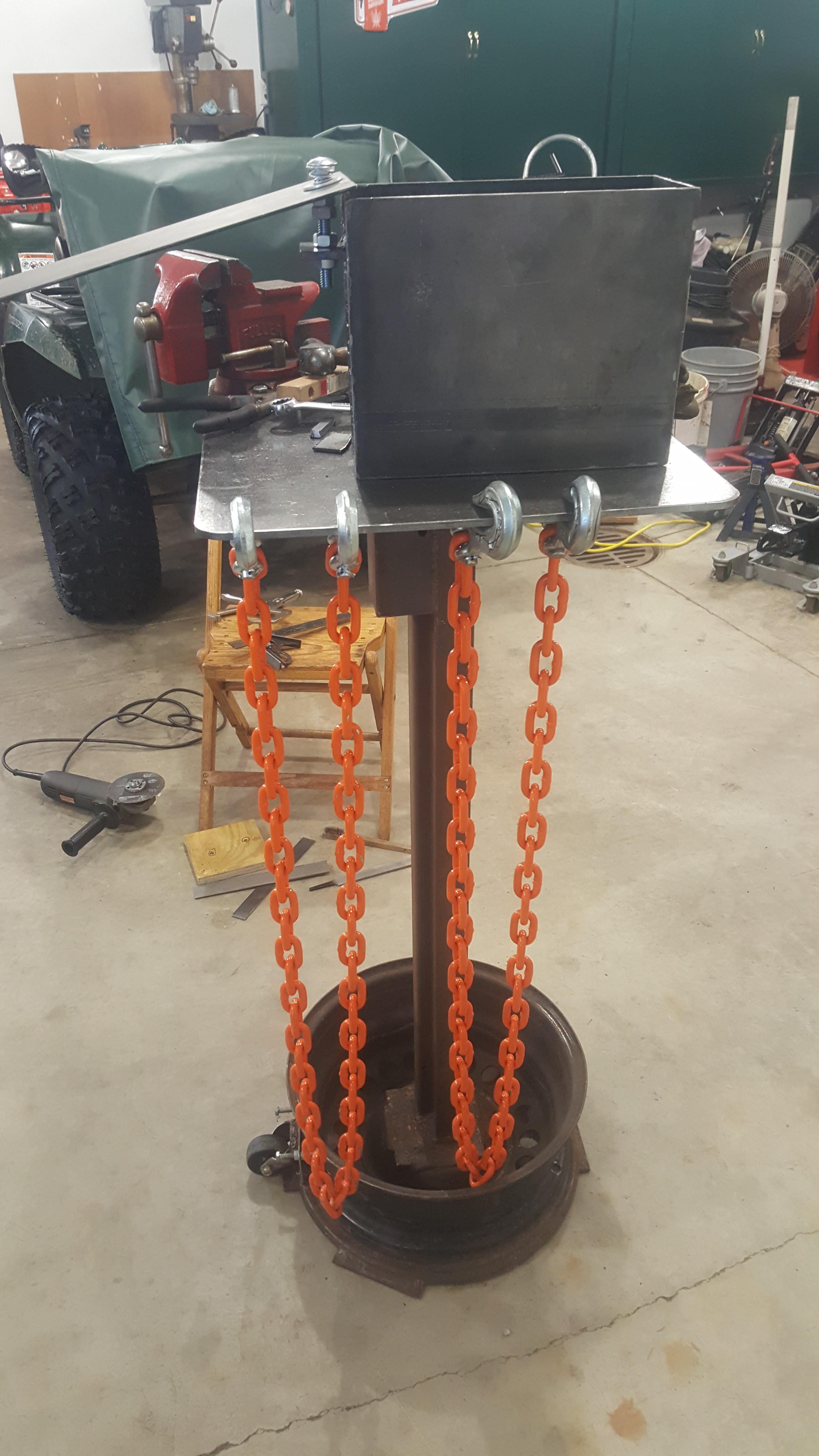

/ Today's Welding time! #5

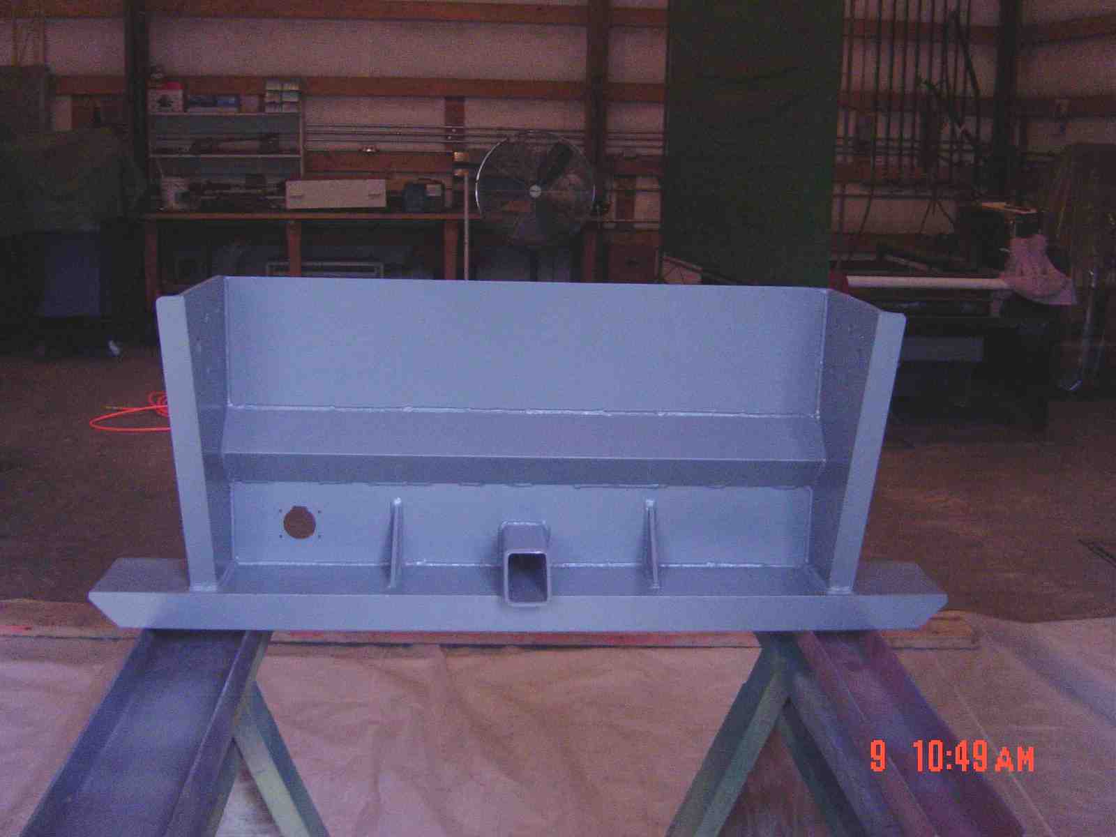

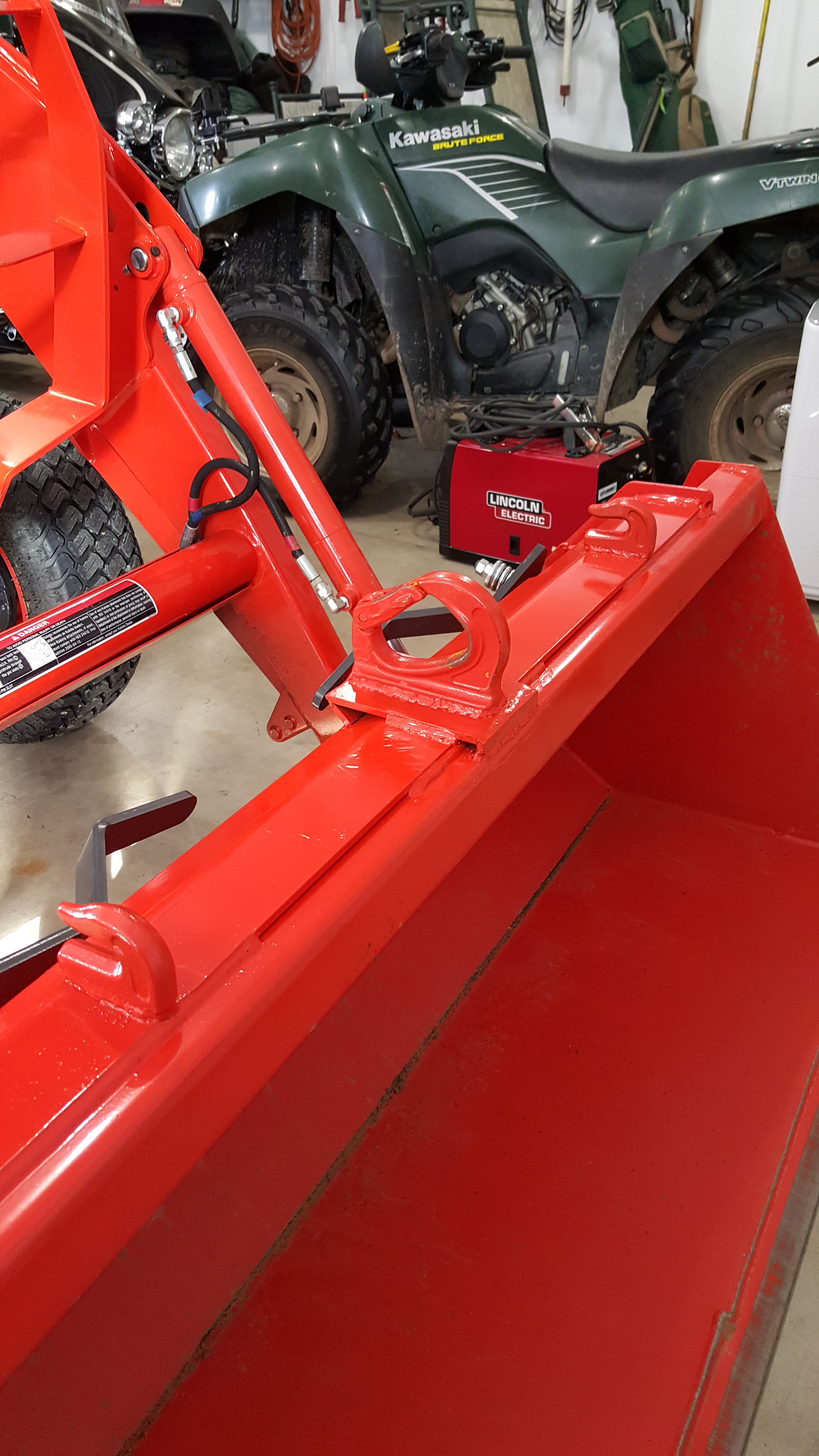

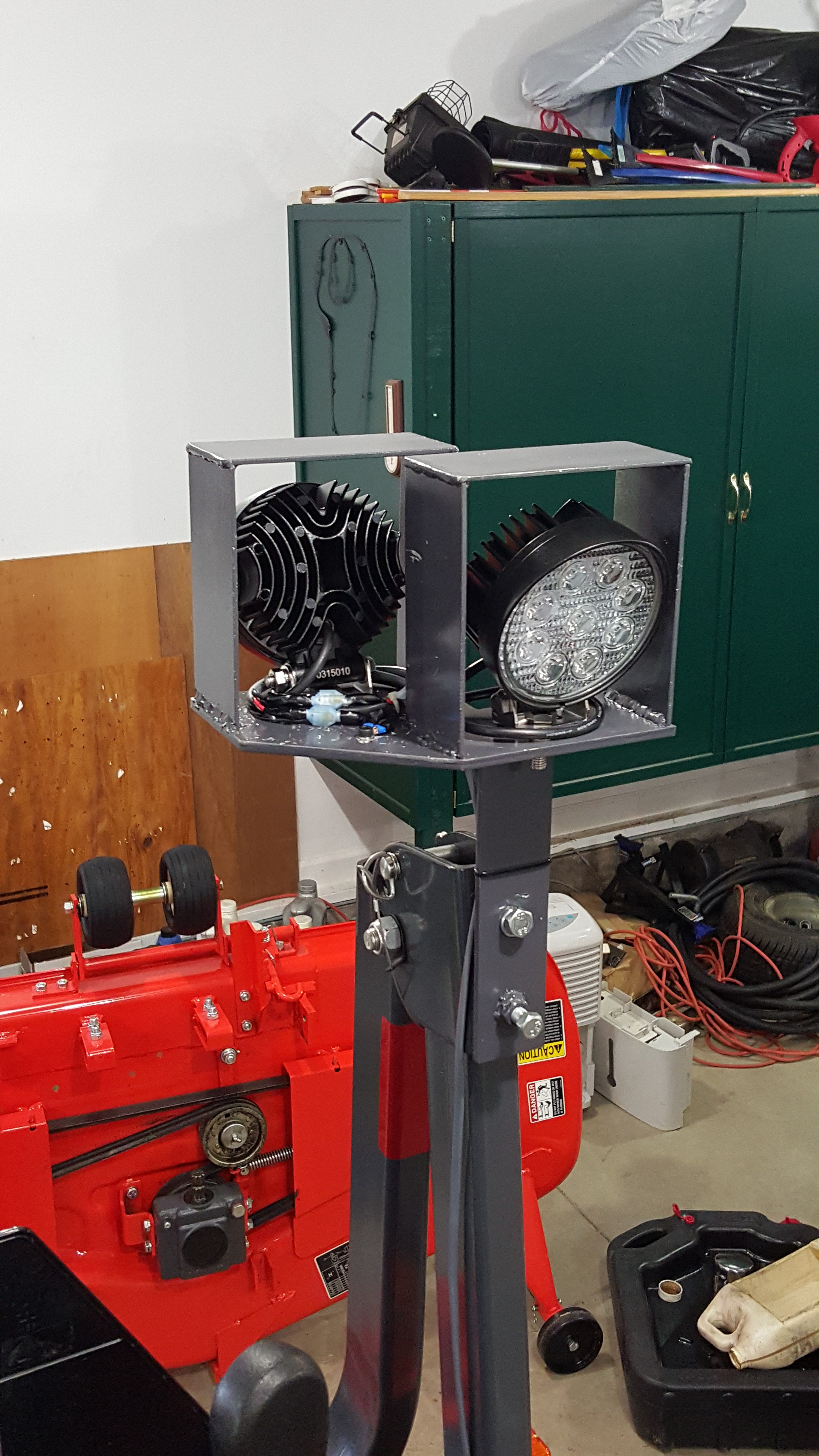

These are some of the projects I fabbed up for my B2650. Fabbed up a compact ballast box for ease of getting around, and I have 500 more lbs of weight I can add if I need it. Light brackets for my LED lights, welded on some hooks to the bucket, and welded up some 1/8 steel for some chain toolboxes that mount to the existing holes in the loader frame. Going to make one for the other side also.
20151130_101654.jpg20151215_101411.jpg20151123_103649.jpg20161218_164503.jpg20161222_115740.jpg

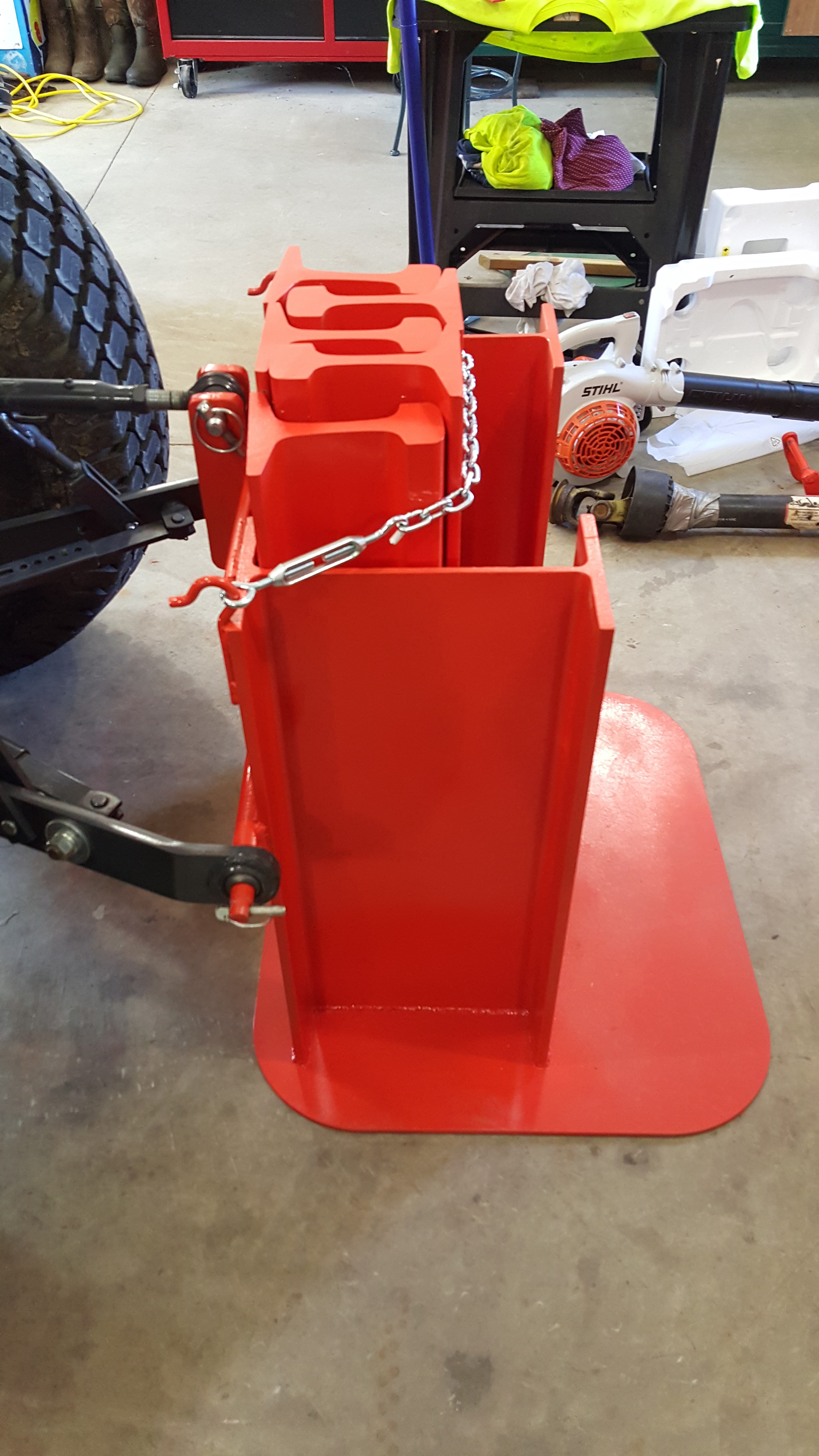

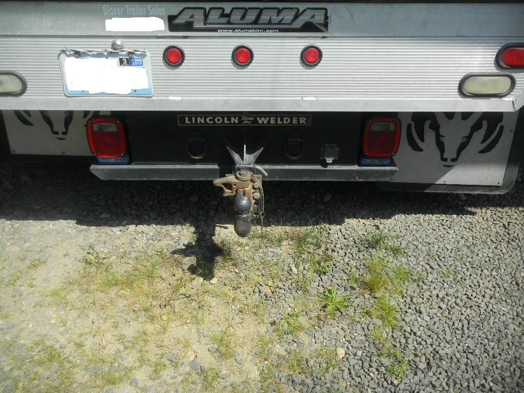

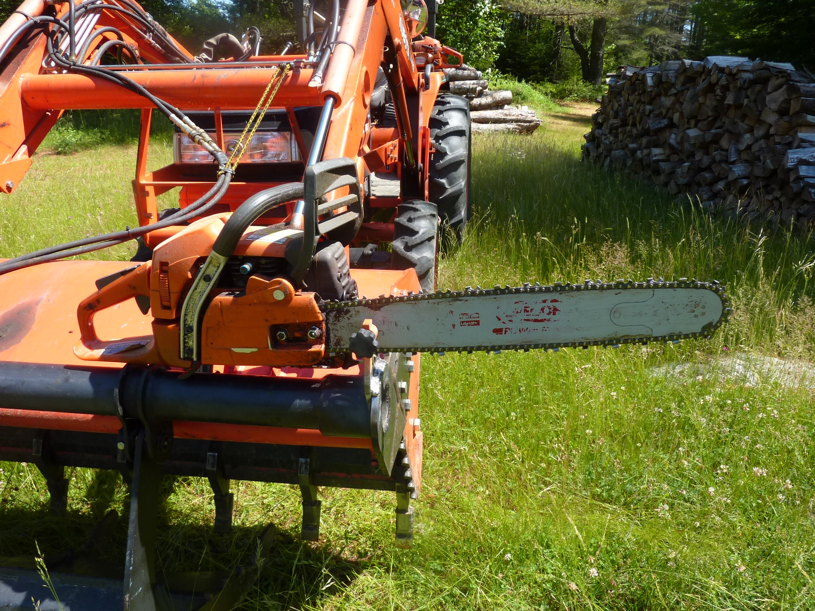

Good idea DragonEggs. There are some real craftsmen welders here. I am not one of them. I am more at the beginner utilitarian stage and trying to get better with practice. A couple small stick projects from last summer.
Chain Saw vise for filing in the woods

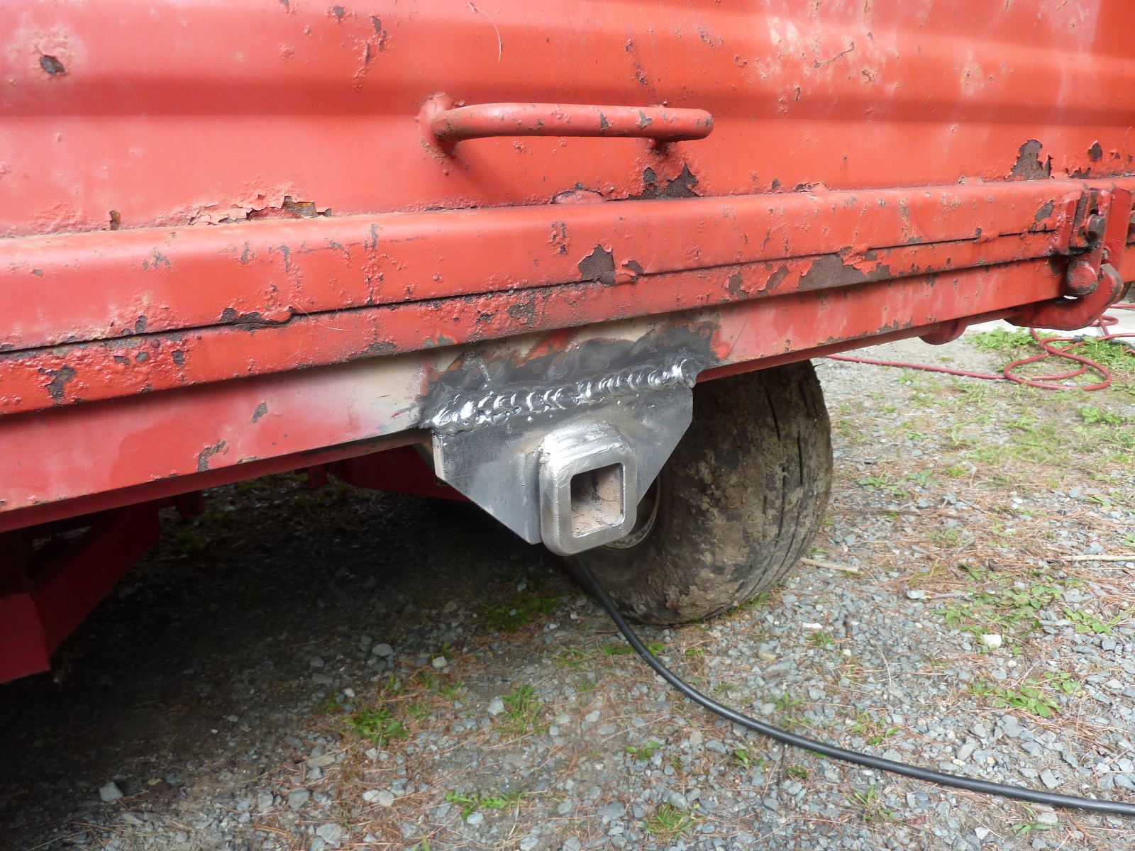

And a trailer hitch on my dump trailer so I can pull my wood splitter along too
gg

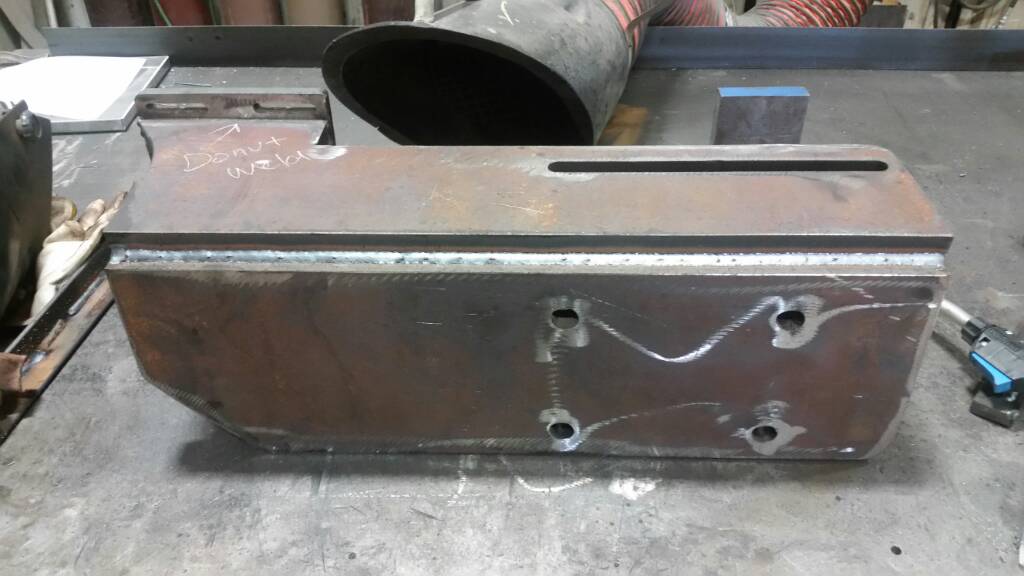

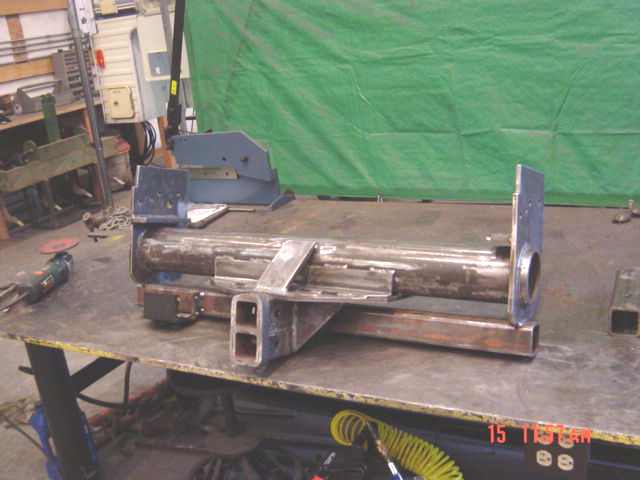

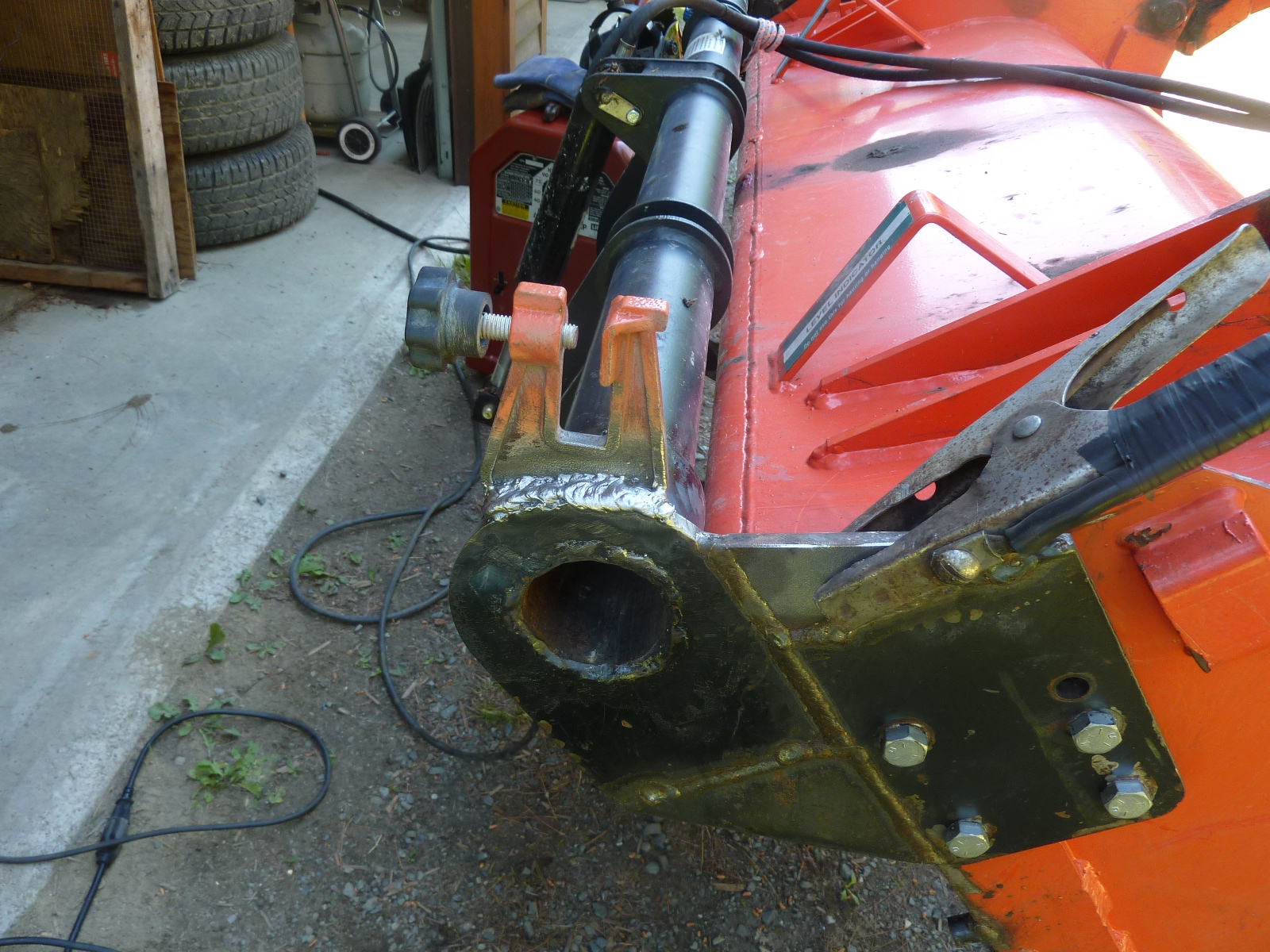

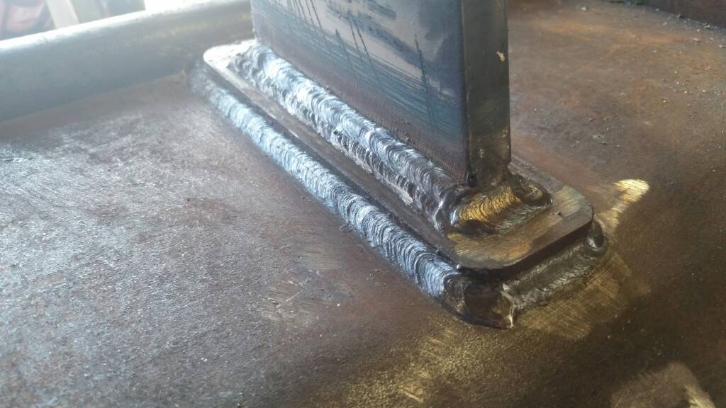

I can fill this one up from work here's some 7018 work I did on my bucket thumb recently.
/ Today's Welding time! #8

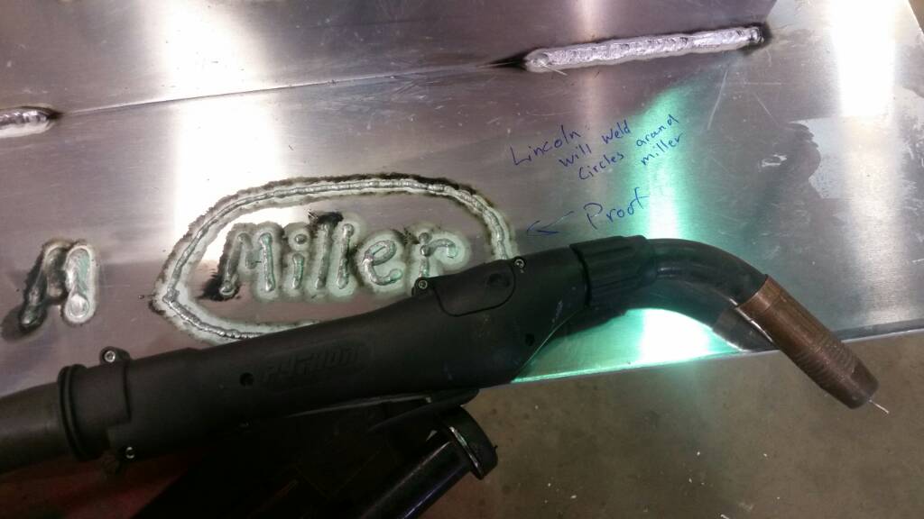

Little pulse mig on some heavy plate brackets.
/ Today's Welding time! #9
Joking around with the boys at work.

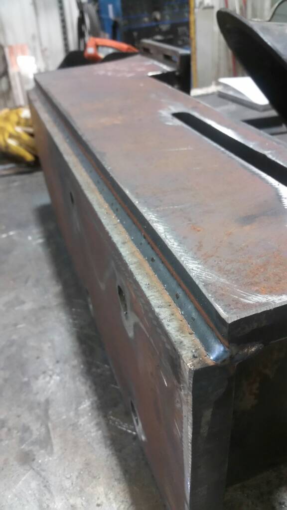

/ Today's Welding time! #11
What sort of amperage does it take for material that heavy?
And - is one pass like this sufficient to make a weld as strong as the material?
These were 3 passed and I was running somewhere between 200 to 250 amps with a lot of preheat of the plate first. It wasn't required to have 100% pen or be super duper strong they were that heavy in order to be machined after welding to be square.

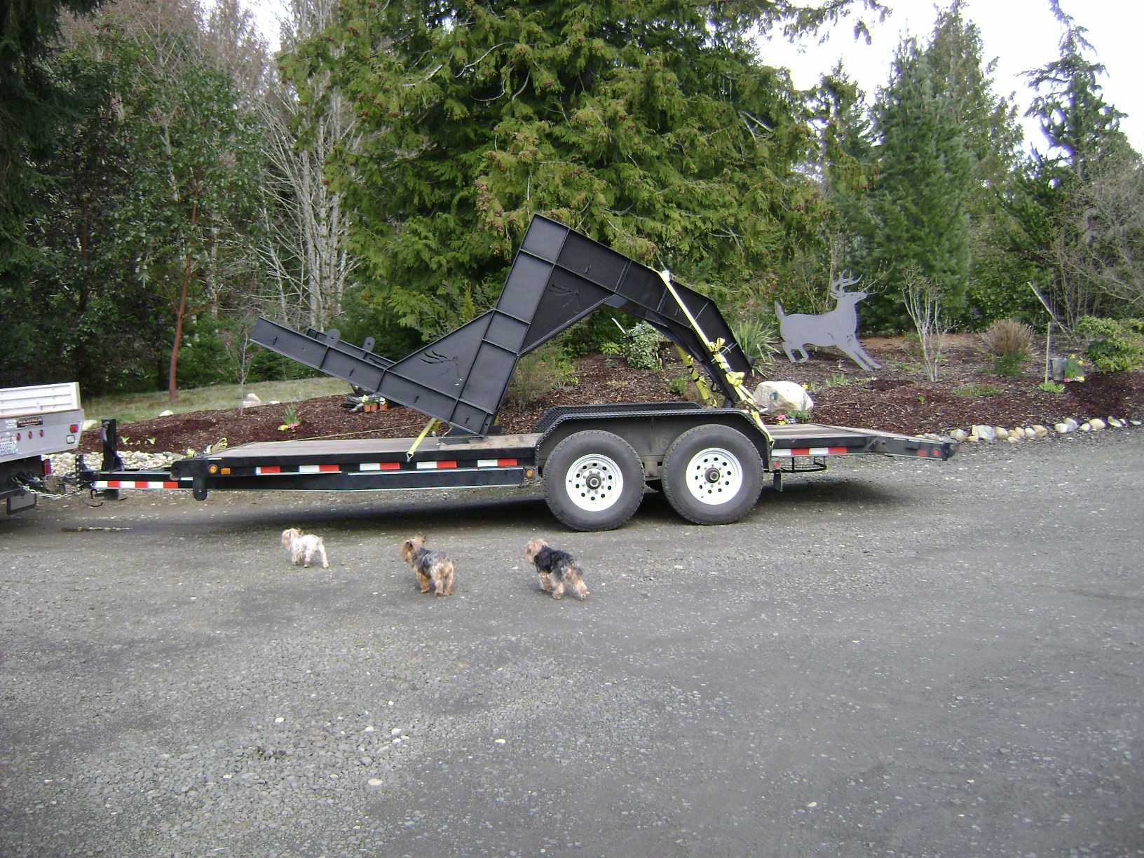

/ Today's Welding time! #17

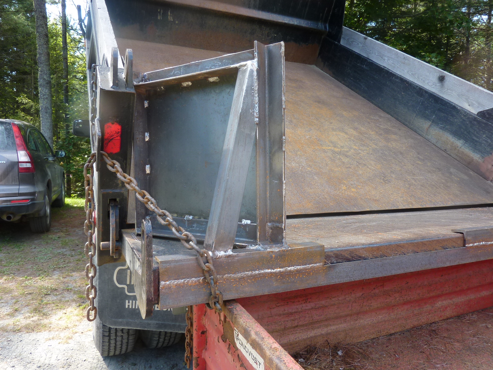

This was a fun project I showed before - a chute on my one ton tail gate so I could dump directly into my trailer.
It actually works pretty good
TrailerLoading - YouTube
