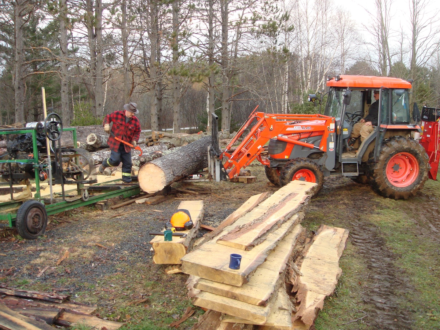

   / Too big for the mill...
#16
Jst,
The mill is a home made job. My buddy and another friend bought it. I supply the tractor for hauling logs and general mill work. My buddy is the guy in the plaid. The photos are from a previous session. We plan on removing the crotch section before milling.
In the close up of my buddy sawing... who can spot the design flaw with this mill?
He is sawing and selling some material and will replace the mill next year. It has its limitations. The price was right for us to begin with but we quickly found a major flaw within the first hour of milling.
Lots of fun... last year we milled enough material - which only put a dent in our pile of logs - for me to make a green house addition to my workshop.
Lloyd
Hmm, I see a couple. Guards in front and back would be nice if you break or throw a blade , the bed looks really light weight(especially if you are getting those big logs), and where is the tensioner for the belt?
I think I see the tensioner now behind the brace just above the log, but does this mill have a clutch? How do you stop the blade?
   / Too big for the mill... #18
Looks like you will not be cutting big balk's out of a log.:)
