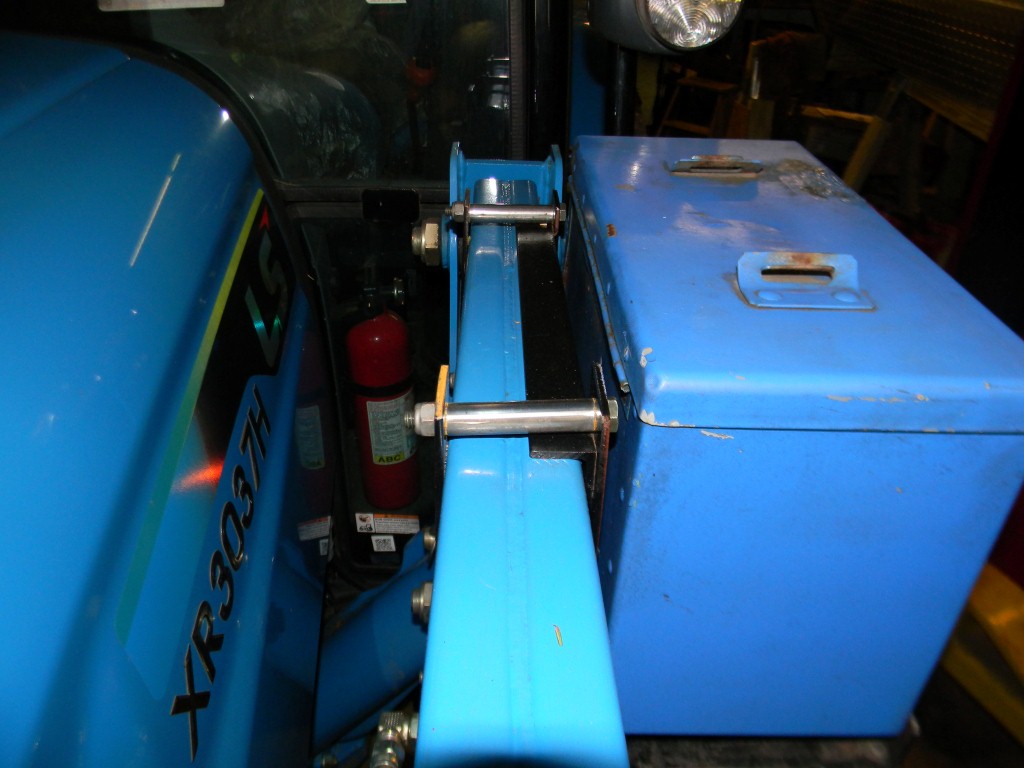

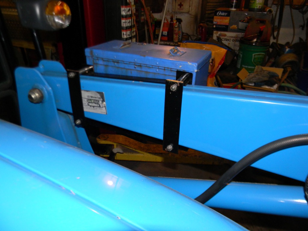

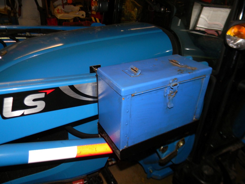

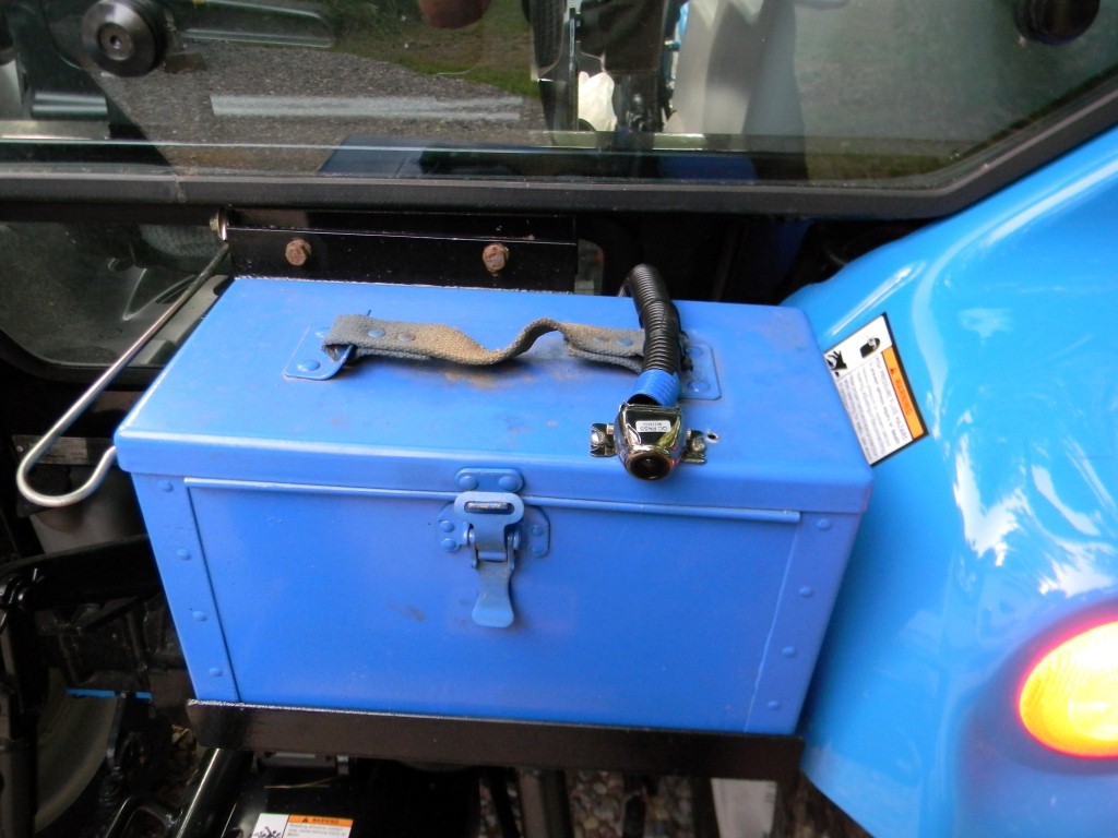

Originally I mounted a tool box on the back of the tractor. Bolt holes were already there and I thought it was a good place. Turns out I had to move it because it was too hard to get at the remotes to plug in or out.
I decided to attach the box to the loader arms. I put a piece of angle on top and bottom and welded most of my original toolbox bracket to vertical flat stock. Made two inside brackets out of flat stock and passed 4 bolts through round tubing to hold it in place. Pics attached of original location plus now on the arms.

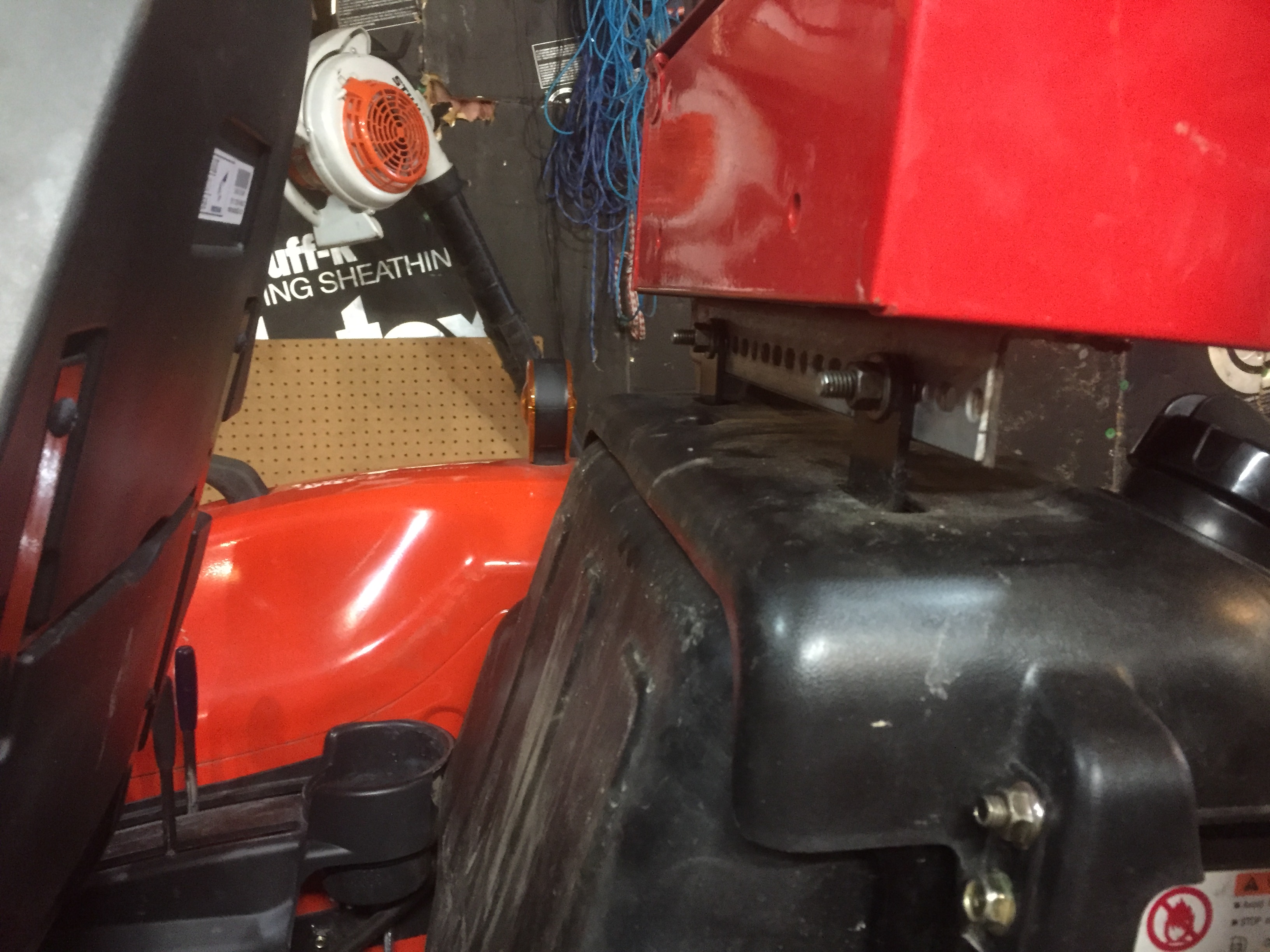

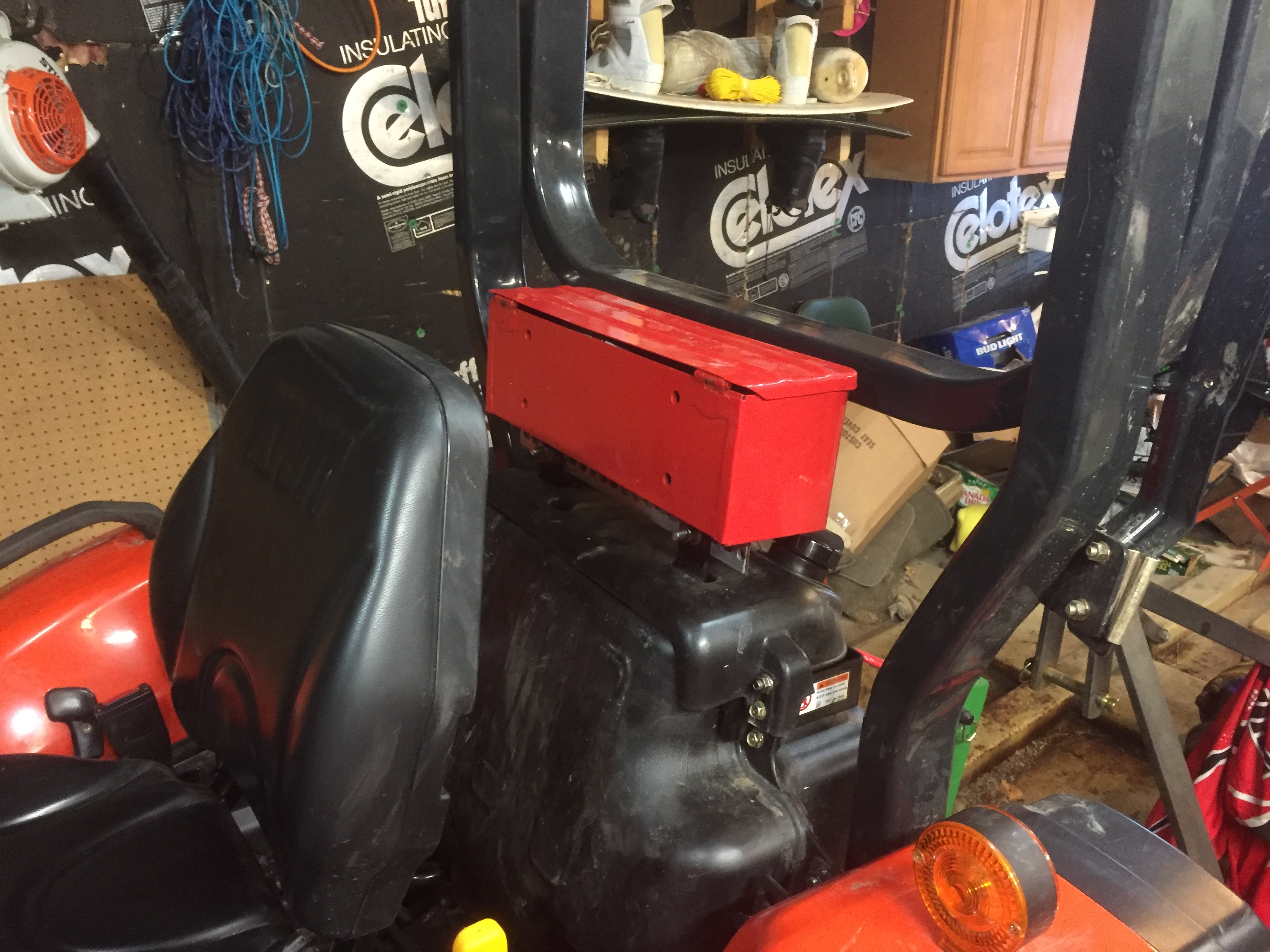

On my ck 4010 it had 2 brackets sticking up on top of the fuel tank. I mounted perforated angle to the brackets then mounted my tool box to the angle. It didn't affect the rops and has served me well.IMG_2743.JPGIMG_2744.JPGIMG_2745.JPGIMG_2746.JPG
