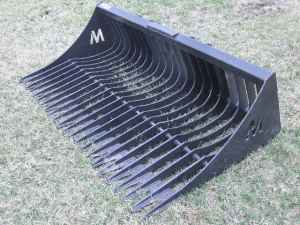

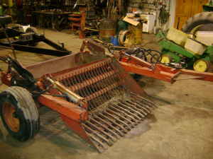

So...after failing with several tries using a power rake, tiller, York rake, other misc tools and even kids to pick up these loads of rock, I now see that there are tow behind rock picker tools (see attached).
I am now trying to decide between a used tow behind picker and a rock bucket (see attached).
The idea is to use the tool both for reclaiming this 1100' path (and re-using the rock on a new section of driveway), but then also use it annually to reclaim the rocks that inevitably get pushed to the sides of my 800' driveway (especially due to plowing activities).
I like the bucket idea since there are no moving parts to maintain, but am concerned about the amount of time that I'll need to spend with it to get the 1100' job done along with the reclaim work each year. I also like the idea of the portability of the bucket and the fact that you can "shake" the bucket using loader hydraulics to minimize dirt pickup. The big concern continues to be the amount of time it will take to use the bucket.
Any ideas?

   / Tool for picking up rock #14
I have not used either rock collecting device but based on my experience with other implements I'd go for the 3PT mounted drag rather than the FEL mounted sieve to do a project such as a 1100 foot driveway. That sort of work would be very hard on an FEL. I'd guess that the 3pt rock collector would be much more expensive though.

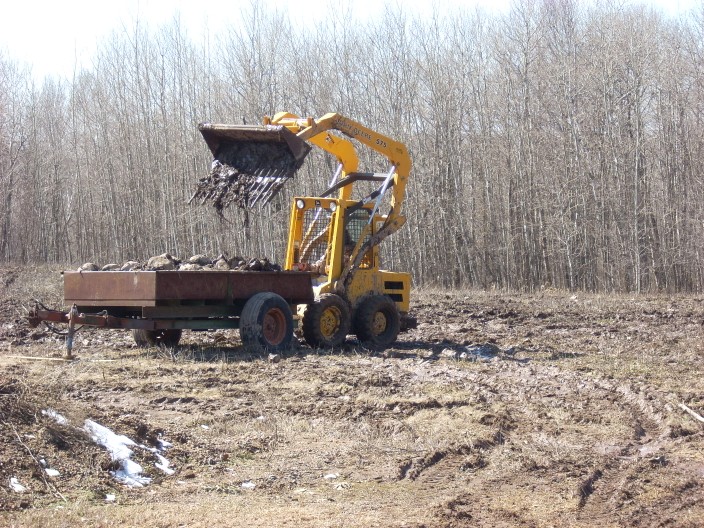

   / Tool for picking up rock #15
I have settled on a skidloader run by my brothers kid.
The bucket is a modified manure fork - welded on 12"-15" tip extensions. She spent the weekend in it and went home tired, muddy and grinning from ear to ear.
Also have a rock bucket similar to your picture but with a grapple. Tines are too close together heavy clay/sod will not drop thru. 6" spacing works better but is easier to bend. Other problem is tractor hood blocks sight lines for smaller rocks >500lbs.
I have a tow beside melroe type picker for sale if your interested.
#16
The rocks that I am looking to pick in the 1100' temporary drive are only 3". There isn't any vegetation there, only the rock. Six inch tine spacing won't do me much good there.
Sadly, the rocks that I would be clearing annually are mostly going to be only 3/4". I expect that the drive edges will eventually be lawn, so am half hoping that an angled York rake will pull the rock up out of the grass without dropping earth onto the drive.
FEL wear is an interesting concern - can't say I thought of that one. I wouldn't expect to be doing this work at any appreciable speed (likely 1mph or less, really, especially for the 1100' run). I imagine that would help on the wear.
   / Tool for picking up rock #17
I tried using a rock bucket to essentially "mine" the rock out of about a 40 yard pile of dirt with many many rocks in it, maybe 10" and below.
While I got about 3 yards of rock out of it, I decided it was not worth the effort and will willingly pay the $15-20 per yard for trucked in rock.
The main problem is that if the dirt is dry enough for the rock to separate easily it forms a huge cloud of dust with you and the tractor right in the middle.
A second problem is that shaking the bucket to separate the rock from the dirt looks to me to be very hard on the machine.
In your situation, I would far rather scoop up the rock dirt mixture and use it for very deep road base somewhere else, adding more base rock and then gravel on top of it. Then import topsoil. Not the least expensive, but I decided my lungs were not going to take sitting in that dust cloud for weeks on end.

   / Tool for picking up rock #19
. . . I now see that there are tow behind rock picker tools (see attached).
For your application, I think the rock picker might work better. It will shine on large flat and consistent areas with baseball to football size rocks.
The rock bucket is something you can use on hillsides and gulleys. It allows you to dig and pry out large rocks as well as small ones. I consider it a more flexible tool for that type of work. The picker would be no use at all on these jobs.
