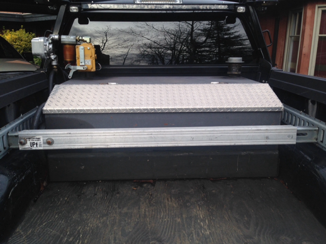

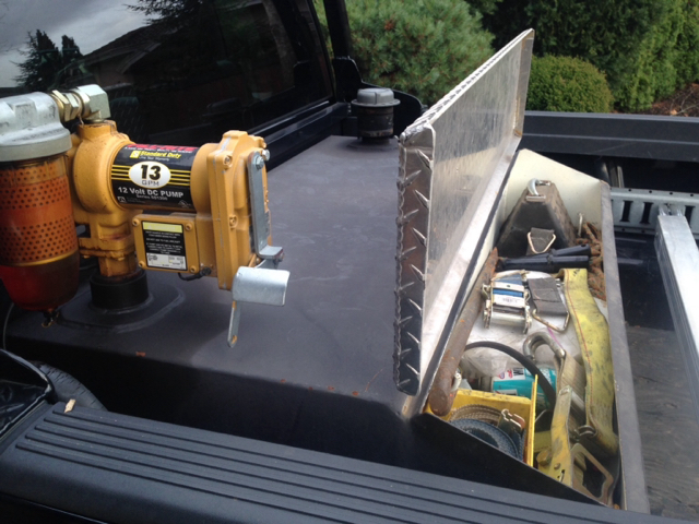

I needed a low profile combo for my F150 step side. For aesthetics I wanted the top of the tank to be below the rear window. Had to fab up my own.
10ga. steel construction with 3/16" aluminum diamond plate lid for the tool box. 85 gallon tank with baffle. 12v pump with filter and digital meter and auto shut off nozzle. There's a remote switch to disable power to the pump.

I like that, really nice! LUTT

Wow! If I was as good in the shop as you I would probably do the same. Looks great!

Thanks Kyle, but I can't take the credit for this one. I didn't have the ability to (easily) shear and brake the 10 gauge sheet so it was easier to just farm out the entire job to a local shop.
Plus this was eight or nine years ago when we were all busy and actually MAKING money. :)
Terry
