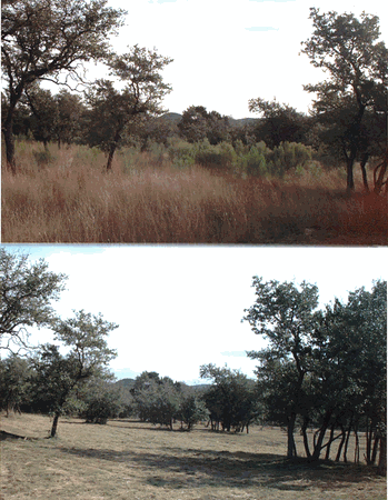

I have been using brushcats since they were first introduced. I wore out my first one and I am on my second. I use it to finish a property after I have sheared, chipped, grinded and moved of the chips. I have a lot of low live oak branches to avoid. The height of the skidsteer, the beating I take, and the fact that is has to skid to turn, make me really try to avoid mowing anymore. I just don't like the driving around all day. Just not comfy anymore.
here's a pic of a typical brushcat job.

Could you accomplish the same result with brush hog on your tractor?

I started out using the tractor to finish my jobs. I used a JD 35 hp 4wd. The brushcat mows lower and with the steel roller stays in contact with the ground. Having it out in front makes it easier to get right up to trees and it is safer than trying to duck under trees in a high profile tractor. I also have quite a bit of reserve power with the brushcat though it has had its share of problems that bushhogs do not.
Also, I have yet to run a bushhog that does as fine of a mowing job as the brushcat.
