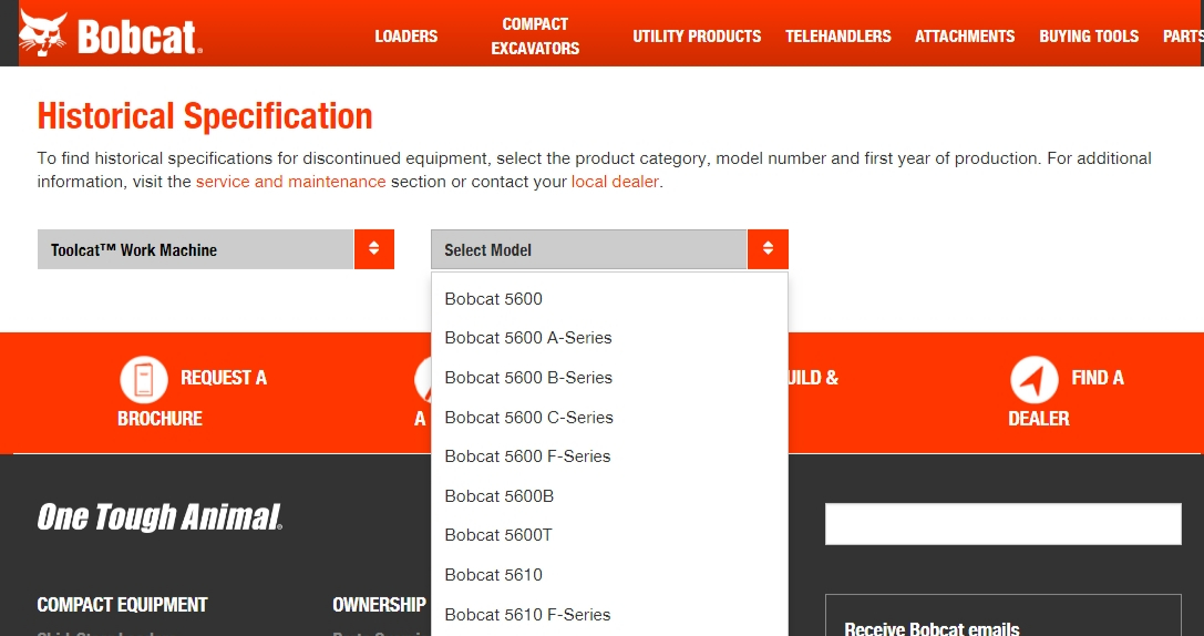

And from the Bobcat Website showing model numbers: Bobcat Historical Specs - Bobcat Company

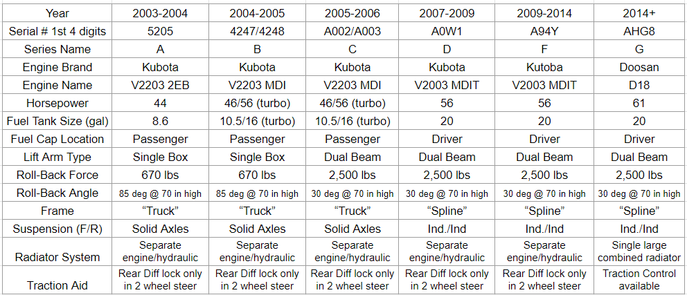

/ Toolcat Years and Major Features #4
I'm putting together a Toolcat history/buying advice video so I used info in this thread and elsewhere to get a more complete comparison chart (I'll post it in my video thread later this week). If I'm wrong somewhere let me know. In addition to bobcat historical specs webpage I used the bobcat online parts catalog to confirm changes. Many changes not listed, this is high level obviously.

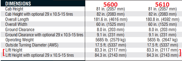

What about differences in lift height?
This was for the F:

Have any info on the 1st gen boom arm lift height, anyone measure one? I haven't seen any info on any lift height changes over the years. I've seen the roll-back/bucket tilt changes and the lift capacity with no counterweight change from 1300-1500lbs from the early series to the later ones.
According to my research there was never a diff lock available on the D (A0W1) or F (A94Y) series. All Toolcats with independent suspension have Torsen style limited slip differentials, with no locking diff option. Traction control was optional starting with the F series after serial number 14000.

my 2020 has traction control, independent suspension and no switch for diff lock,
