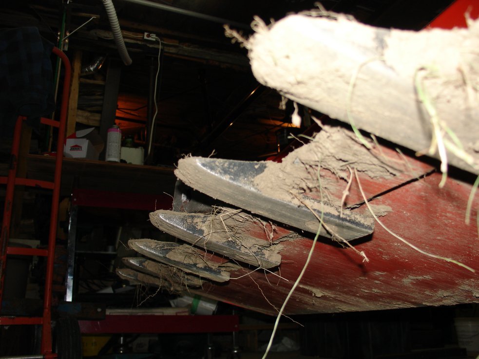

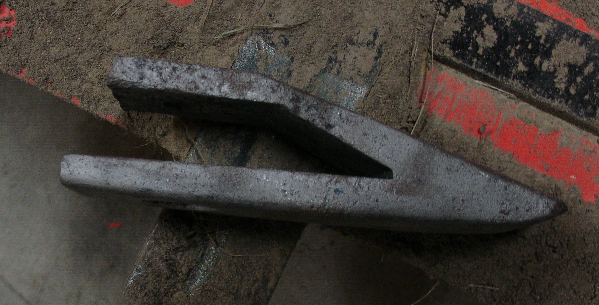

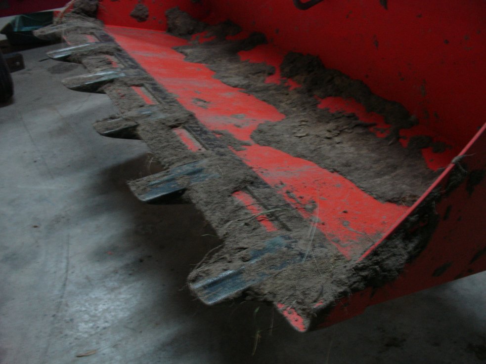

I went to visit a friend who have a big excavator and he was changing few teeth on is big bucket, so he give me 6 of them and look what i have done with a flat bar and 2 bolts.
What keeps the teeth from twisting under when you pry up with the bucket...
What you made looks very weak...

The tooth have a V shape so the flat bar and the buck fills it. Those are coming from a thicker bucket so by adding a flat bar the tooth does not move at all. Up to now i did not break any. It works great and makes the deference in digging.
You are right Kevin, my set-up his week if i pry down i will loosen teeth or break, but it is for bx bucket.
