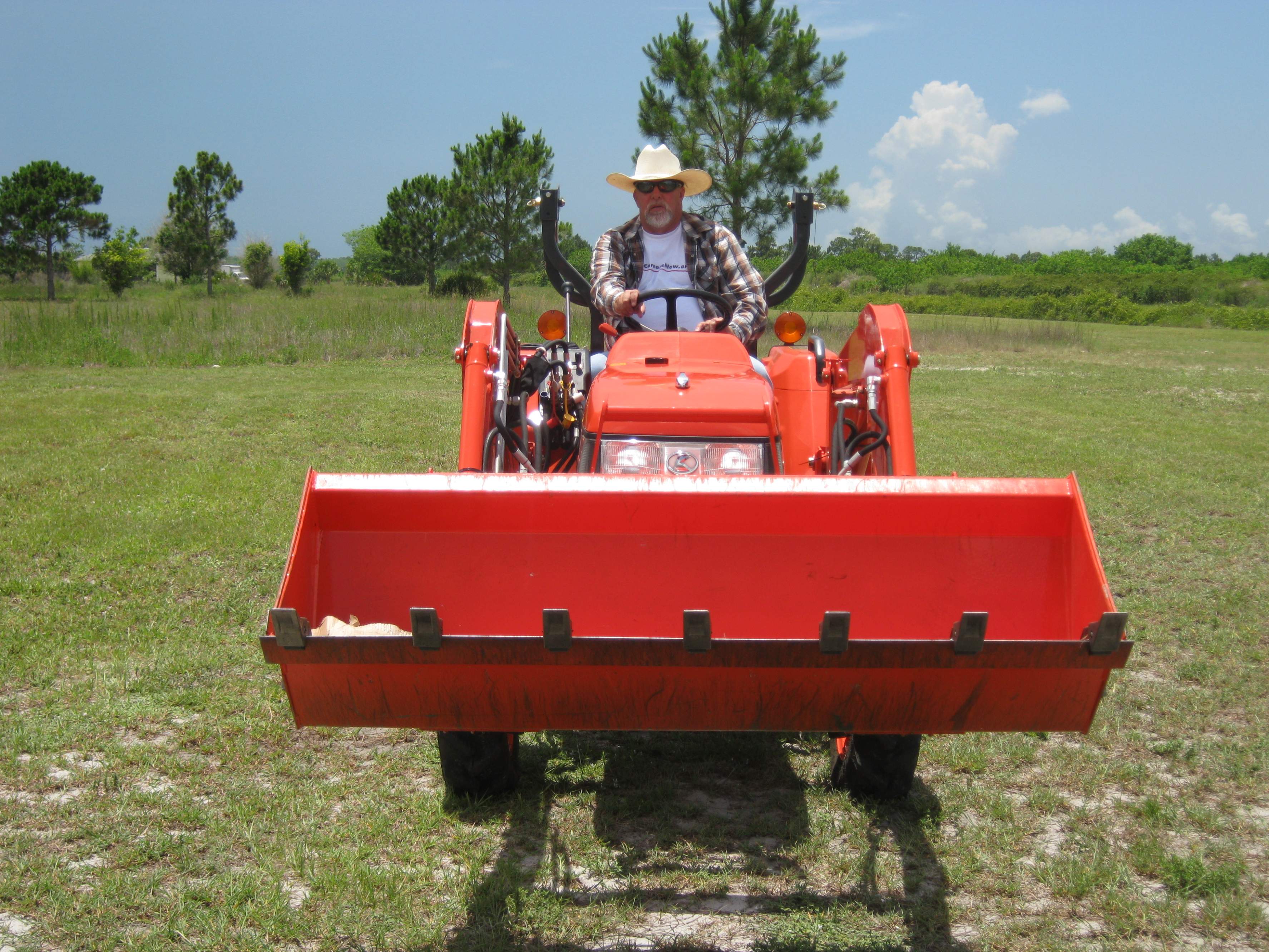

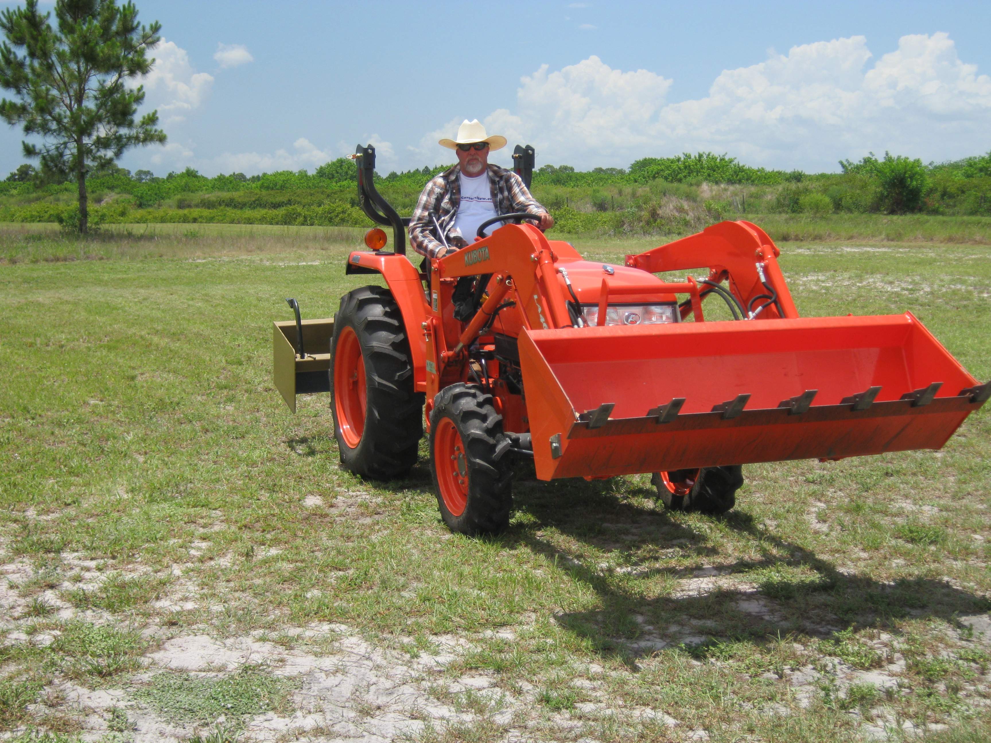

Sounds right to me,my 64 1/2 incher from inside has 7,but then again do they make different size(width) teeth ?
Boone
