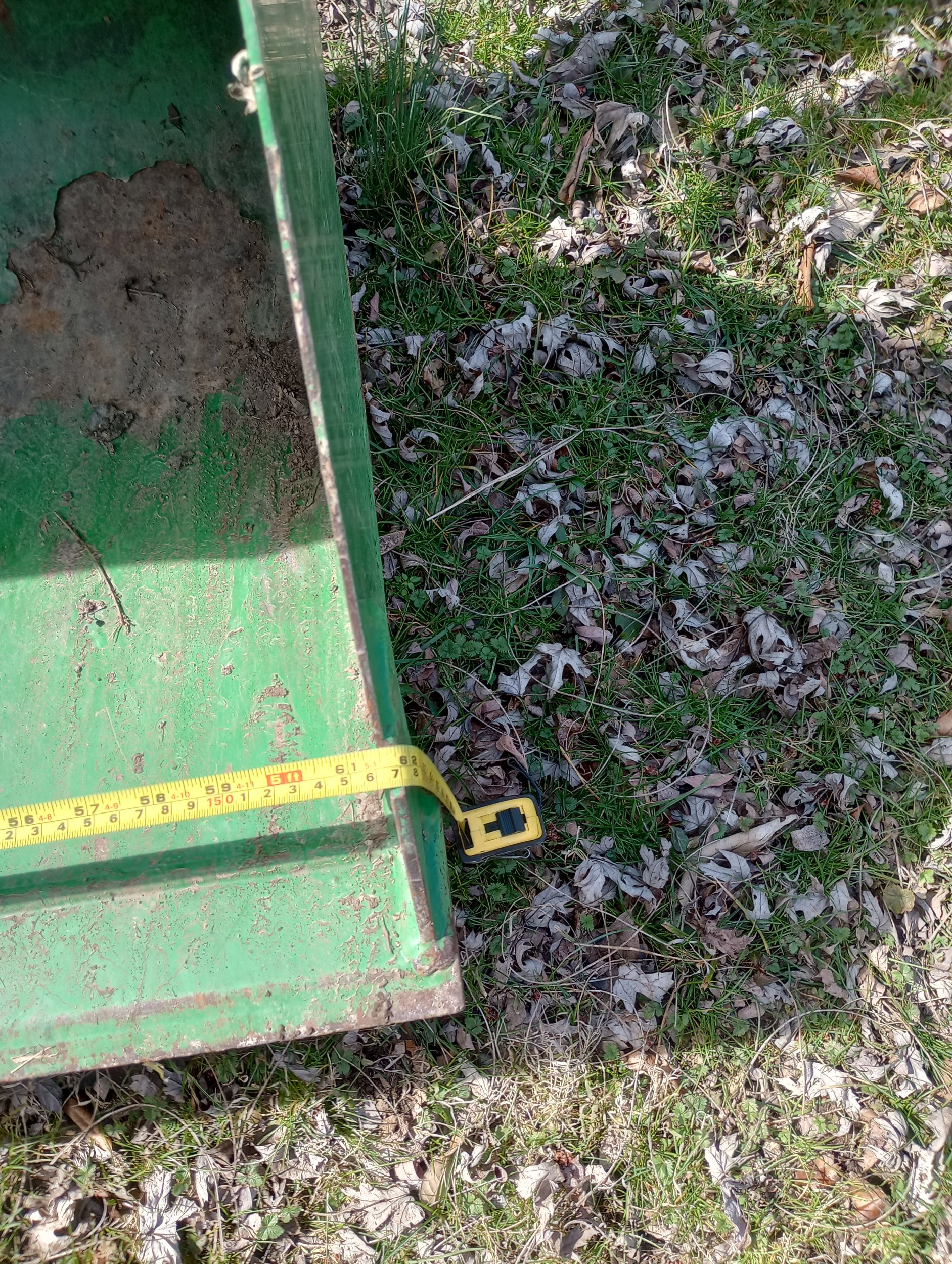

I'm not sure what size I need for loader and want clamp on I was told 60" too long
   / tooth bar #2
Ive seen several tooth bar manufacturers give specific instructions on their websites about how to measure for their tooth bar.
   / tooth bar #3
Looks like you have at least 61 1/2" on your bucket. This place has bolt on tooth bars in 1/2" -1" increments.

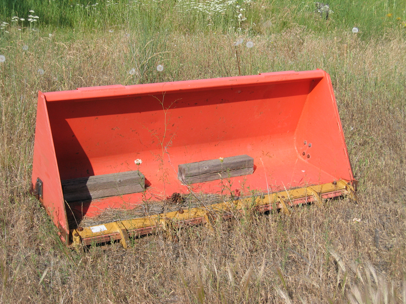

Most tooth bars go from inside edge to inside edge of the existing bucket. They either clamp or bolt to the lip of the bucket. Mine is made by Rankin and I bolted it to the lip of the bucket. This is not the best picture in the world BUT........
Look closely. The tooth bar is yellow. There are four bolts holding it to the bucket lip. There are eight teeth on this tooth bar.
