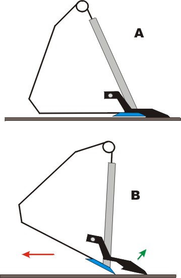

I have my ideal operation of a tooth bar shown in the attached diagram. In the next post, I talk more specifically to its features.

/ tooth bar #16
Re: tooth bar and cutting edge
Here is the image from the last message shown so I can discuss it.
My bucket has the bolt-on cutter bar shown in blue. I'd like to put on a toothbar that would seat against the cutter bar as shown in diagram "A" (I drew it on the outside, but actually the toothbars bolt to the inside of the bucket.). When I would backdrag, as shown in diagram "B", the toothbar would rotate up and away from the cutting edge. Have you ever seen one that works like that, John? I may be wishing for too much here, but you gotta start somewhere./w3tcompact/icons/smile.gif

/ tooth bar #17
Jim
On dozers and the such they have "root rakes" which bolt on the top of the blade and like your design work going forward then in reverse you can back drag.. I believe you got something there that would work.
JimI,
I like your idea of a the modified toothbar (which john4nh called a "root rake"). Actually I would like to a design that would pivot the way you described and would be able to lock. I found the teeth on the toothbar to be great when backdragging with the bucket for a rough distribution. If you move fast enough backwards with the teeth pointed partially down, they (the teeth) combined with the cutting edge sitting a couple inches higher quickly distributes the material very evenly. I learned this trick from a guy who had a concrete business and used a skidsteer for distributing gravel.
In the absence of the design you proposed I end up backdraging with the teeth rotated up and use the back of the bucket for final smoothing (I think the NH manual recommends using the back of the bucket for backdragging).
Just my 2 cents...
Your idea, in theory and on paper it looks great, but in real life it may not be practical…
With the toothbar, having multiple steel shanks shaped and form fitted over the bucket’s cutting edge, this makes it a cohesive unit as a whole assembly… it’s much stronger.
Lacking the correct engineering terms to express myself properly, it’s like the difference of someone hitting you with an open hand or someone punching you with their fist… it’s the same hand used in both examples, and the same mass doing the striking, but the clenched fist is stronger and will do the most damage.
Besides, it’s only two bolts holding the toothbar on, you need to remove…
Hey, that’s why God invented boxblades and rear mounted blades… just for that “smoothing”purpose… /w3tcompact/icons/wink.gif
If you had different shaped shanks {without the bottom lip as in your picture}, yes it will work, but I don't believe it's certainly not as strong as the original intended purpose.{aggressive ground digging}
It's one of those things... you'd just have to prove out for yourself and see if you're happy with the results...
John and DaveV, I defer to your expetise on this one. You both make such valid points that it's hard to think of any argument. I'd say that just because I can draw it, it doesn't mean it will work "where the bucket hits the dirt." The idea of a rigid single unit makes good sense, and using the back of the bucket to backdrag is also a very easy "fix" for not making ruts. As a matter of fact, having the blades rigid might make it possible to scarify on backdragging and then dig going forward. Thanks for your thoughts and advise.
