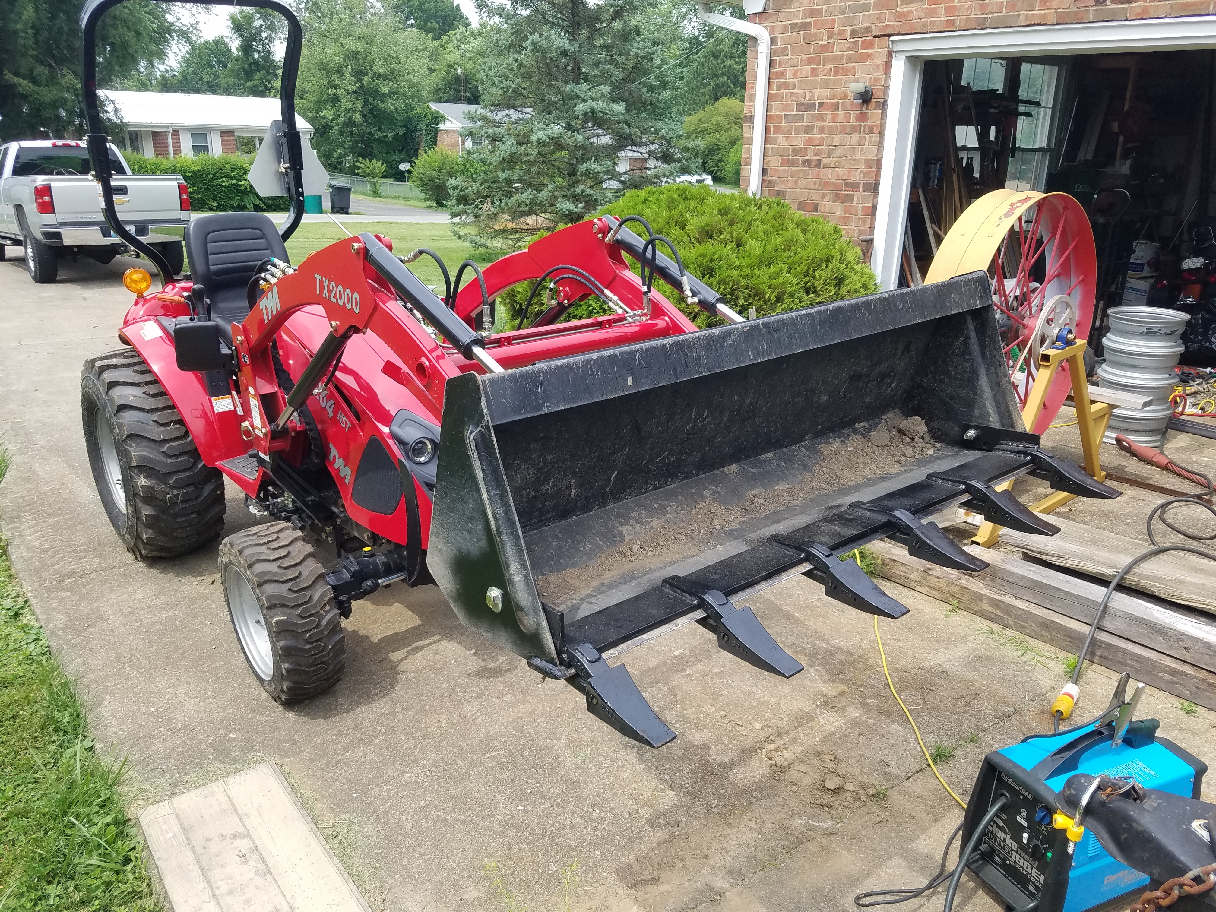

I like my toothbar. It is usually off. Very easy to remove but 50 lbs to lift when installing, only one bolt per side. My buddy borrows it about twice a year. I wouldn't want the extra expense of another bucket but I'm limited on space also.

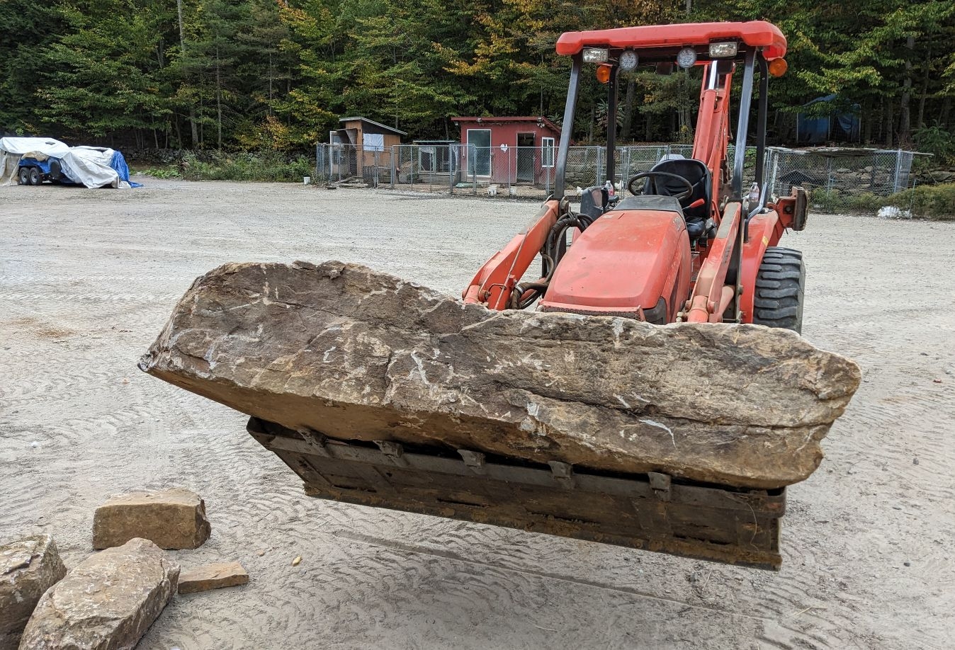

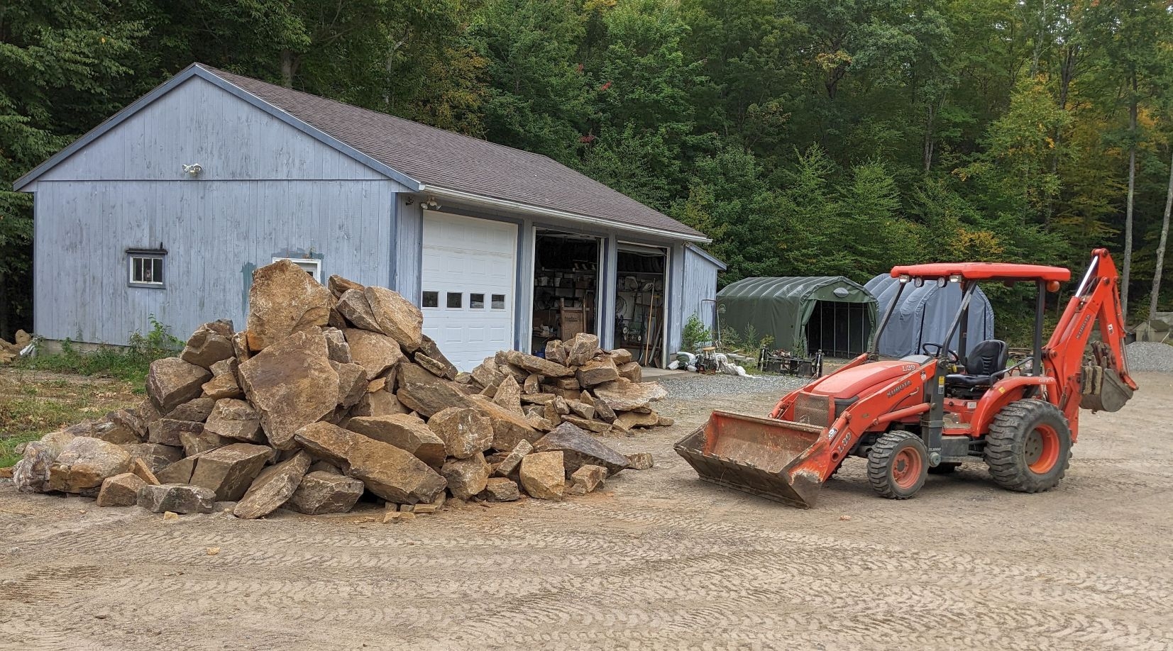

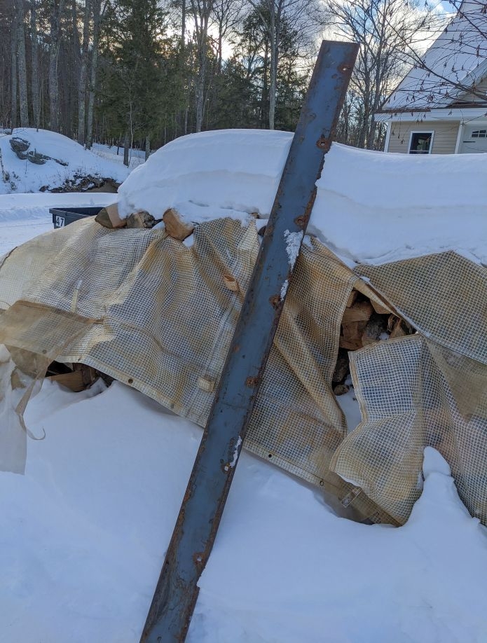

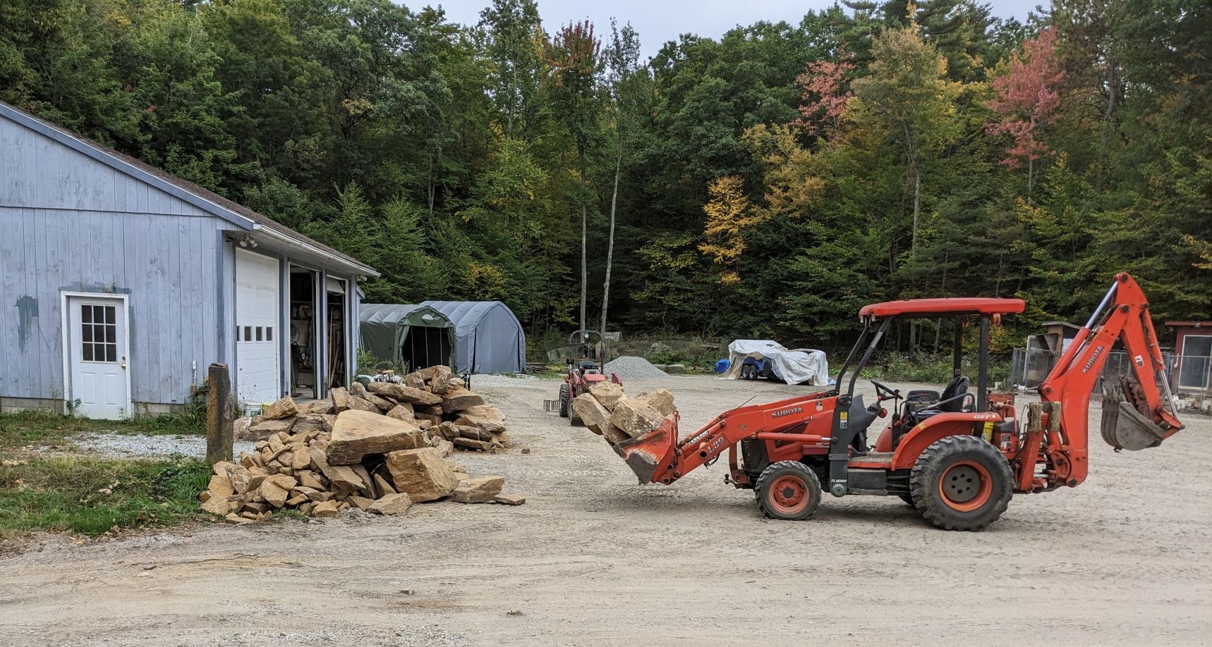

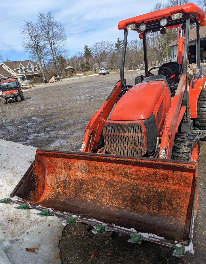

$1,000 Later. My original toothbar lasted about 18 Years, +2,000 Hrs., before I broke it moving these boulders in photo. I bought an extra cutting edge when I installed the first set of teeth and adapters way back when. I shudder to think what Kubota gets for them now. The teeth never failed, it was the cutting edge that wore & cracked. I spent the extra money to buy genuine ESCO teeth and adapters. They are not cheap, over $400 for the little set.
These are way better than CAT teeth, etc. however.

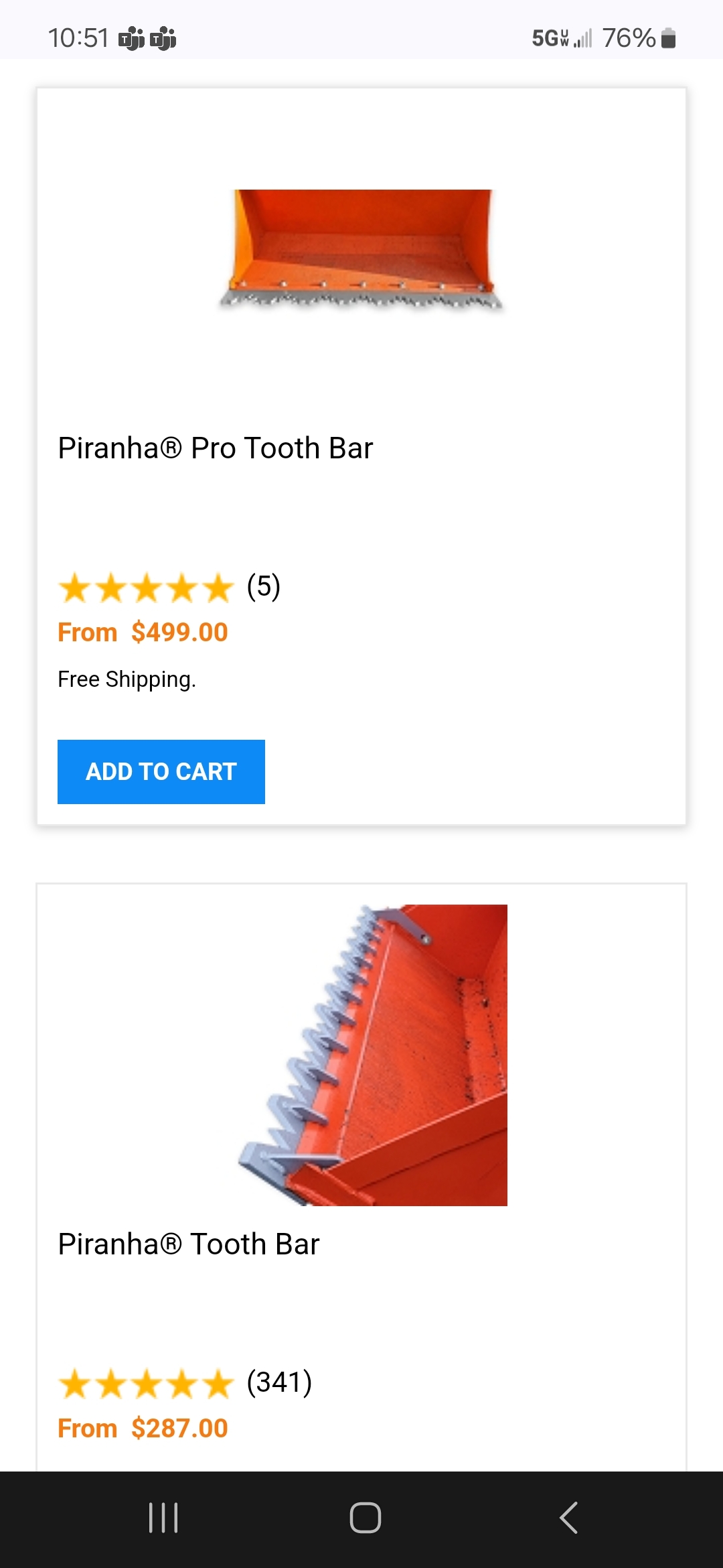

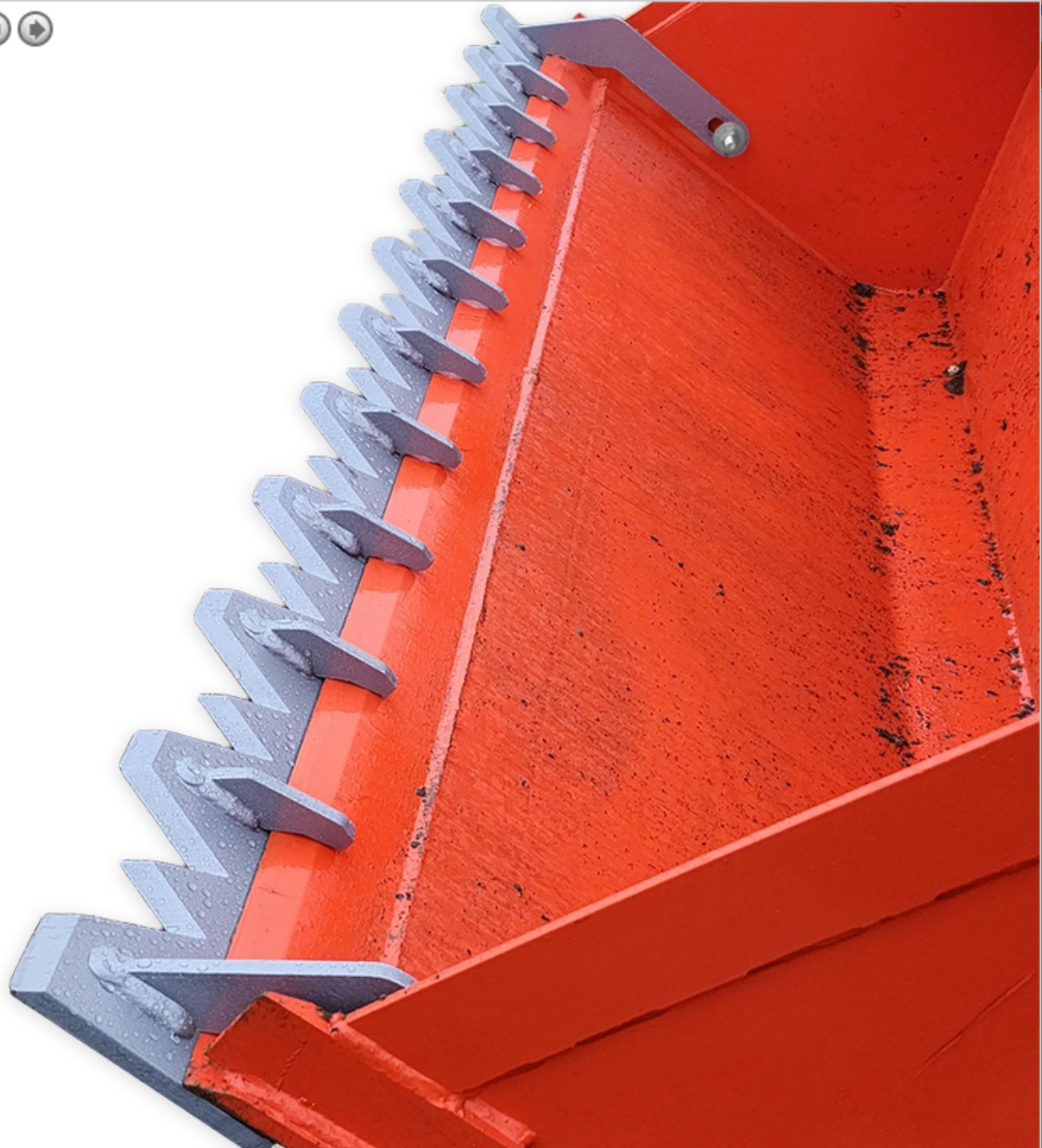

I wanted to point out that the Pihrana bar comes in 2 types. The original with just 2 bolts in the side of the bucket and the Pro, which bolts across the front edge of the bucket. This may be why some thought it was more work to remove than others. I have a Kubota L3130 and the loader bucket has a straight bar bolted on already, so I could use the Pro, just not sure the extra cost is worth it. Am not a heavy user, so durability not really an issue.
