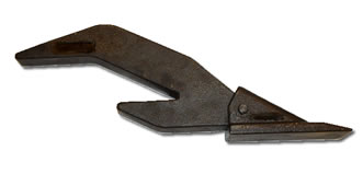

Markham is out, they don't answer phones, return calls or e-mails. So I am looking into making my own. Now has anyone have any experience with either of these teeth?
the A-175-1 or the case 23 series picture shows the shank only.

Okay, I can buy teeth....now I need help with the cutting edge. Should I cut the angle with a torch. These days I am getting some very clean cuts with the torch using tricks from a near by welding shop.
Are these edges readily available?

Melissa just got back to me via e-mail. She apologized for the mix up. I am still making my own since the teeth just arrived and she said she could get me the cutting edge if I need one.
/ Toothbar tooth selection.
#19
I ordered 8 teeth for $175 with shipping
Cutting edge from ebay 1/2" x 6" x 80" for $58.40 includes shipping
$233 total materials and shipping
I will weld it up and take a pic.
