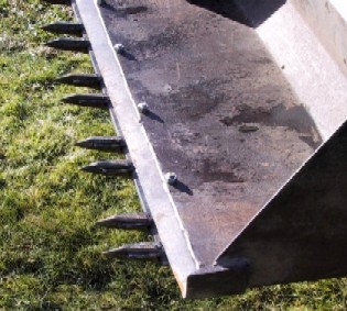

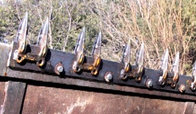

Years ago, being cheap, I bought some hardened (German-made, surprisingly) combine teeth, some steel bar, and welded up a tooth bar for my 48" bucket. Very useful for those things that toothbars are good for, like ripping up brush, loosening soil, etc. I posted photos back then, maybe someone will find them interesting again? The only thing I'd change is moving the fastening bolts to the ends.
Those look like rock guards from a sickle bar mower!
