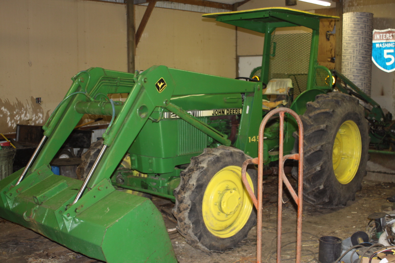

I put mine down point to the ground. This does two things... It keeps the contact area with the ground to a minimum, and it keeps water (and ice) from building up in the bucket.
:D:D:D:D:D:D:D:D:D:D

Oh yea verily do tilt the bucket so it empties... However putting the cutting edge to the ground does not eliminate pulling a frozen-on piece of the world up, it just sort of minimizes the size of the piece (at least in some of our raining/snowing freezing situations.) I have a scrap board on the ground where I usually park the tractor and rest the blade edge there. On the occasion that the board freezes to the blade I can just curl the bucket while board is in contact with the ground and it comes off.

I've always thought the board idea is a good one. I've never thought about it, though, when I'm parking the tractor.
I do occasionally have to curl the bucket to crack a piece of ice before moving. The tip down makes is so that rather than overcoming several square feet of ice I'm only working with a few inches.
