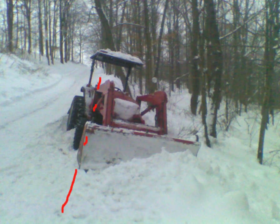

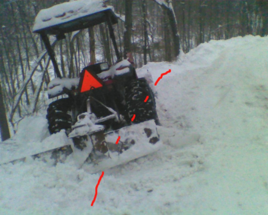

Oh yeah. Don't take your eyes away from the front too long, no matter how curious you are about that leaning tree and wondering if it needs cut before it falls!
Don't forget where the edge of the road is. Snow can hide these little details.
Sometimes a big pile of snow can save your butt! Kept me from sliding down or rolling down the hill.
An angled rear blade can push the front end to the side.
Know when to shut it off and call for a tow! This is the first and only time I have called for a tow with this machine.
Hooked a 20' strap to the right bucket hook, over the top of the bucket, to the hitch on the 4Runner to pull and tip the tractor back up on the road.
Wrapped the strap loop over the hook, then routed the strap so it would be over top of the loop and hold the strap down on the hook and towball.
The more I tried to move the tractor, the more it slid. Ended up dragging the front up over the edge before I could safely (?) engage the tractor wheels.
Here are some pics. I've marked the edge of the hill and the slope in one pic. I have several decades of experience on various equipment, but it only takes a few moments of lack of concentration to get into trouble. Learn from my stupidity! :ashamed:
- JC
