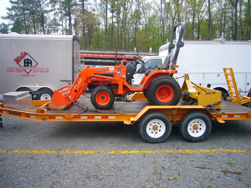

I bought mine as part of a package deal, tractor box blade, trailer back in April 2009. All the equipment was 2007.
Seems to pull fine.
Only two minor complaints
The 78" between the fenders was a tight squeeze for the M4700 I bought in 2013.
I should have planned ahead in 2009 :)
And it only has 2 stake pockets on each side, none in front.
