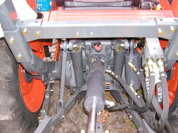

We have the OEM Kubota TNT setup on our L-3130 and it works excellent for all the above mentioned purposes.
You ask "How useful?"
On a scale from 1 to 10, it rates a 10+.
Sure is sweet! /forums/images/graemlins/wink.gif
