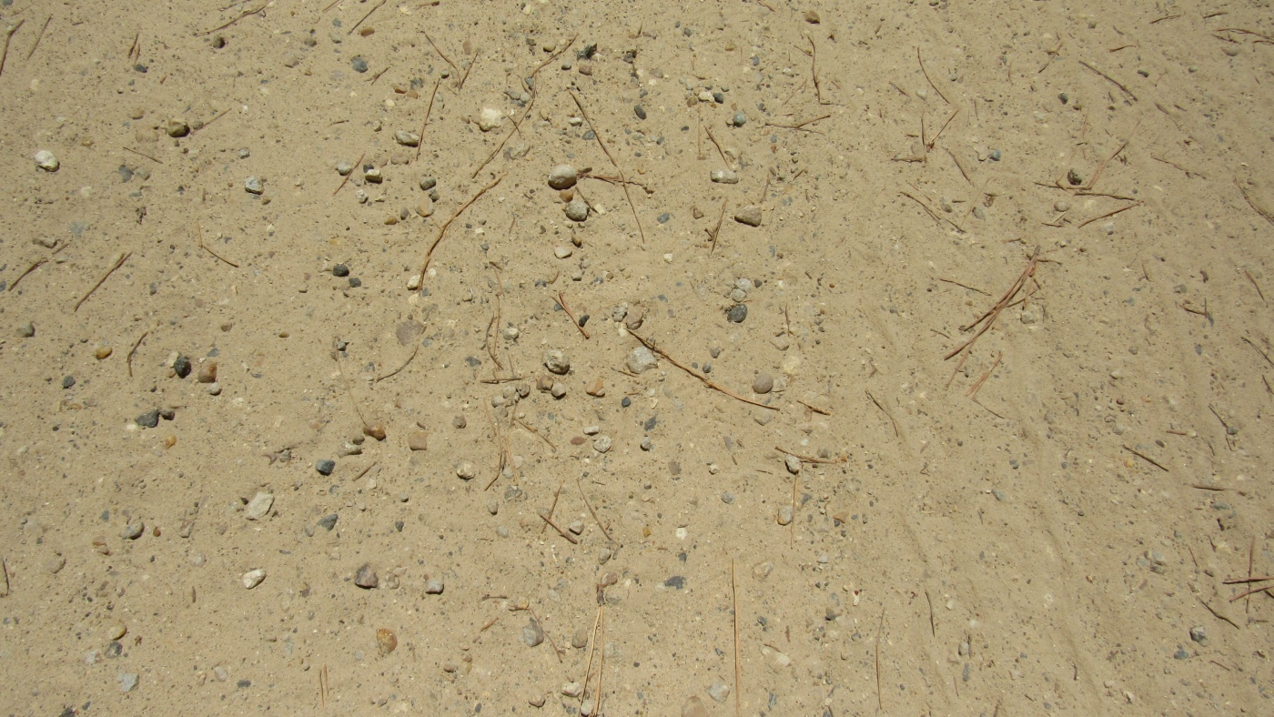

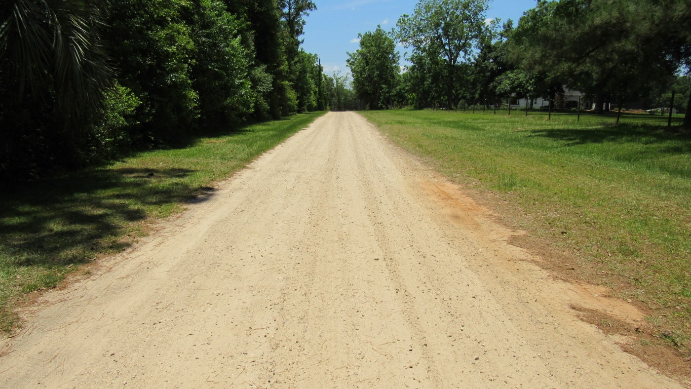

Opinions seem to vary depending on how it's graded and who you buy it from. I bought some 3 years ago from a paving contractor and it has been great. It was screened to no larger than 3/4" and I haven't seen ANY metal in it. It has required very little maintenance and when it did it was easy to churn up and fill any holes or washboard. The older it gets the less maintenance I have had to put into it. The stuff I bought was dang near $21 a ton delivered and the last time I priced it they wanted more.
The company I bought from had trucks with auto tailgates and drivers that knew exactly how far to open them and how fast to drop depending on how thick you wanted it. I wanted it 4" thick. They would have a small pile at the start of the drop and the rest of the truck load would be a perfect 4" thick
I did find another source selling for $11 per ton but they don't deliver so I would have to pay a separate company to haul. I haven't gone to look at their product either.
I have looked at some from a third source and I wouldn't touch what they had with a 10 foot pole.
I just took these photos last week. All the fines have come to the top.
