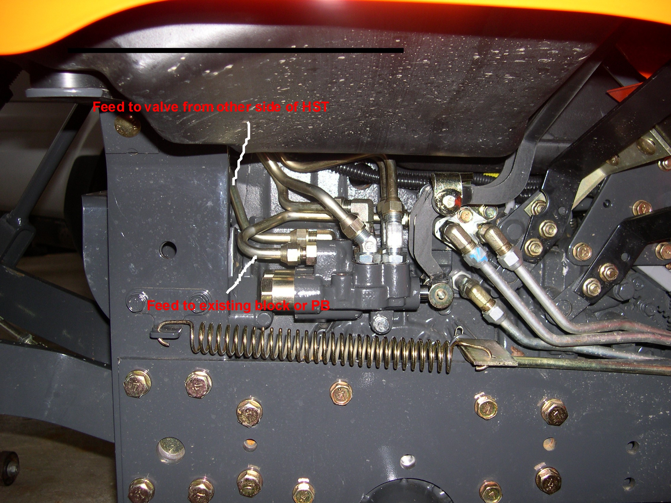

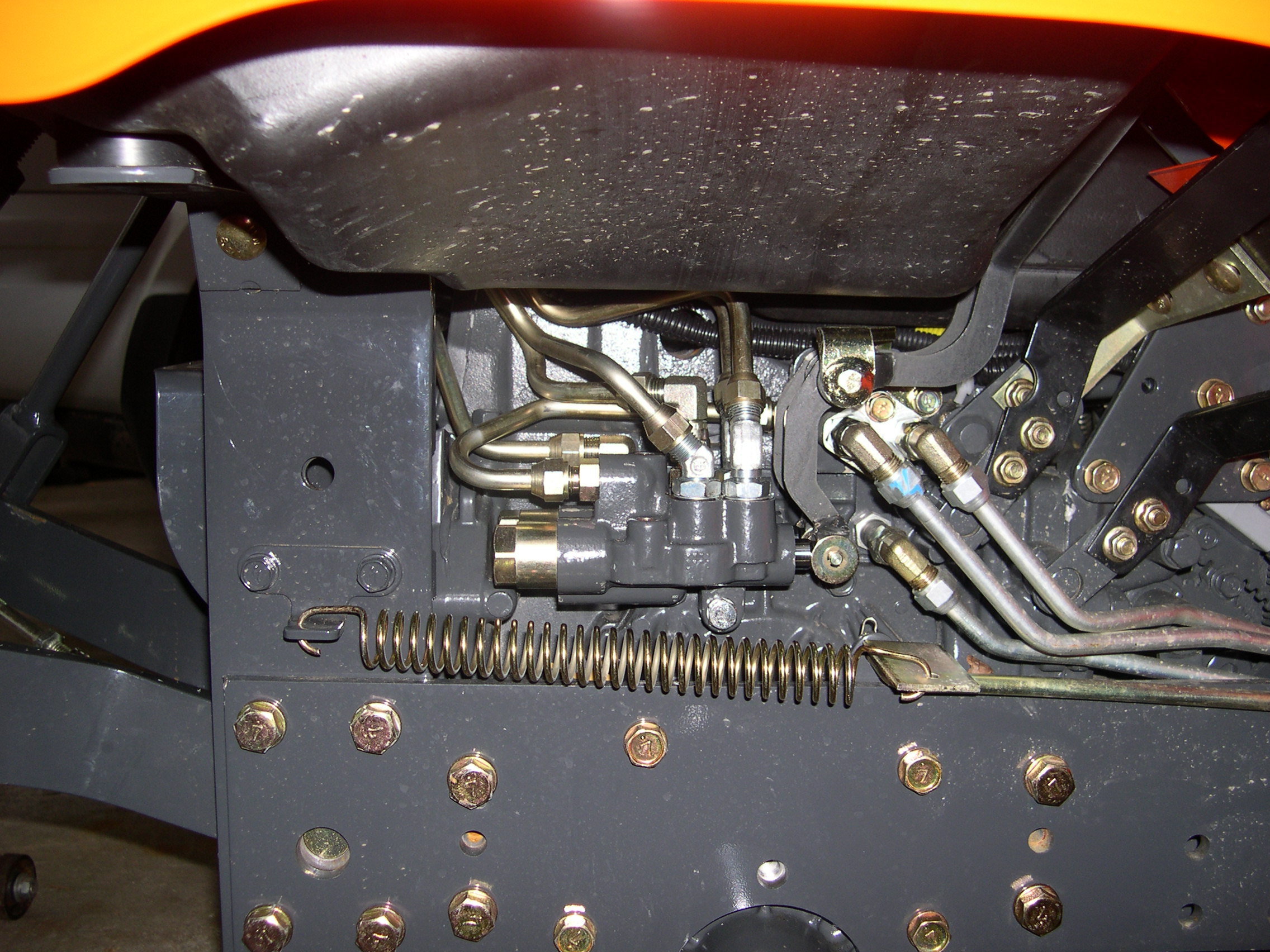

Anyway, after re-reading my posts, I think I can sum it up much easier and that is, based on how the OEM Kubota valve is installed, you could remove the pipe that wraps around the back of the HST and connect your valve(s) in between the two end points for that pipe, then T or pipe the return to tank however you want. Hope any of this is helpful. Good luck.
Yes you can mix open and closed center valves in the same system. Now what is that hydraulic tubiing that runs behind the HST?. I was look'in at that.

Assuming that your tractor is OC and plumbed like most, your FEL valve does have a PB port, and that is what is returning to the run the 3pt hitch. The 3pt is last in line - typically there is a hydraulic connector block with a bypass switch - the switch allows internal running of the 3pt in one position, and runs accessories in the other, where pressure runs out to the accessories, then back to run the 3pt. You will have to re-route the FEL PB line (currently running back to the 3pt block) and run it to your remotes, then run the PB line from your remotes back to the 3pt block. You will have to tee-connect the tank return line from your remotes with the FEL tank return line.
Hope that makes sense.
JayC
YES....Thanks, this is what i'm looking for, but I do not unstand the bypass switch (some sort of a cartridge shuttle valve?). If the fel valve is power beyond..you should be able to run the 3pt at the same time (provided the volume is there). Now you can lock an cyl. with an open center valve by using a poc. (pilot operated check). this is common practice in the auto transport world and yes a plain open center valve (no check) allows a cyl. to "float". the work ports with the spool in the neutral position are open to tank.

terry2shot, are you still looking into how to tap into your BX hydraulics for you remote valves? I ask because I was looking at the installation manual for a Woods BH6000 backhoe that mounts up to a BX and it shows how they install the power beyond loop for the BH into the existing hydraulic block. It seems you could work off those schematics and just put your valve(s) in the loop with a return to tank hook up. Pretty clear pic's. I saved the pdf so if you are interested, I could post it here for your review.
Now, don't ask me why I was looking at how to plumb in a BH :D
