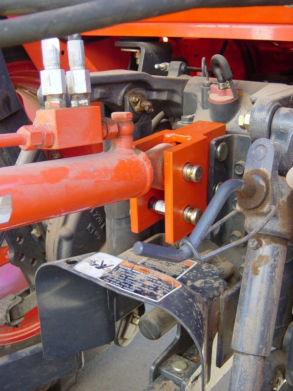

Need some info on hydraulic top link for my L 4060 .i GOT ONE WHIT THE TRACTOR BUT SEEM A BIT SHOT IT 21 INCH CLOSE AND 28 OPEN .Is that ok because yesterday i used my box blade but the link does not go out enough to give me the right angle .Look like i need a other 4 to 6 inch to make it work good .

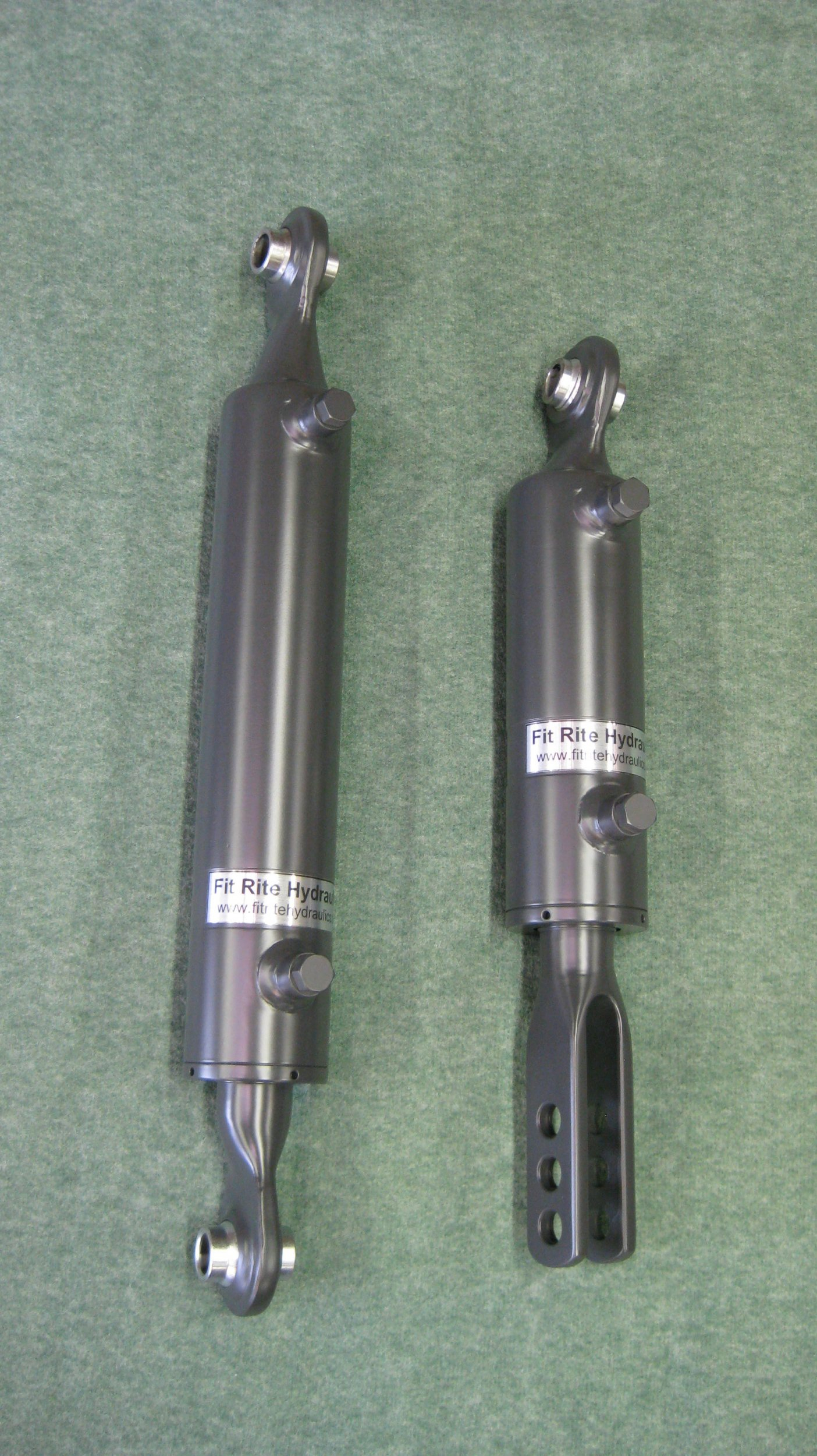

I typically provide a 21"-31" working length for the cat 1 Grand Ls. That seems to work well for most people.

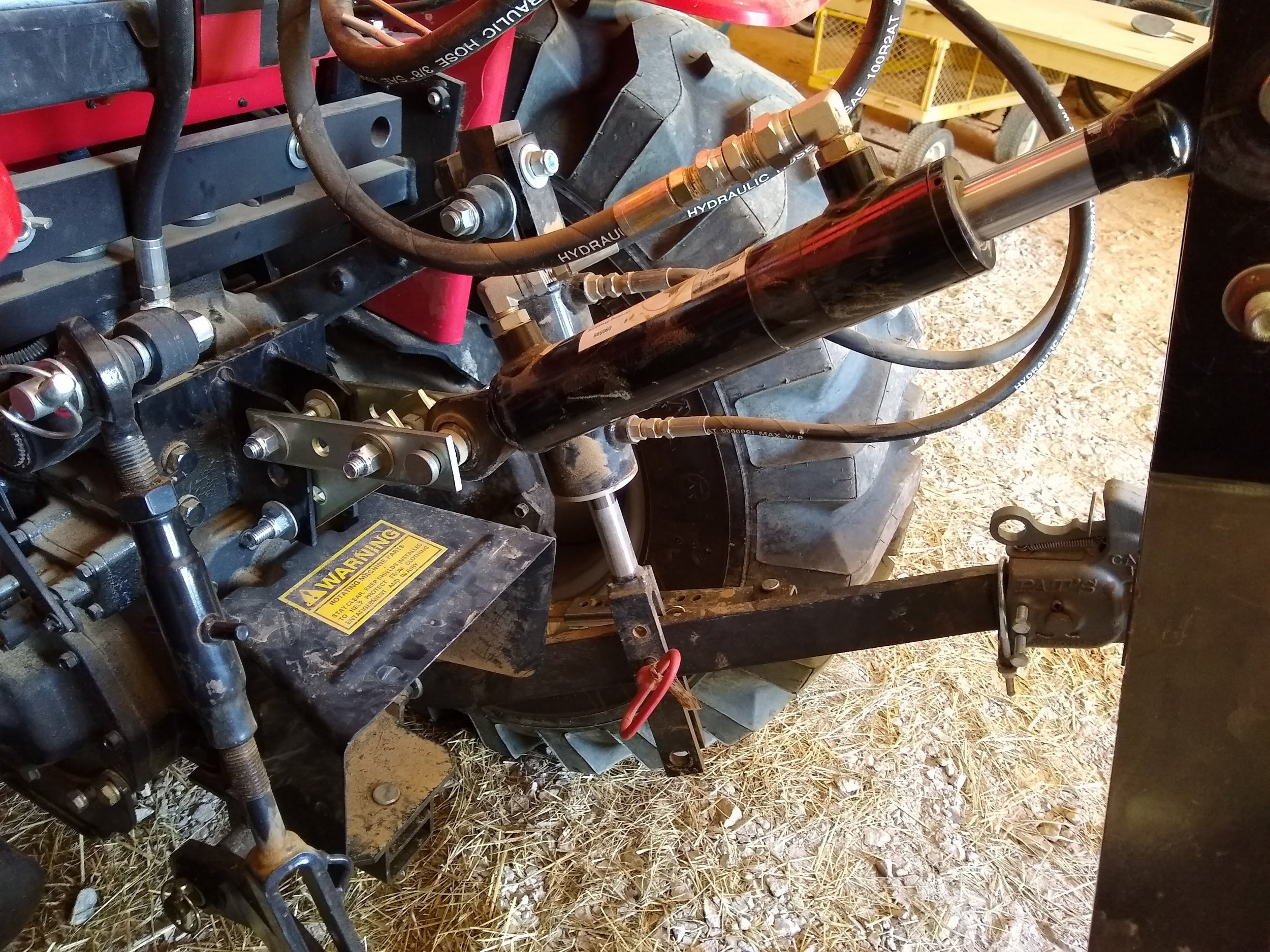

I installed this one last year. I wanted to get one from Brian @MtnViewRanch but needed it sooner. It's a little longer than he recommends but the extra length has come in handy with the land plane and landscape box.
It's also a Cat 2 and I wanted the rapid hook for the implement end. The only modification I had to make was to lightly grind the sleeve in the ball end where it attaches to the tractor. Being Cat 2 it was about 1/8 inch too wide to fit into the Kubota bracket.
I highly recommend it if you need something sooner than what Brian offers.

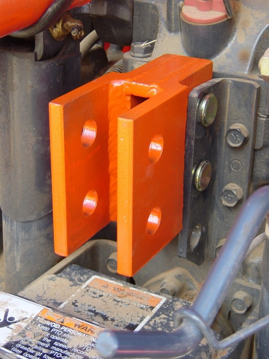

I like that extender and i can weld that easy to make thanks for info

The hydraulic top link I got from Brian( Fit Rite Hydraulics ) extends a couple inches more than the OEM that came with my tractor. It's been a real life saver. It allows me to "fine tune" implements to their max.

Yep your right am going to do it today .I guess if i do it to get 3 to 4 in extra that be ok

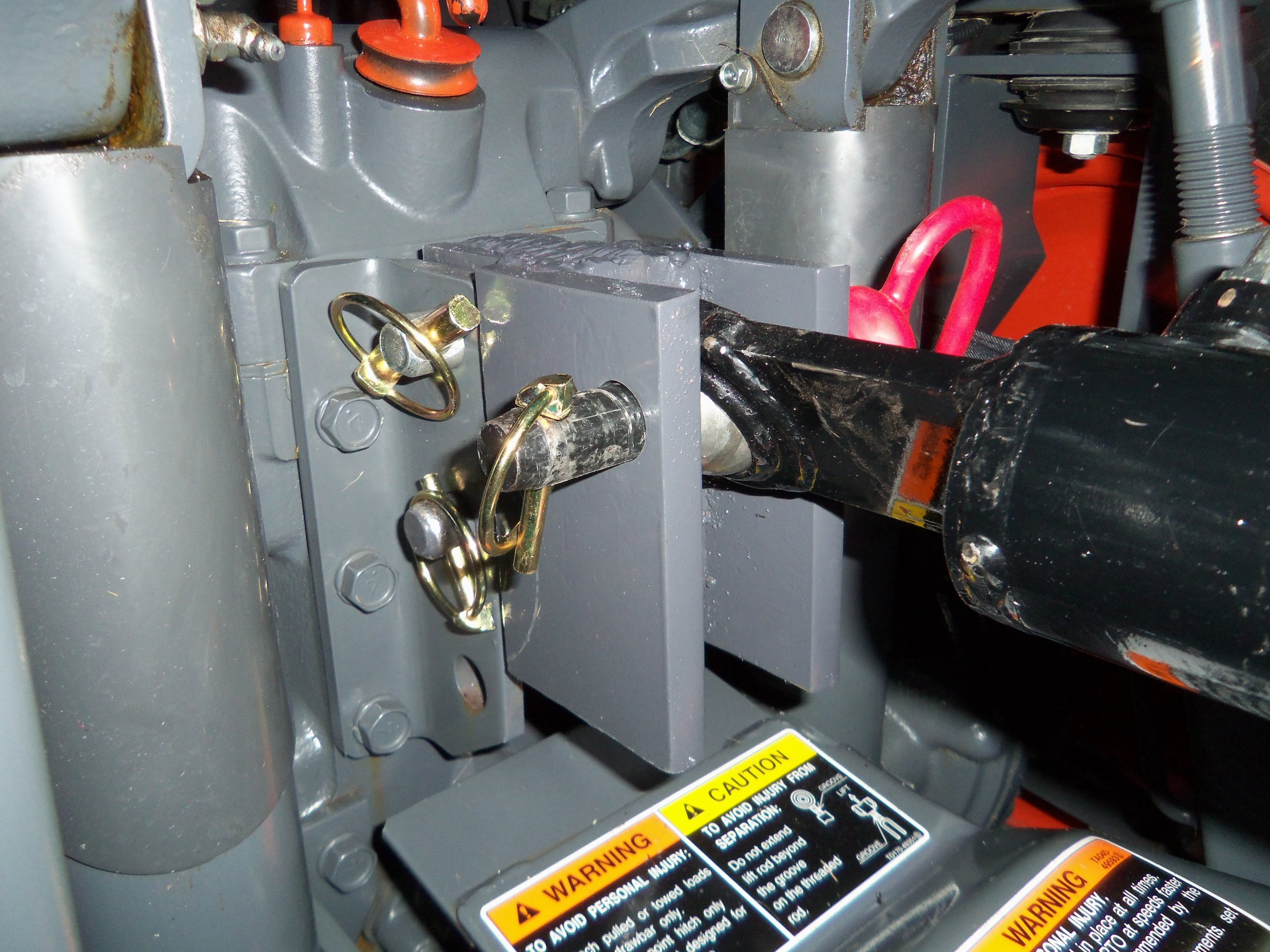

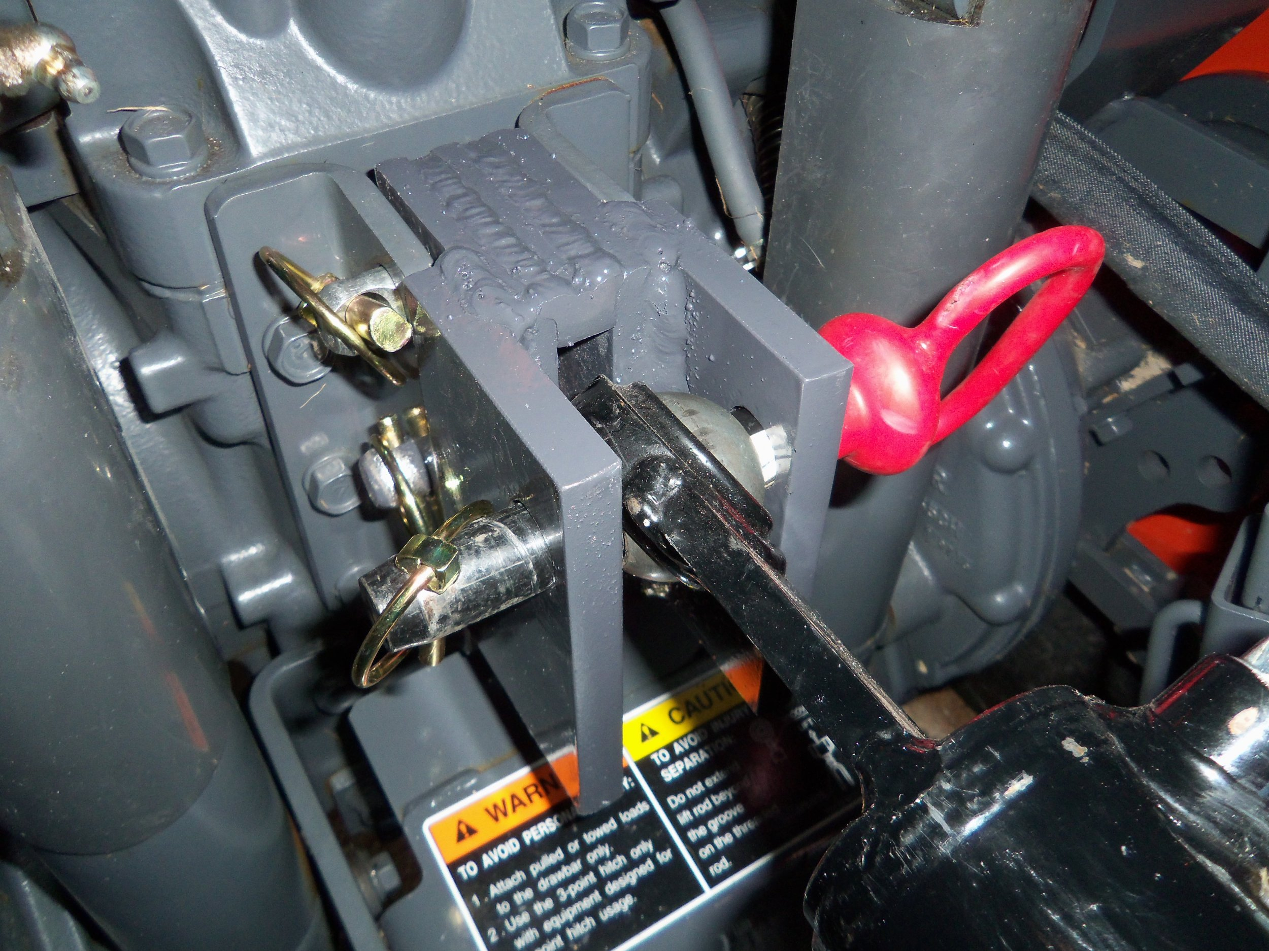

IT done I try it out and it working good now
