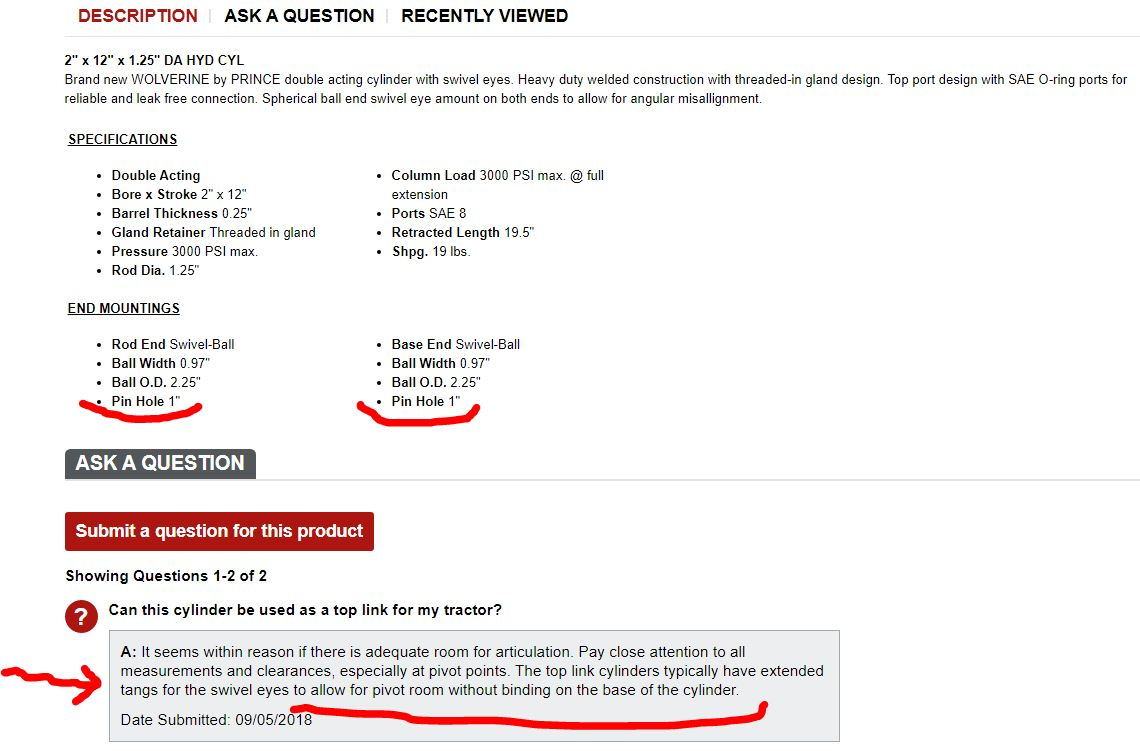

The stroke on that cylinder long 16 inch id be scare to bend that if you push it out to far
   / Top link #22
That cyl has a 1 1/4" rod. I don't think you well bend it, but if you did you would bend more then just the top link.
   / Top link #23
   / Top link #24
Do they make a 12v top link that would plug into the ready-made plugs?
   / Top link #25

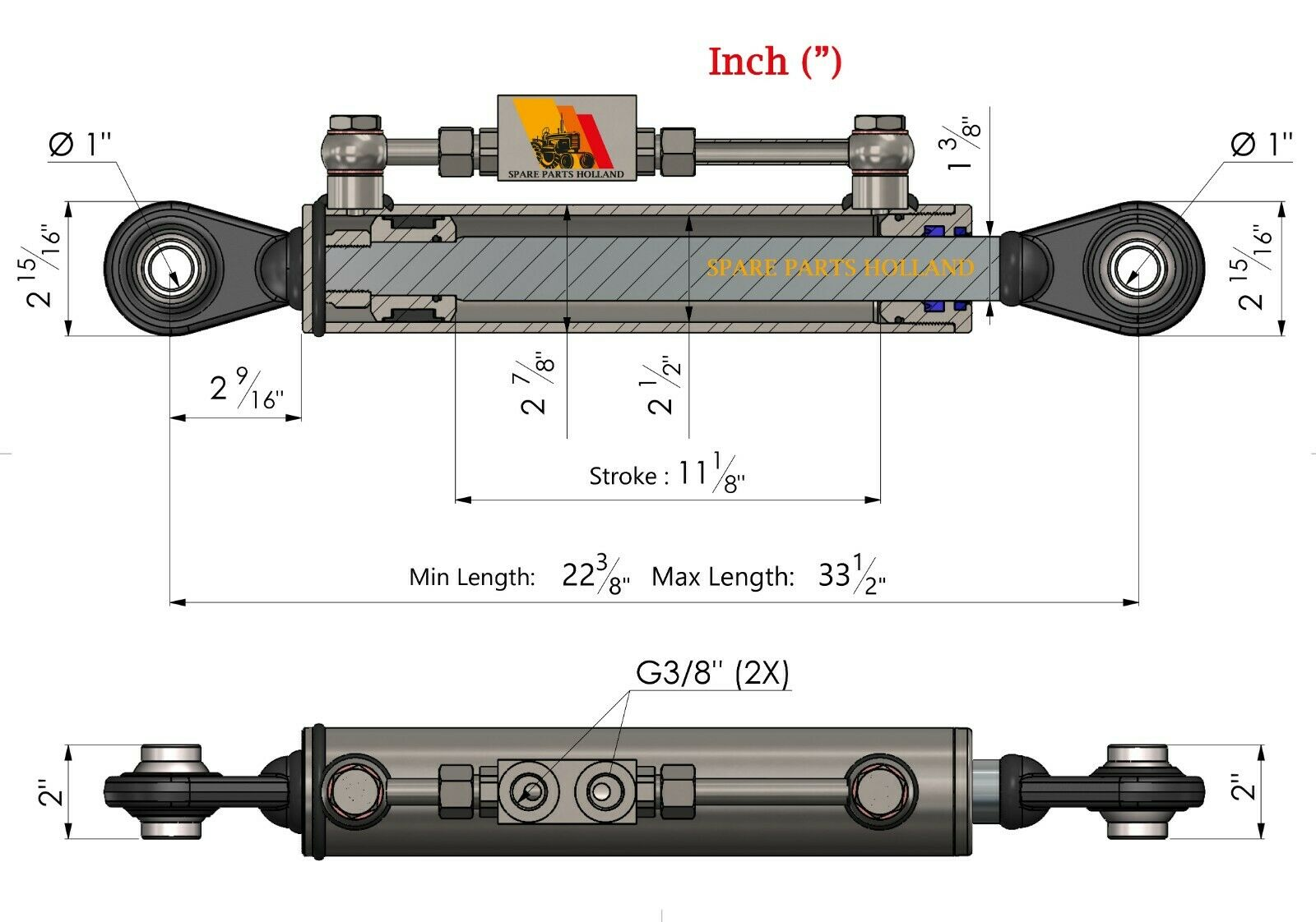

coupman35 keep in mined the top hook up should be on the same center line as the lower link. This cyl would almost get you the 34" and also has the 1 1/4" rod.​
The problem with that one is the hole is not 3/4" and clearance at the base of the cylinder:

So after looking at a few top link this is the one am looking to get
