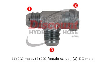

This is the fitting I used to "T" my return from the new spool valve back to the loader valve.
Don't worry about the "confusing" questions that's how we all learn.
I found that Surplus center has such good prices on hose assemblies (all with JIC females) that the additional cost of the JIC to ORB adapters the hoses were still cheaper than the Hydro shop. As hard as we may try to order everything just right there is always some fitting we missed. I ended up with a fairly large selection of extra fittings, hose protection, and other parts. I'll eventually use them on other projects.
If you were closer to me I'd give you a hand.
I know you're in a hurry to clear those property lines.....just take your time with the build double check and make sure everything's tight. I gets messy once you have fluid in the hoses and have to reconfigure something.
Don't for get to lube the SAE/ORB O'rings with hydro fluid before assembly.
Even the JIC fittings require a few drops of hydro fluid to provide lube while torquing them.
Did you order a set of Hydro wrenches? I'd been SOL without my set.
DON"T FORGET PICTURES AND A WRITE UP when you're done.

I ordered that exact same fitting! I also found the same thing about the hoses from surplus center and purchasing additional fittings. I did not know to add a drop of hydraulic fluid to the threads so thanks for pointing that out. Have you had any leaks in your system? I will triple check to make sure all my fittings are tight before I fire it up.

Did you have to 'bleed out' your lines when you first connected them or does the system self bleed?
I haven't ordered a set of wrenches. I looked into them but I'm embarrassed to say that I really don't know what hydraulic wrenches are? How are they different from regular wrenches?

the only leak I had was my return fitting that I had forgotten to tighten with a wrench. Just make sure you don't gorilla torque the fittings. they just need to be tight.

No need to bleed the system, it'll bleed itself as you use it. Just be gentle at first until the system fills.
Hydraulic wrenches are thinner to fit in tighter places and have offsets of 30 and 60 degrees so you can tighten where a normal wrench won't. I couldn't have tightened many of my fittings without them.
