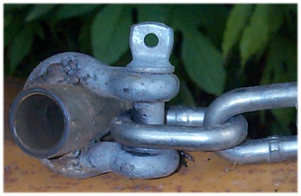

I posted a picture of the chain attachment the last time around, I don't know where the tread is but here is the picture again. I put my chain on after I bent the third arm for the second time.

Kent.....thanks for the email and pic.......could you send it here for all to share.......I tried to reply there but for some reason it wouldnt go through.........My arms have two bolts at the bottom.....will look at it tomorrow and see if I take out one and use your fix with chains to the rear.....thanks Bud..........
Paul.......great idea.......am gonna go down to the tractor dealer tomorrow to see what he possibly has in mind......gotta be some way to rig this thing.......thanks..........Dennis

I have ask this before when we have discussed the chain replacing the third arm. I have never gotten a answer. Has anyone ever know anyone that was injured by using a chain? I don't mean someones third cousins, fourth niece heard tell of someone. But has anyone here ever actually know of anyone being hurt doing this?
   / Toplink vs Chain on bushhog attachment #19
Not me Jerry, not one soul. I do know a few people you have got hurt by falling out of bed /forums/images/graemlins/wink.gif
   / Toplink vs Chain on bushhog attachment #20
I've never heard of anyone being hurt by the bushhog flipping up and hitting them from behind because they use a chain instead of a top link. I must admist that I am biased, because for the most part, I use a chain instead of a top link. It seems that my bushhogs are fairly heavy pieces of equipment, and even though they carry alot of power, they are really going to have to hit something really hard, really strangely to make them bounce up more than 90 degrees. I would also think that the PTO shaft, even with it's U-joints, would also discourage the bushhog from trying to sit in my lap.
On a related note, both of my Howse bushhogs have fairly long slots on them where the top link fits in. I had an older economy cutter (can't remember the name) on another Yanmar tractor that had an A-frame on the front that flexed at the bottom pins and there was a bar with about 12-18" of chain on the end of it that ran from the top link hole to the tail wheel of the bushhog, giving quite a bit of flexibility.
