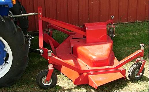

When I purchased my finish mower 13+ years ago it was rigid, but only because the dealer did not know what he was doing when he setup the mower. Once I burst a tire due to too much down pressure I realized that the geometry would work better if a couple of the arms could be adjusted. When I loosed those bolts I finally realized that the mfg deisgned the unit properly and it had lots of travel but the dealer in an effort to tighten all the bolts before delivery tightened bolts that were supposed to be loose to allow the top of the A frame to rotate forwards and backwards, thus reducing the stress on tires.

There is a lot of trickiness in hooking up these 3ph mowers. That is why we keep having these same problems discussed over the years. Plus, some people might buy older or damaged or wrong-sized mowers, which makes the hook-up even trickier.
Spiker's situation keeps confusing me. I keep thinking: why should a 3ph finish mower not fit and work properly with the tractor's toplink? I mean, no one would buy that brand of mower if it wouldn't let the four wheels stay on the ground over normal terrain. And if that were the only mower I had, I too would use the chain link. However, just wonder if Spiker's mower situation isn't caused by one or more of the following:
1. Something is installed wrong, or maladjusted, or just plain missing on the mower. Dave is suggesting this type of scenario.
2. The PTO shaft is the wrong length. Sometimes they have to be shortened (usually) or perhaps even lengthened (if bought used) to get the fit geometry right.
3. The toplink on the tractor is too short. Maybe it's not the original toplink, e.g.
Going off on a different tangent, Spiker's post makes me wonder what the difference is between using a chain for a toplink vs. using nothing at all. I suppose a chain would limit the ability of the back of the mower to jackknife too far downward. But when would that be a practical problem? (Backing over a cliff edge perhaps.)

I'll post a picture of mine, on the attached. It is all factory stuff though on the low end scale. it is an import tractor which works great, (JINMA) and if I had to do it over again I wouldn't get the import mower, though the tiller works great. pto shaft length is good, and does not bind up or down when lifted using the top link or when lowered and over the old poor land scalping I have. I use it to maintain "Farm Grass" and it does work well and will be getting my brush cutter later this week I hope (international brand) nice heavy unit...
my biggest problem is i'm mowing old fields that have dead furrows in them... and have to cut across them many times. that is how I messed up one wheel already, and since I've stopped using the top link when mowing (use it for transporting only) I haven't done much more than scarf up a bit of ground, I lift the front wheels up when traversing across the dead furrows and the high/lows which works well. (Not 100% sure they are dead furrows could be something else but really looks like they are DF)
Now perhaps you can't see the set up in the photo but it doesn't have any adjustment to it even if the lift arms were left loose. I've got other photos at the following site.
Mark M photos of the place
