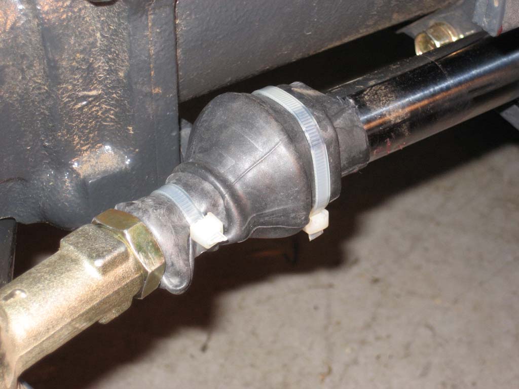

Follow up:
I unthreaded the tie rod adjustment from the outer ball joint after measuring the distance from the lock nut to the edge of the machined and threaded part plus I counted the turns to unthread the tie rod.
I had an extra 26" mountain bike inner tube lying around and it is a nice tight fit over the large end of the existing tie rod boot. I cleaned everything up, worked some good synthetic CV joint grease into the joint, and used the inner tube to create a second boot over the original torn one.
Pics of finished product are attached.
Thanks to all for the hints and suggestions. Saved me $47 bucks for now and I bet this tie rod joint will go many more hours before needed replacement.

Good lookin' job, those inner tubes are a lot tougher material than the original boots, and you got an almost endless supply unless you're like me and can't remember where you put the rest of the tube for safe keeping the next time you need it.:D
   / Torn BX24 tie rod boot = $47? #18
Here is a point of interest...
The white tie wraps you used will not last long. UV and all that.
Black ones, (like I use in the telephone business, UV resistant) are much more outdoorsy is you know what I mean.
I was just thinking the same thing. Those zip ties are nice but they don't last long when exposed to the sun it seems.
I may have to do this trick to mine before I tear a boot.
