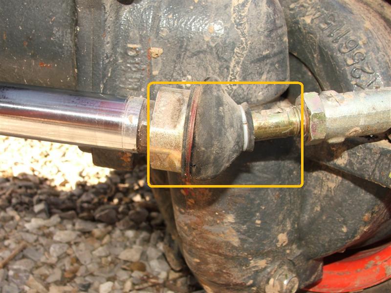

Milkman - a teflon (apparently) seal / knuckle at what i believe is the tie rod on my BX200 has broken, resulting in some play on my left front wheel. Is that joined to the tie rod? or is it the tie rod? Any advice on how to fix? It looks exactly like the photo you posted. I had to remove the rubber boot rings (easy) to see the damage.
If this is the pic you are referring to, the part in the orange square is the part that comes with the new boot. It screws off the power steering cylinder and out of the tie rod, in the parts book, it's called 060 K2561-01630 JOINT AXIAL BALL
Yes - that's the photo. And sounds like an easy fix.
Thanks Milkman. I appreciate your advice !
