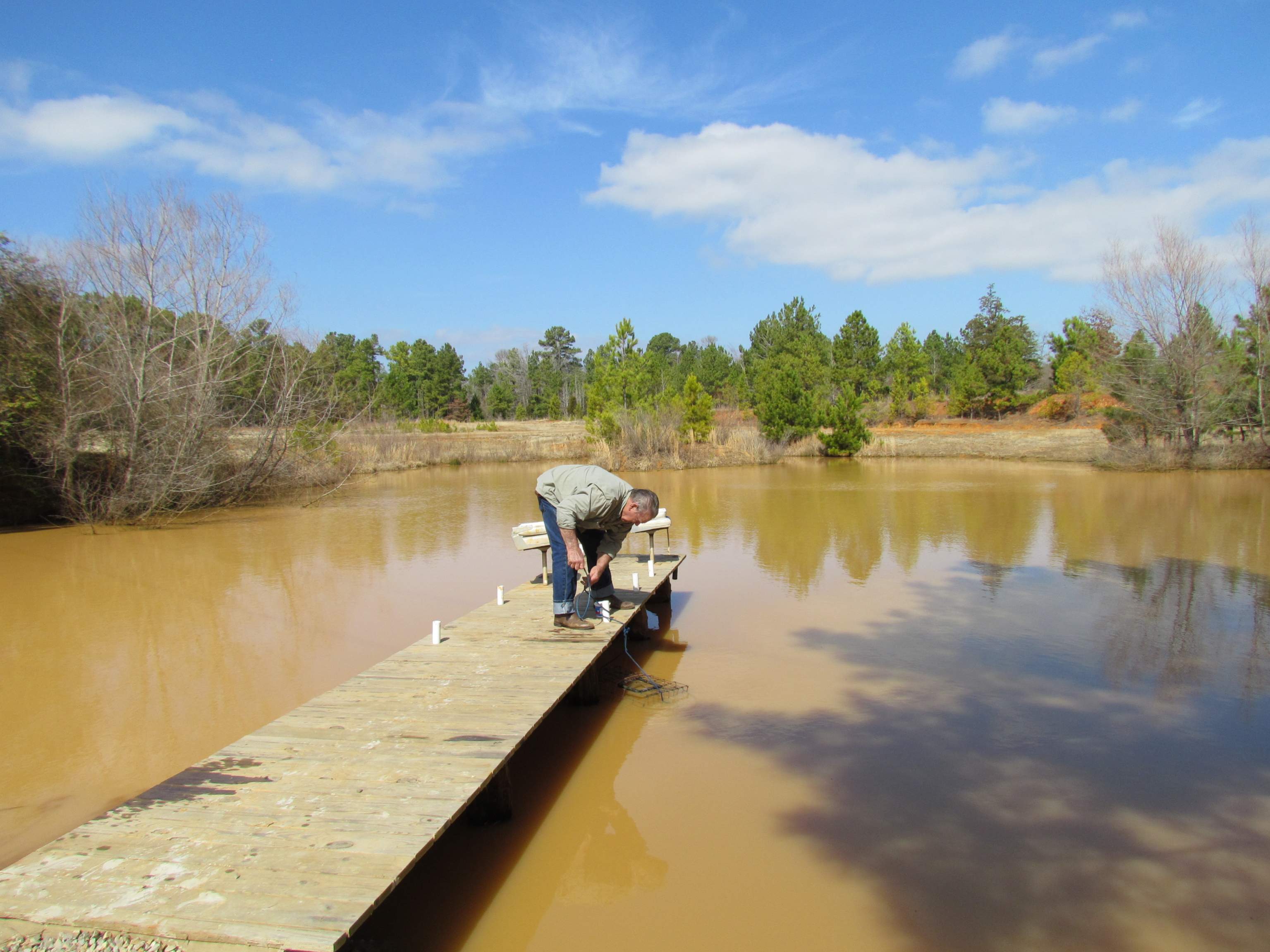

There are a few trees around it, but no, there isn't very much shade around it at all. It is always brown in color, and I've come to accept that as being normal. The color of the water doesn't affect the fish, or how they tasted, so I just left it as it is.
Eddie

Go for it. Pump it down and clean out the silt while making deep pockets.
hugs, Brandi
