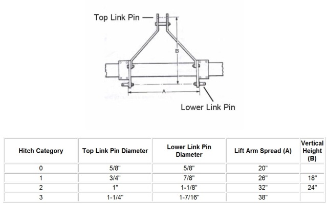

The 5545 has "Category 1 and 2 with telescopic stabilizers." I have no clue as to what Category 1 and 2 mean.
--Bill
' Usually ' the ball ends rotate with Cat 1 and Cat 2 size holes, depending on how you rotate them ...... [ heavy on the usually... :) ]
   / Total Newbie with Mahindra Questions #22
James--
--Bill
Cat1 and Cat 2 relate to the size and dimensions of and between the hitch members. It's on the web with pictures and dimensions so you know exactly. It determines what implements you can buy and hitch up. The bigger the tractor the bigger the hitch you can run and bigger more badass implements you can pull behind it.http://https://en.wikipedia.org/wiki/Three-point_hitch
   / Total Newbie with Mahindra Questions #23
Since your proposed tractor purchase has passed into the realm separating CUT (Compact Utility Tractor)from UT (Utility tractor) you will have Cat 1 and Cat 2 capability. As tractors get larger, the implements get larger and the ball end, draft links, top links and all associated hardware to pull those larger implements gets larger. They start at Cat 0, Cat 1 (the most common for many SCUTS and all CUTS) Cat 2 Usually starts around the 50 horsepower range, Cat 3, Cat 4 etc for really large tractors.

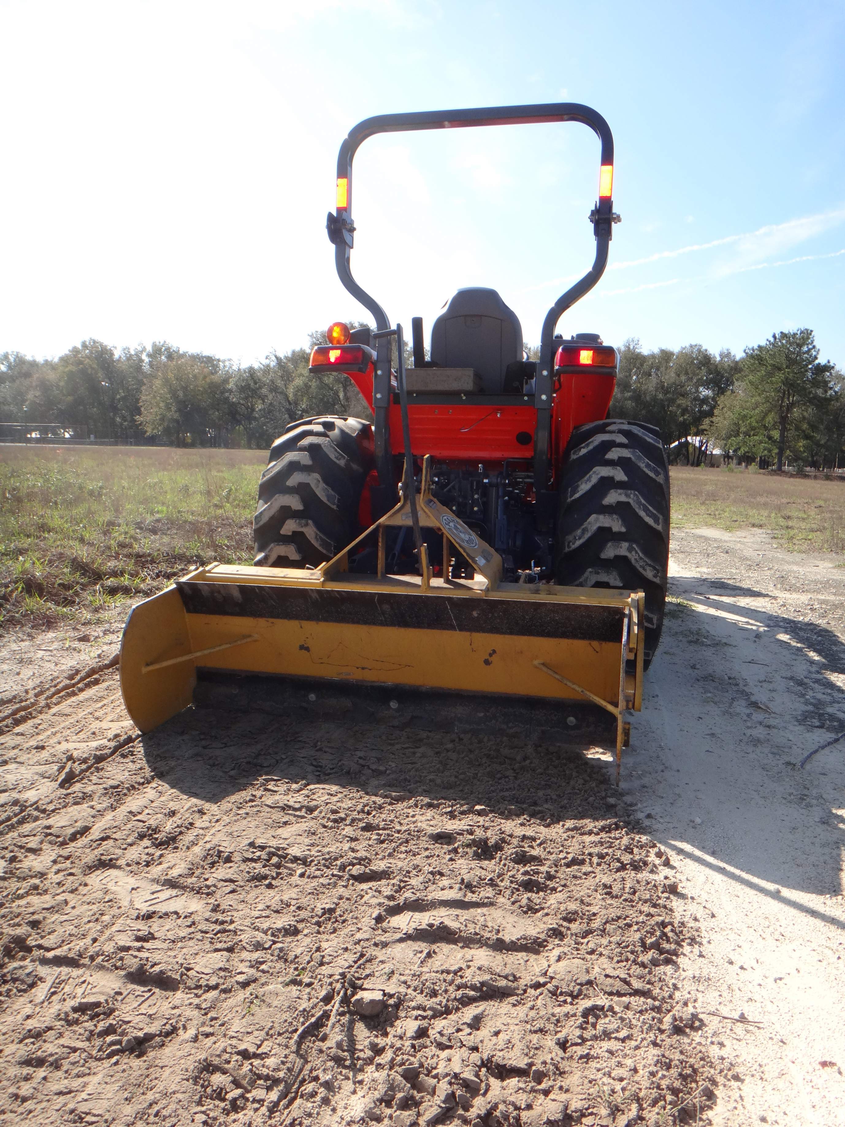

I DO need to work on a "road." Currently, there is a logging road off the gravel county through the forest leading to my property. The logging road path is 1.1 miles long before you get to our place. It is all level except for about 250 feet of rather steep ledge rock which gets washed out in heavy rains. I'll use the tractor to fill in after such rains. I want to improve the rest, including the further half mile stretching the length of our property. How will a box blade work for this type of operation--excluding the steep, ledge rock portion--in ground that may be somewhat rocky? Does a box blade require additional hydraulics?

Box blades do not "require" hydraulics, but a hydraulic top link and/or side link can make operation faster and easier for you as an operator. Otherwise you get to jump off and climb back on your tractor after making minute adjustments to the top link to adjust the attack angle and maybe the side link if you are trying to match terrain or build a crown in the road. It is just a matter of convenience and speed. Professionals that use a box blade every day will nearly always have some hydraulics. By the way here on TBN we often refer to that as TNT or "Top aNd Tilt" Meaning both hydraulic top link and hydraulic side lift link.

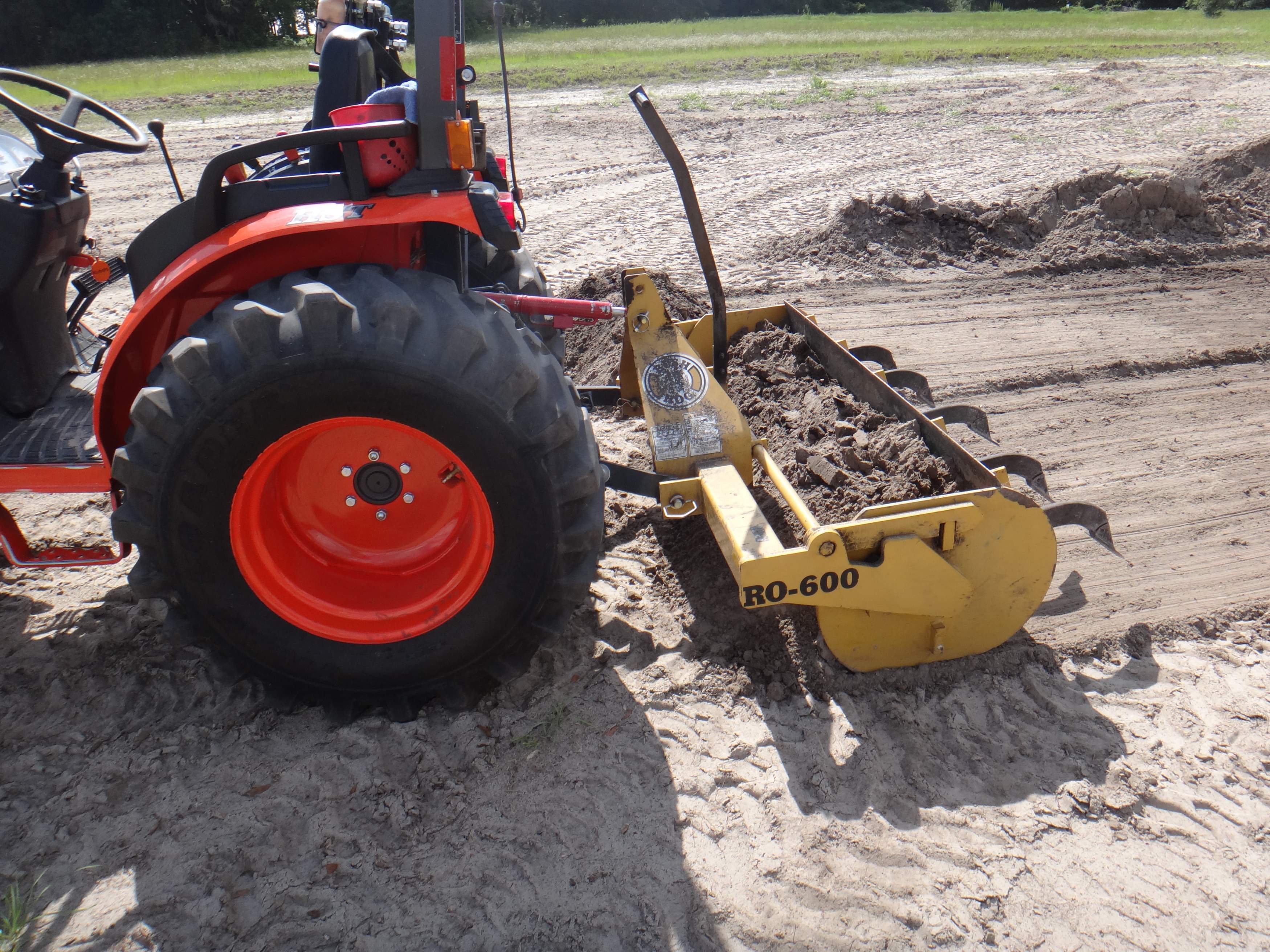

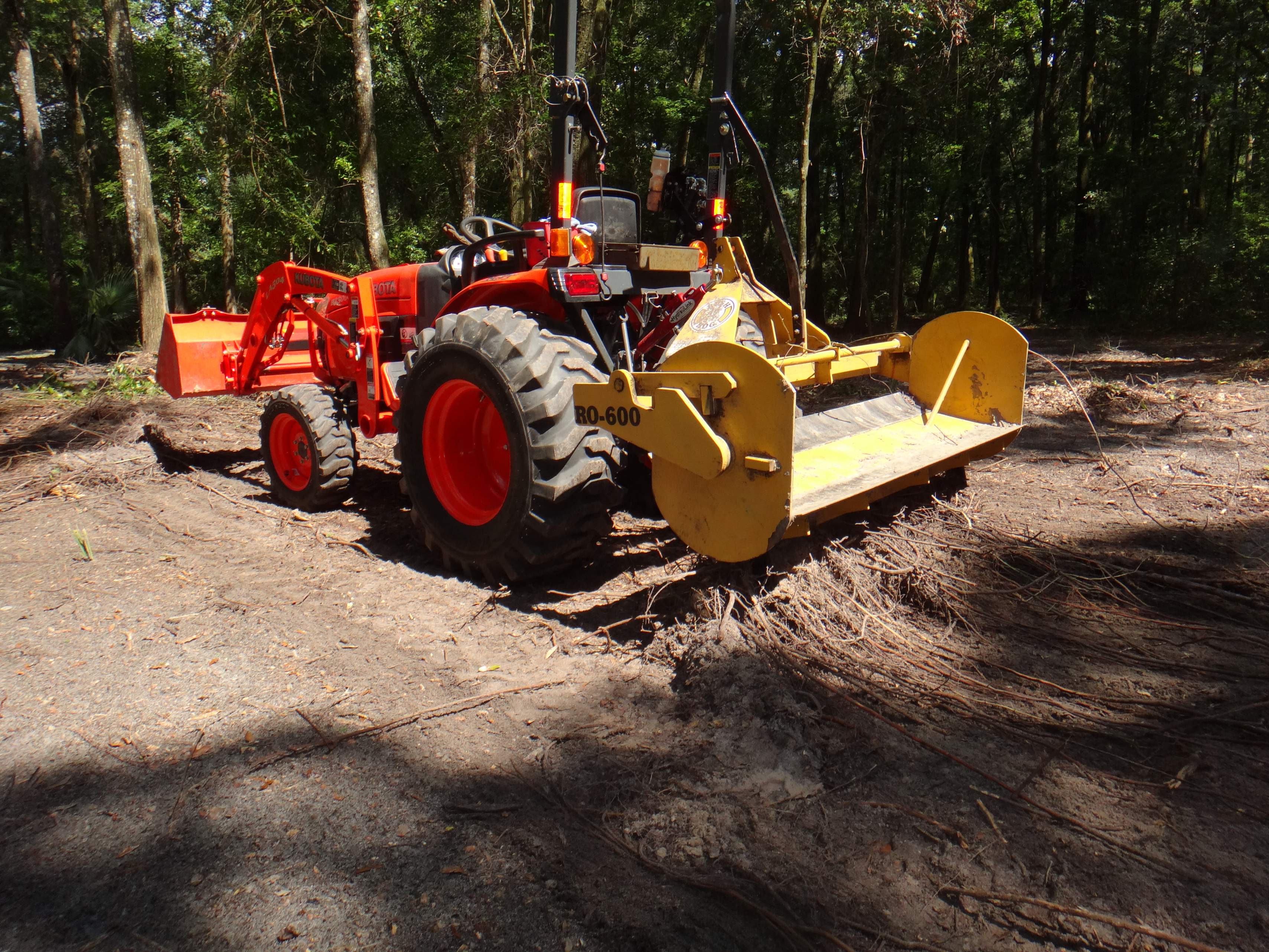

I DO need to work on a "road." It is all level except for about 250 feet of rather steep ledge rock which gets washed out in heavy rains. How will a box blade work for this type of operation--excluding the steep, ledge rock portion--in ground that may be somewhat rocky?
A Box Blade is for soil. Gravel is OK too. Actual rock-rock, which needs to be chipped out, is too much, you will only beat up the implement and/or snap off the scarifier points.
You probably need a bulldozer.
There is a particular sub-type of Box Blade, called a Rollover Box Blade, which does not require additional tractor hydraulics and is somewhat less finicky in operation than a standard Box Blade. I use my Bush Hog (brand) Rollover Box Blade in conjunction with a Hydraulink (brand) Top Link. Key effectiveness metric remains weight per unit of width. My 60" ROBB weighs 620 pounds.
