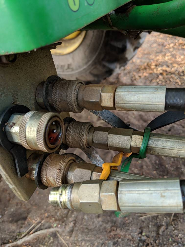

I am working out the connections now, without a power beyond kit connecting it seems to be... Interesting. I am thinking I will try to connect it to the bucket hydraulics somehow. I believe each port on my 790 has a return, since it don't see any other return lines. The only question then is how to I get the pressure side to flow without actually pushing in a direction on the bucket controls... Fun times!
   / Total noob here trying to understand my tractor
#37

Best be checking with the dealer on proper way to do it. Wrong procedures can result in broken parts on the first try.

I actually have a call in to John Deere last night they are looking into the parts for a power beyond for me. I know that's what I want to do long term I was just wondering if maybe there was a way to get it going now in the interim. Let's see what the dealer gets back to me with. Anybody have an idea of what a power beyond kit costs?
