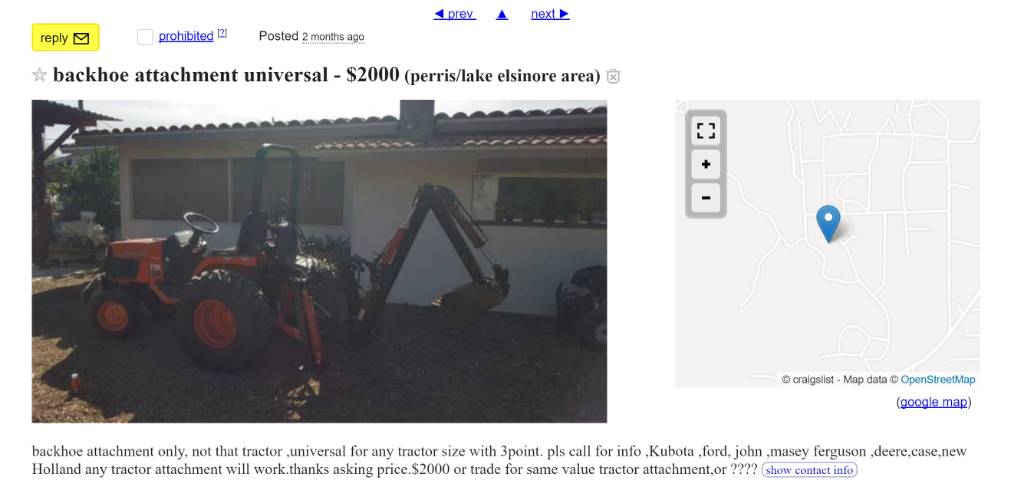

Post pictures of the hoe. If the backhoe doesn't have a pump hanging from it and a reservoir full of oil, then it is set up to use the tractor hydraulics. For that you'll either need a power beyond kit or create your own.
   / Total noob here trying to understand my tractor #20
Can't tell anything from that picture other than it looks home made.
