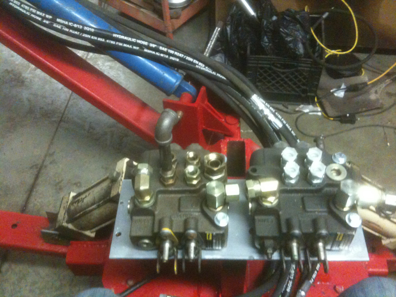

When it comes to Hydraulics I am lost everybody keeps talking about a relief valve where would that be on the control valve
   / Towable backhoe #67
12abarber12
In your pix, the rt body has a screw and nut device to the left of the left hose. That should be the relief and screwing in will increase pressure and out lessen it.
