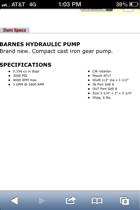

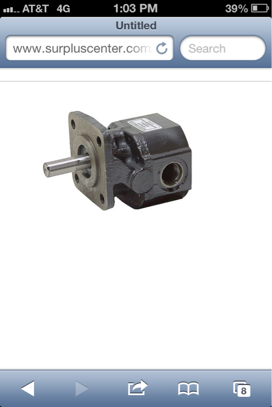

You guys are recommending me to use a single stage pump would this work

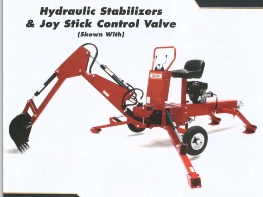

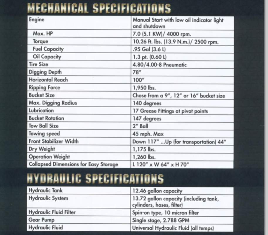

These are the specs on mine. They may be helpful to see if we are talking apples and apples.
My pump is 2.788gpm and motor is 7hp at 4000rpm but it does not seem to increase digging power over 3/4 throttle.
The other variable is the face area of the piston in the cylinders.
A contractor did some digging in the backyard with a tractor mounted hoe that is about 1/2 again as large as my Dirt Master. He commented on hard the dirt was. It does not present any problem to my toy. I have had trouble with tree roots and others have commented it does not work well if you have a lot of rocks. For that reason it would be nice to have more pressure but I have no idea how much more the hoe would take without busting it up. Maybe the right thing to do is to put a beefier cylinder on the curl.
I opted for the joysticks with the hydraulic operated front stabilizers. I could live without the joysticks but you would have to pry the hydraulic stablizers out of my cold dead hands.
I have a bx2200 that I use with it. I am in the process of adding a ball hitch to the back of my box blade so I can back the ball under the backhoe hitch and move it without getting off the tractor. Together the FEL boxblade and hoe are good combo.
I added an electronic hour meter to make it easier to keep track of when it needs to be greased. If one used it all day you could just grease it when you start and at lunch. But I use it an hour here and an hour there. It was too easy to go longer.
