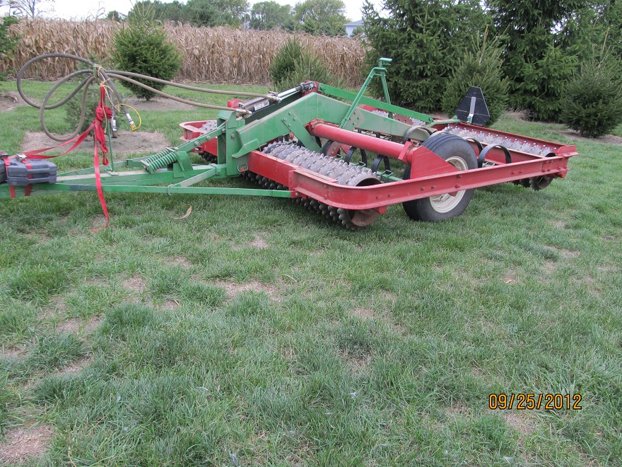

Here's a photo of the pull type that I use. It's a bit different in that it is a "cultimulcher" with cultivators in the middle of two packers. Works like a charm. In this pic it's actually hooked to my truck for towing somewhere. The two weights (55 lb each) strapped to the front are to increase tongue weight so it doesn't fishtail while towing. It's 8 ft wide.
These are more expensive than a basic packer but I needed the extra weight (2500-3000lb) and needed the leveling aspect of the tines. It gets pulled with an MX5100 Kubota 4wd with weights up front. If I plan on cultivating deep, which is rare, I use a bigger tractor.
