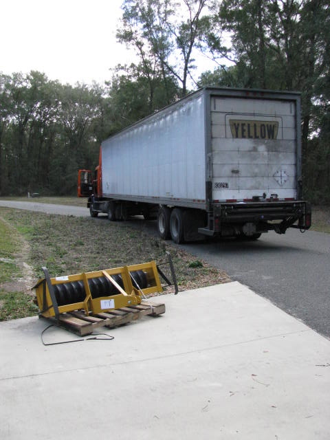

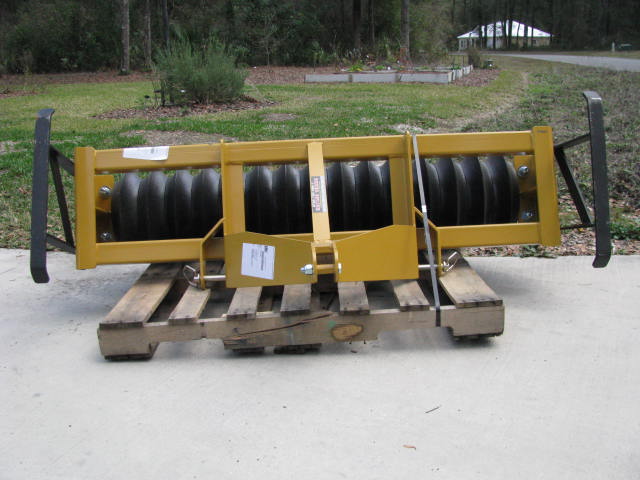

I did attend the Sunbelt Ag. Expo in October. I sought all Cultipackers and Rollers in the show. Of the Cultipackers those from Brillion and Everything Attachements were interesting.
Brillion displayed huge Cultipackers, which Brillion chooses to market as "Pulverizers", for ag tractors. However, the salesman did discuss Brillion's compact tractor PP models in 5'-6'-7'-8' widths, in 3-Pt. or pull type. He put a Brillion catalog in my hand. The Brillion PP model, five feet wide, cost $2000-$2200 from a Florida dealer, depending on roller wheels selected.
Everything Attachments displayed ETA 7' width / 3-Pt. Cultipacker. Looked solid. The 5' width, delivered to Florida, is $1400 / residential delivery.
The 5' Brillion and 5' ETA equipments each weigh approximately 700 pounds. (Actual weight shown on freight manifest 722 pounds including pallet.)
After mulling over thread comments for three months I decided I wanted a 5' X 3-Pt. Lift Cultipacker from Everything Attachments. A Brillion, the "classic" brand in Cultipackers, would have been nice but $600-800 + Florida Sales Tax premium? For rolling dirt? Would dirt appreciate the difference?
Yellow Freight delivered 5' ETA Cultipacker today. I told the driver I had hoped Santa would bring the Cultipacker at Christmas.... but better late than never. He told me Santa Claus brought him a shining new Harley-Davidson for Christmas; SO THERE, CULTIPACKER MAN.
Another post after I roll around the world.

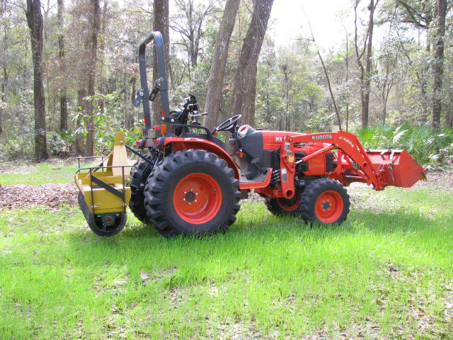

A few pictures from today, February 16, 2013.

If the ground is soft, say tilled or whatever, a 3-pt packer will often leave tire tracks and tire impressions showing when done packing. With a pull-type packer you can see the bar marks from the tires but almost never the settled-in tire impressions. In other words, the pull type does a smoother job. I believe it's the weight transfer issue. Most often I'll use a pull type if there are not many obstacles to dodge and weave around.
I have finished reading two informative tractor books, both about Harry Ferguson, the Anglo-Irishman who invented the 3-Pt. Hitch, (patented February 1926) Draft Control, Position Control and many implements:
Harry Ferguson, Inventor & Pioneer by Colin Fraser
The Ferguson Tractor Story by Stuart Gibbard
From Gibbard: "The three-point linkage both pulled and carried the implement in work, transferring its weight onto the tractor's rear wheels. This meant Ferguson could build a lighter, more economical and cheaper machine, making his tractor more maneuverable and more versatile".
"Another advantage of the Ferguson system was that the line of pull of the implement at its working depth extended through the converging links of the three-point hitch to a theroretical point just behind the tractor's front axle. This was known as the 'virtual hitch point' and meant that the natural foreces affecting the implement in work were converted into a strong forward and downward thrust that held the tractor's front wheels down".
This explains why pulled Cultipackers do a marginally smoother job than 3-Pt. lift Cultipackers.
More weight on the rollers.
No tractor traction issues pulling a Cultipacker. The Cultipacker is just iron wheels, rolling.
