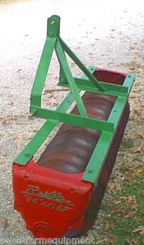

You likely won't see any floating hitch anything. Best bet is to look at the website and learn how to make a connecting link yourself. Buy a standard packer and roll your own. Better bet is to buy a pull-type packer and find a picture of that pull type with a 3-pt hitch welded on to it. It's on the TBN somewhere and you can have the best of both.

This is not exactly the photo I wanted but shows how to add a 3 pt hitch to an older packer. In this photo the front hitch had been removed but an earlier photo I saw had the front tongue left on. You could shorten the tongue or make it hingable or detachable and you then have a way to transport the packer and yet use it as a pull-type when you get where you are going.
That is one of our Brillion's that we have added a three point hitch to. We do leave the factory pull hitch on, if the customer requests. The Combo hitch gives you both ways to pull a cultipacker. Ken Sweet
